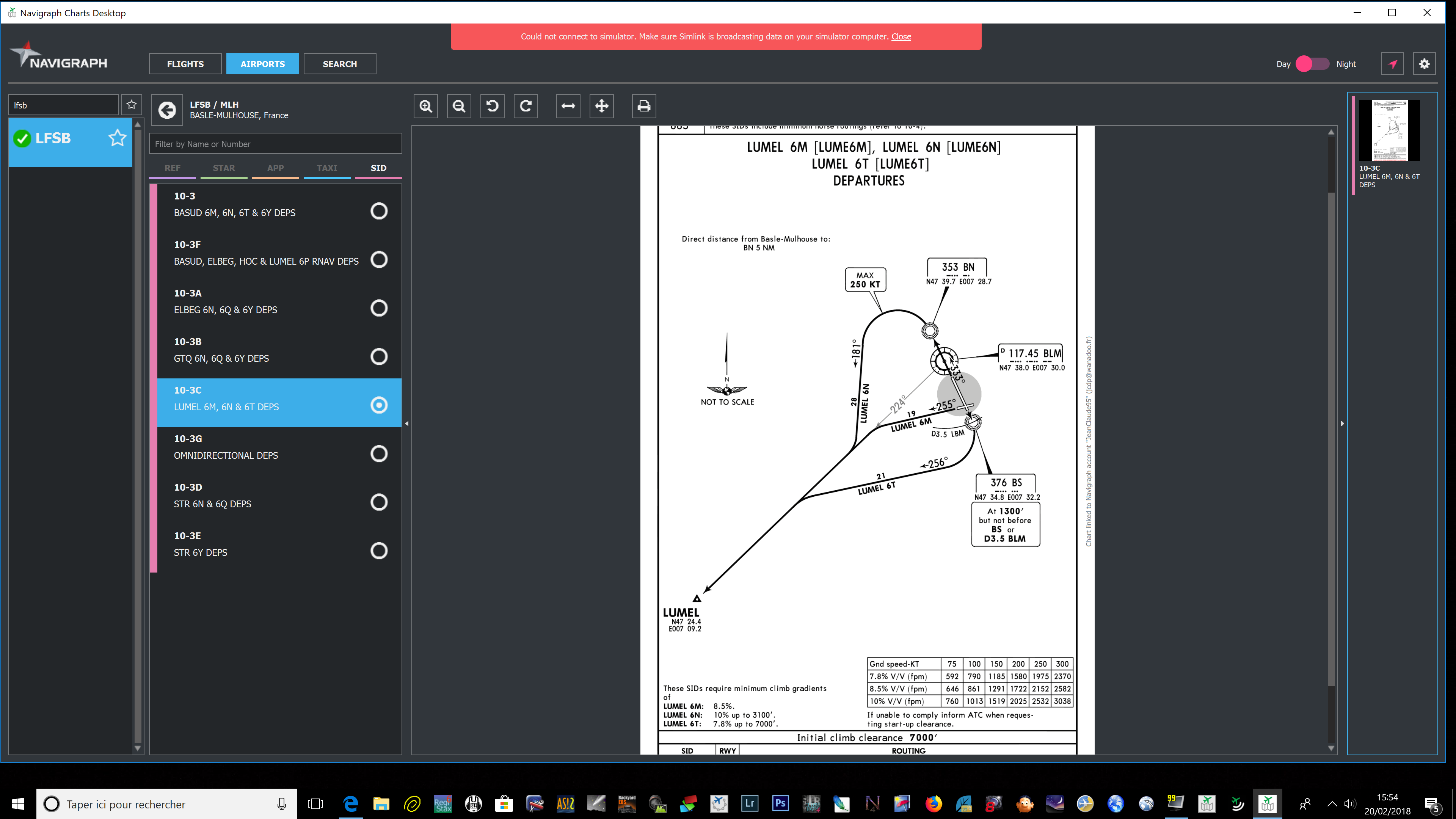

Peter092 wrote:
Hello
The A330 is a very nice plane that gives me satisfaction.
But two problems:
1 / impossible to remove the discontinuity located after the airport of departure. Obligation of an SID.
NB: In the V2, it was possible and interesting to make "takeoff-landing loops"
2 / IMPORTANT : the A330 cannot follow the LNAV and VNAV parameters of the MCDU. As a result, the A330 loses AUTO-PILOT, speed, altitude, etc.
Here is a 7 minute video to show you the problems. Here : https://drive.google.com/file/d/107aXLK … sp=sharing
Flight LFSB (Basel-Mulhouse) - LFPO
RWY 33
SID: LUME6N
AIRAC: 1801 - January 2018.
Thank you for your attention. Best regards.
Peter (in French)
So.. that was LFSB 33 LIMEN6 departure. I will check.
1. DISCO just try to show you what you cant flight this path. Your task is not "remove" it, but prepare good flight plan.
2. As I see, there is no SPD constrains for this SID. So, only way - set speed in selected mode for this kind of SID during departure.
Thanks for your info and video, so detailed.
The SID is LUME6N
See picture for contraint

Peter092 wrote:
Hello
But two problems:
RWY 33
SID: LUME6N
Peter (in French)
Did the same flight, yes SID is needed (LUME6N) otherwise no problems with speed or AP out of Basel.
