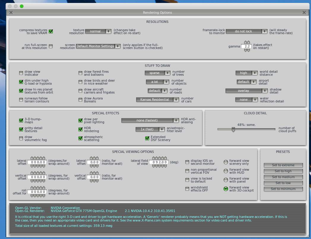

Using Beta 8, X-Life and the route EGLL/EDDM the flight plan was in the Flight-Plan folder and was generated by an on-line flight-planner.
then it was imported to the X-Life Flight Plan widget from there the X-Life plugin took over the details of the Flight Plan and all went as to be expected.
here is the bbox.txt and the log.txt for data to be use to compare the good with the CTD's
this is a must if the issues are to be resolved .
I also included the screen JPG's of the rendering setting i use on the iMac 27" .
this is my SOP.

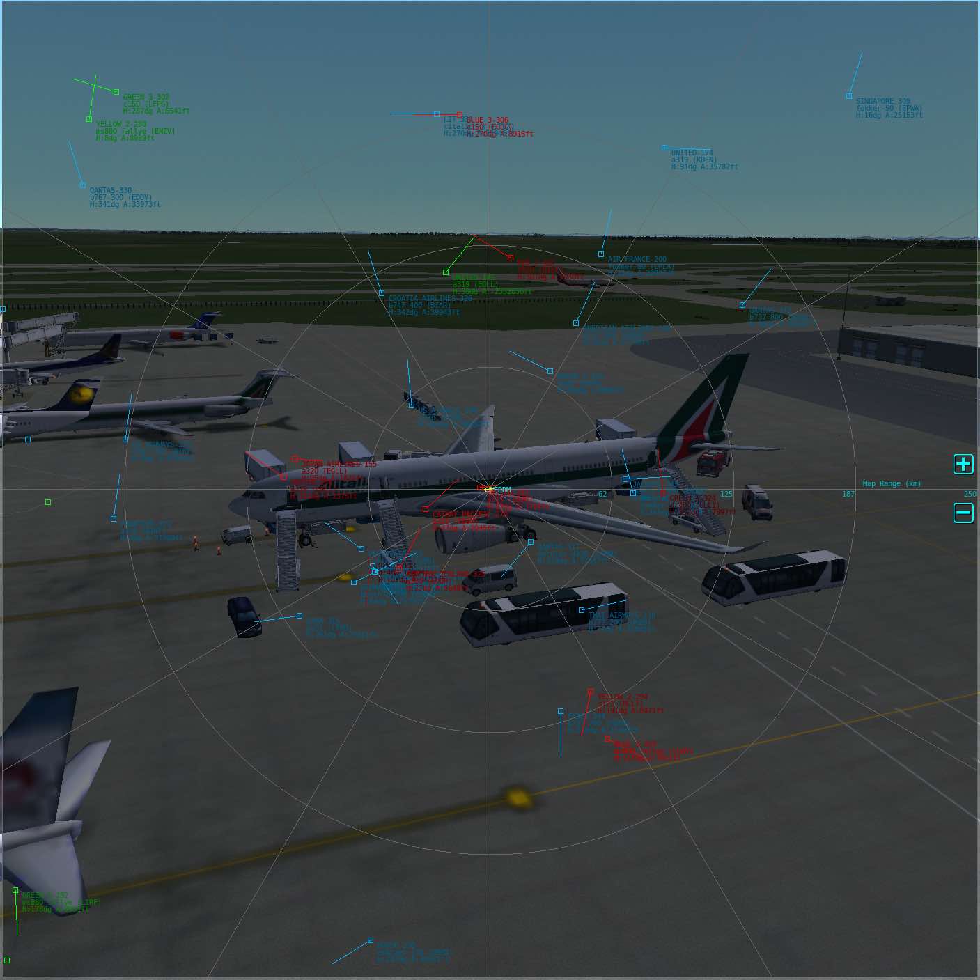

1) I have x-life now running for > 12000 seconds, no problem. Hotfix works good.
2) I think there is a Problem with integration with FMcar. Look at the picture:
http://jardesign.org/forum/img/m/552/t/p1ack6i9b057l1qepu3f1q0lbo33.jpg
1) is the actual position of the plane
2) Is the start of runway 06. If I call the FMCar by hand and select RW06 (from list), the car guides me from 1) to 2).
3) If I use X-Life ATC and call FMCar from within X-life, the FMCar stops at position 3).
---+++--- Pilot: FRIEDRICHSHAFEN Ground ,USER123, Stand GA 203, request taxi
---+++--- ATC: USER123, FRIEDRICHSHAFEN Ground, taxi to holding short runway 06, via N4,N,F
---+++--- Pilot: Taxi to holding short runway 06, via N4,N,F, USER123
---+++--- Pilot: FRIEDRICHSHAFEN Ground ,USER123, Stand GA 203, request FollowMe car
---+++--- ATC: USER123, FRIEDRICHSHAFEN Ground, expect FollomMe car 1 minute
Looks like the FMCar is send to F, not to RW06.... Is it possible that the FMCar gets the last via instead
of runway ?
Hotfix 1 + Beta 8 -> WORKING. NO crash.

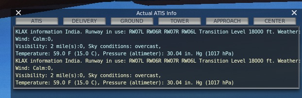

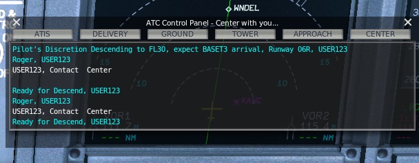

Right now I am testing a route from the KLAX/KPDX which is two airports that were designed and then implemented into X-Life and the FollowMeCar plugins.
Since, I added the txt and the dat files into the FMC and the X-Life plugin Airport Files and all worked.
Note #2 set the //* X-Life settings panel / selected aircraft to #75 and press the select,  I run between 45 and 75 on this setting.
and it is one of the first settings I make after starting the X-Life plugin.
Yet, I still got an error message that the airport was not on the google map list and it might not work right. So, you have to look past the error message and work through it and you will be pleasantly surprised by a well populated airport if you make the right settings, more data to come after the flight.
Note #2
the flight plan was good but the ATC widget did not git the data right and only had the departing airport and not the arrival airport therefore, the TOD did not work but there was not CTD so, here is the data ; bbox.txt and log.txt along with some screen shots of the error messages I received.
#3 screen shot is of the ATIS data and where the data only displays the departing airport this is why the route did not work it only shows KLAX when it needed to also display KPDX so I ran the simulation until the TOD to see if it would work out but it did not I will now close down the simulator and re-start it and try the same route.
#4 screen shot shows the message at the TOD where I was given the Data for KLAX and not KPDX . so this should give a complete picture of the scenario.
Note #5
I have rolled back from 10.45r2 to XP 10.45r1 and now the X-Life is not acting up but I still have to test at KLAX since, I am now working backwards from KPDX to KLAX and see what happens.
B.
Attachment icon Screen Shot 2016-02-28 at 1.04.16 PM.jpg 52.96 kb, 137 downloads since 2016-02-28
Attachment icon Screen Shot 2016-02-28 at 12.19.43 PM.jpg 54.03 kb, 130 downloads since 2016-02-28
