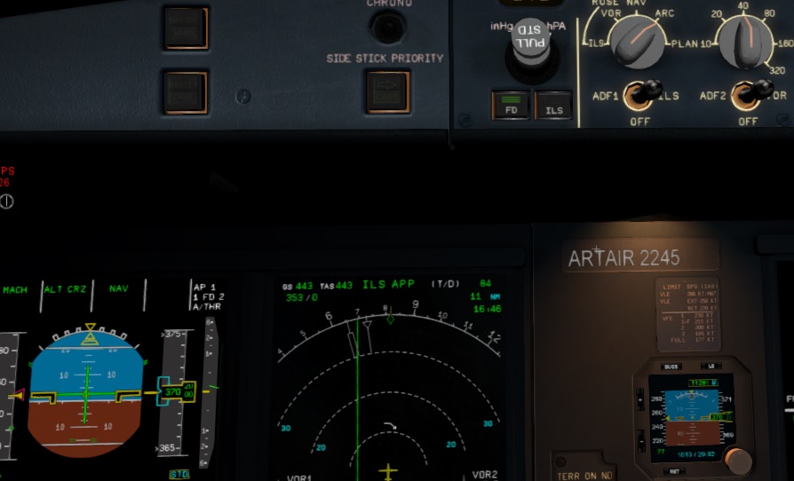

everstalker wrote:
it´s possible you have planed a to high Fl
No. In the navigation display the T/D and T/C shouldn't be marked as a FIX in "To wpt/track".
You can get the distance and ETA from the CDU

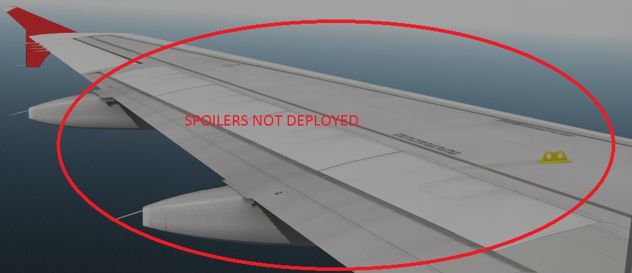

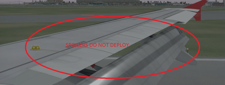

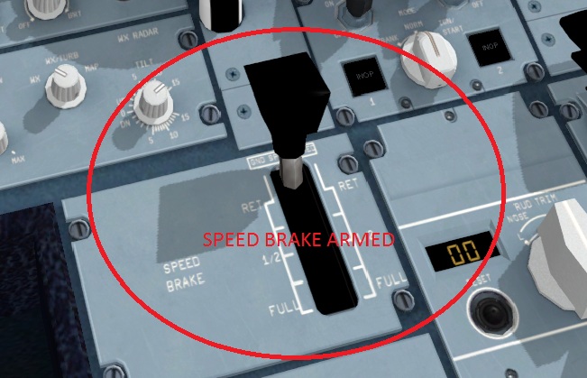

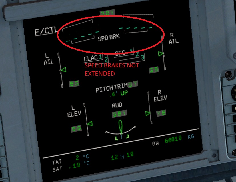

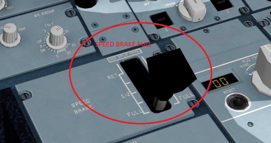

Hi all, i encountered a bug whereby the speed brakes/spoilers won't deploy (by pressing #4) if the AP gets disconnected during flight.
Re-engaging the AP won't fix the problem either. Is there a fix for this bug? My Flight Factor 777 spoilers/speed brakes works just fine so it's not the joystick nor keyboard mapping. I also confirm that this same bug exist in the A330.
Log files are attached.
Pictures are ok but, must have a log.txt to help then you will get answered.
210 (edited by Zeke*Earl 2016-03-25 05:16:10)
Re: ver 2.6 beta 4 WIN/MAC 64 bit
Hi, log files are attached. I also discovered that i have to disengage AP, bank the aircraft left/right to 'force' the control surfaces to work. Spoilers/speed brakes work after doing so. Thank you.
