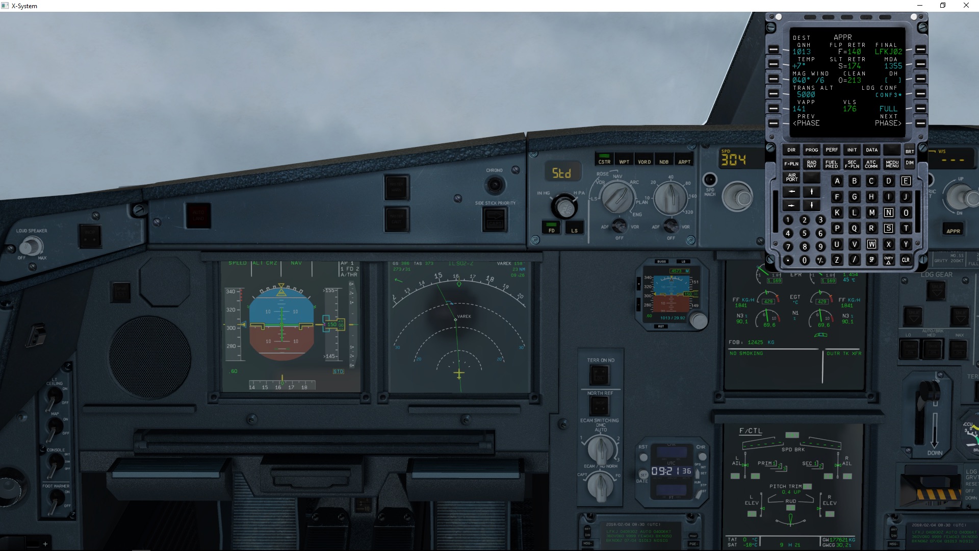

Bugs:
VLS > VAPP, which looks strange (check enclosed screenshot)
When selecting GPS approach in LFBD via ROYAN8L STAR, transitions (like ETPAR) are missing.
However, it's possible to get them with previous A330 version.
