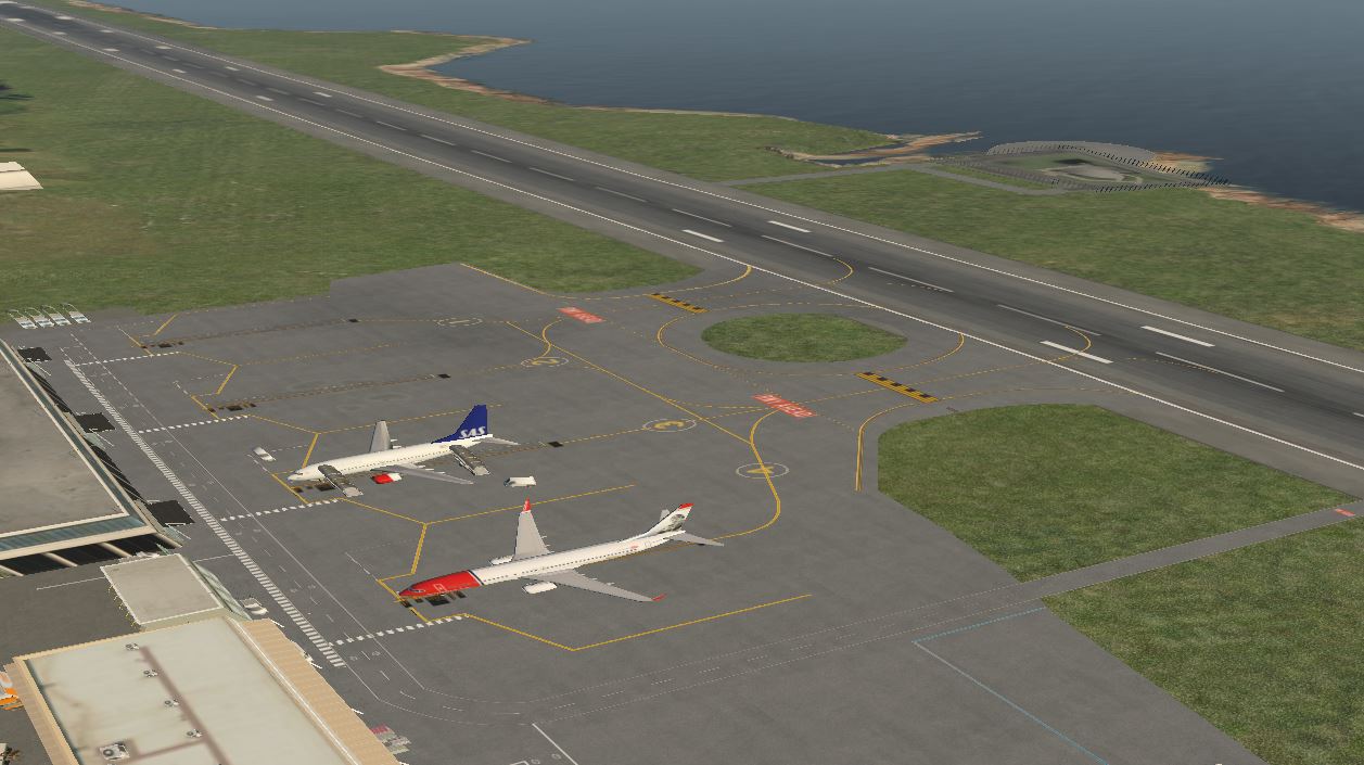

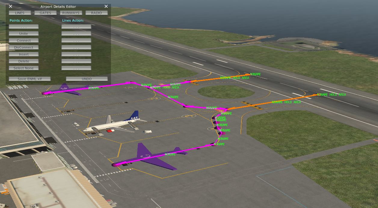

I have tried to create custom routes for two airports.. ENTO and ENML.. But the aircrafts that spawns on my self-created airports, they're just standing there. No inbound and outbound traffic either.. What should I do to fix this?

From your second screenshot it's clear you have no runway line. From the LINES tab Start Drawing a new line on the centre of the runway from one end to the other, make sure it's connected to the Hold Area nodes by clicking on each node, then Stop Drawing. Select all segments of your new runway line and under Lines Action click Mark Runway, then save.

keem85 wrote:
Hi!
Thanks, but when I click on the "runway" tab on the menu, the runway becomes visible. Is that something else?
Yes, line on the 'RUNWAY' tab is picked up from apt.dat file, the runway needs to be entered on 'LINES' tab too.

What I recommend for you is to delete your airport .xlf file in D:\X-Plane 11\Resources\plugins\X-Life\Airports and begin again since you don't have a runway line. You MUST have a runway line in RUNWAY and LINES tabs.
Once you see them in both tabs you can begin your work with ATC taxiways. Remember, you MUST have a holding area line as the last line connecting to the runway. Also remember to name each taxiway properly since this is needed for ATC.
