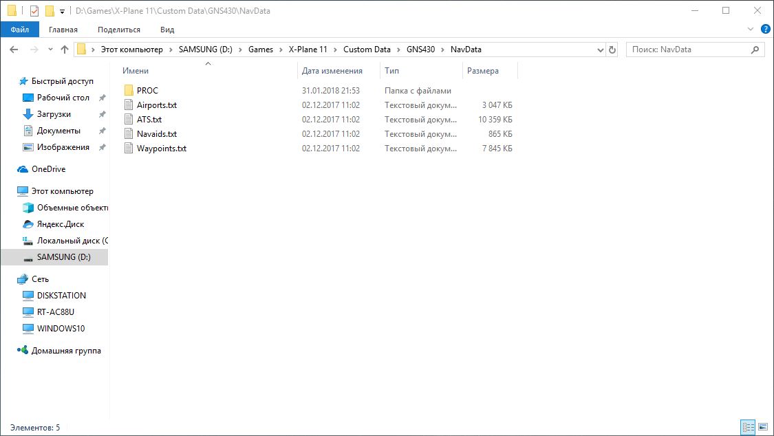

Re: X-Life ver 2.1 R1
Everything is working fine for me.
I just replaced two .xpl files from beta7 version.
BUT when I trying to update NAV DATA, X-Life still using it's own NAV DATA dated 2012 from ...X-Plane 11\Resources\plugins\X-Life\navdata
I used jardesign_a320neo_native_1713.zip and extracted NavData into ...X-Plane 11\Custom Data\GNS430\ folder
Why? What I did wrong?
Replacing of ...X-Plane 11\Resources\plugins\X-Life\navdata makes X-Life stuck and kickout from the game.
Please help.
Please help.
That may be wrong installation/folder or wrong NavData format. No more reason exist.

Yes, still have a message that X-Life is using NavData 30/09/2012... from ...X-Plane 11\Resources\plugins\X-Life\navdata
X-Plane 11 x64, i7-5930K@4GHz, 32Gb RAM, GTX1080Ti @2560x1440
May I look at ..X-Plane 11\Custom Data\GNS430\navdata\ folder and
..X-Plane 11\Custom Data\GNS430\navdata\proc\ folder

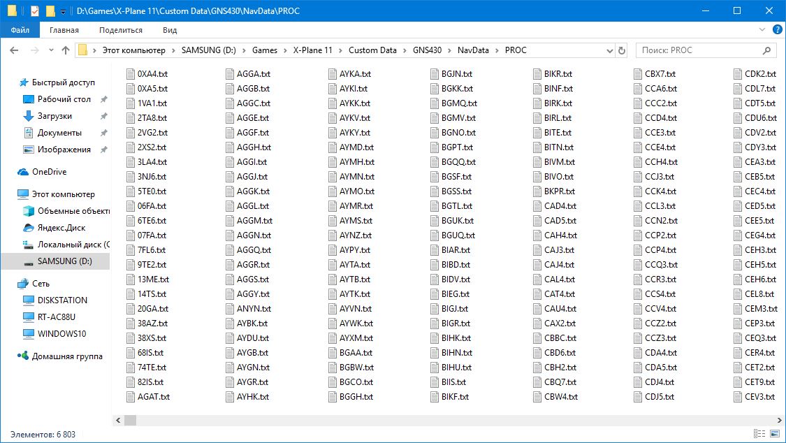

Serega_G wrote:
JAR wrote:
Did you try to set X-Life settings to minimum for start?
Here you go... (see attached)

Serega_G wrote:
Some files are missed inside NavData folder. You may compare files in original and in Your folder.

JAR wrote:
cycle_info.txt was absent. Fixed. Thank you very much!
