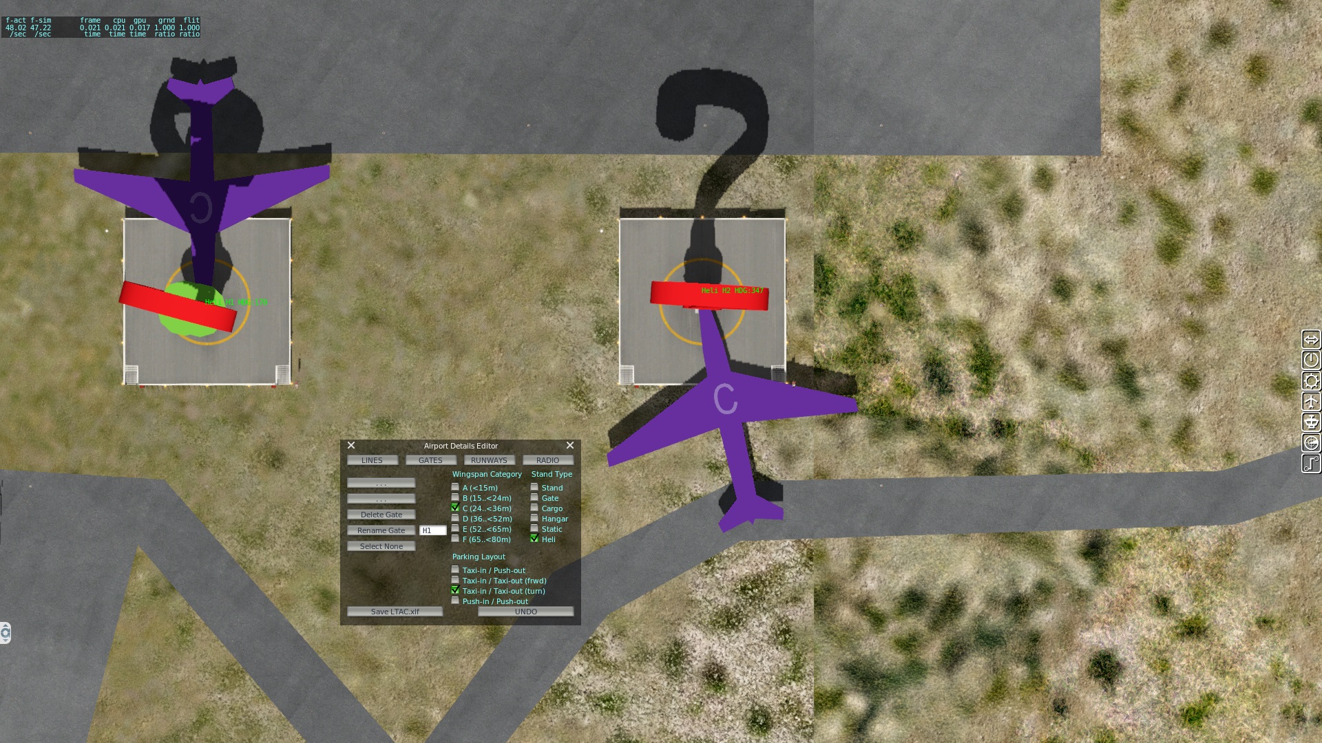

Eugeny,
I think I have conquered all but one of the big "RED" question marks.  The attached screen shot shows question marks on
helicopter pads.  I noticed in the gate editor there is no choice for a helicopter.  What corrective change do I need to make for
these question marks to be removed?
Thanks for your help and the manual.
Ron West

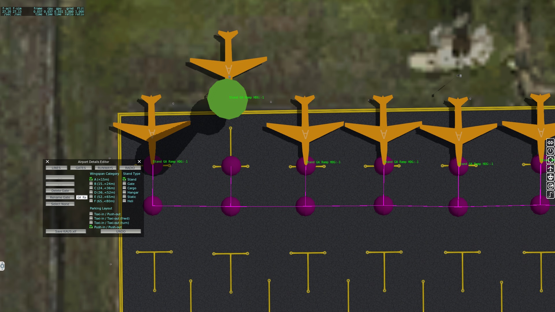

Eugeny,
In the attached screen shot I am trying to set up airplanes being backed into a parking space.  I have moved one airplane off of the taxi line so you can see how I setup the parking space.  Several questions:
1.  Will push in push out parking instructions in airport editor back an airplane into the parking place?
2.  Do I have the nodes set up correctly to have a plane pushed backwards into a parking space?
Thank you for your help.
Ron West
Attachment icon Push In Push Out Parking Question.jpg 433.13 kb, 289 downloads since 2017-08-27
