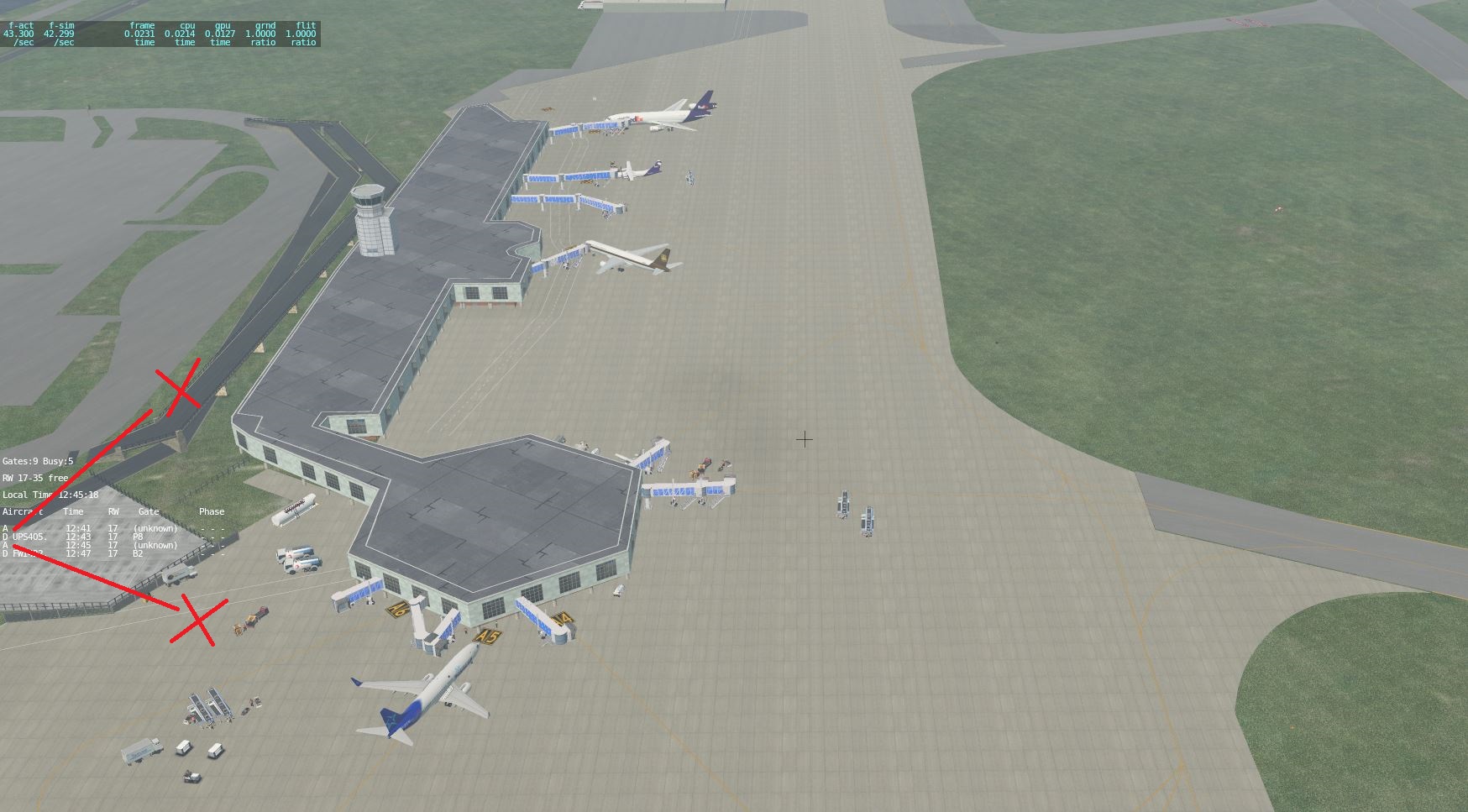

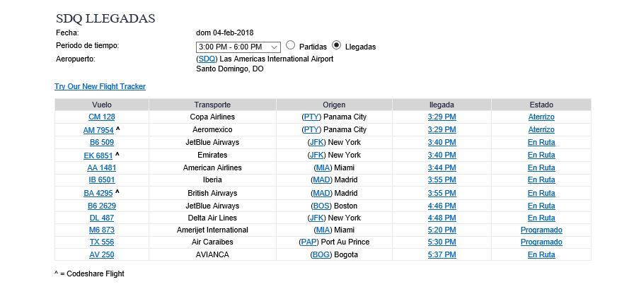

Phil, I don't know if I am doing something wrong but installed ver 2.1 R1 and look what is happening.
You can check real arrivals to MDSD in the pictures I attached and look at the actual load of X-Life. No corresponding liveries and no arrivals programmed.
First I replaced the new X-Life folder but almost all the work done was lost, gates settings and no taxiways that were included in previous versions, then I again replace the old folder and only replaced the new .xpl file and you can see what happened.
Any comments?
Regards, Juan

Do you have the Bluebell AI traffic installed? If not go to the v2.1 post again, links and instructions are there.
Regards, Phil
