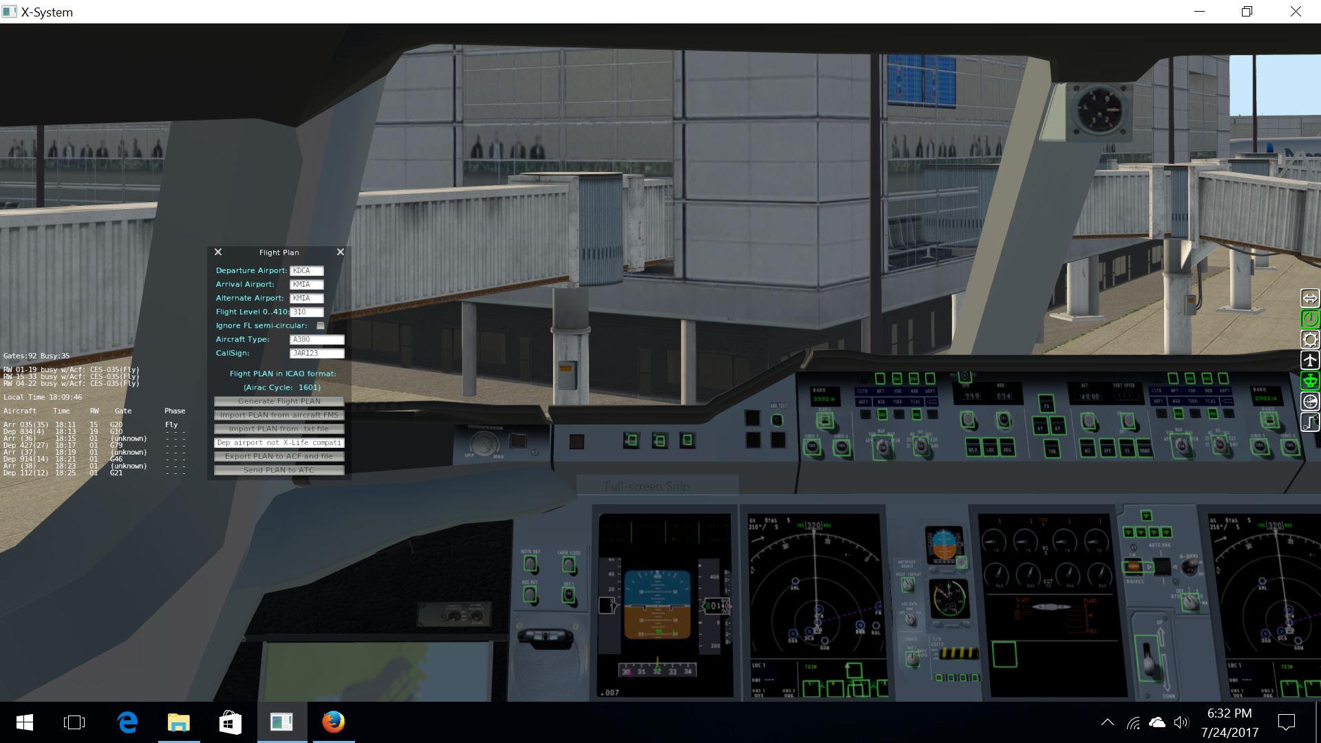

JAR here's a picture of what my problem is. If I try to generate a flight plan from UNVERIFIED airport KDCA the message says Dep airport not X-Life compatible. So therefore no flight plan can be generated. Is there any solution to this? I think you should be able to generate a flight plan to and from any airport. Thanks

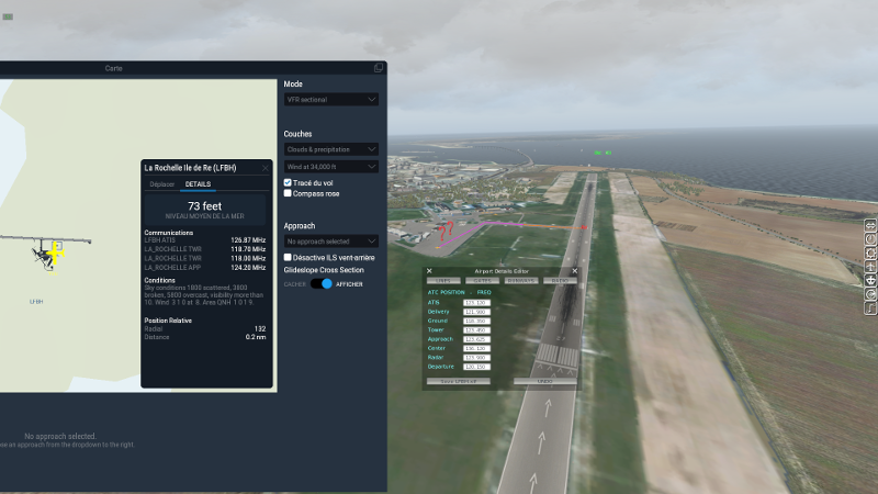

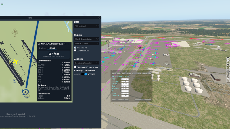

Re: X-Life ver 2.0 R1, R2, R3, R4, R5
Pictures of frequency problem :
2 airports non-verified Xlife LFBD and LFBH
2 airports Xlife ready LFBO and UUDD
Thank
cmckjodi wrote:
JAR what mean is if I try to enter a flight plan from an UNVERIFIED airport example KDCA to any other airport, a flight plan will not be generated. So we need to be able to generate flight plans to ANY airports. Does that make sense? Thanks again
Yes, undestand what you mean.

Understand. Problem was - FREQ was saved well from Airport Editor, but when X-Life open .xlf file, FREQs override with some default. This build (R4) should fix this. Sure, we will renew some published .xlf files later.

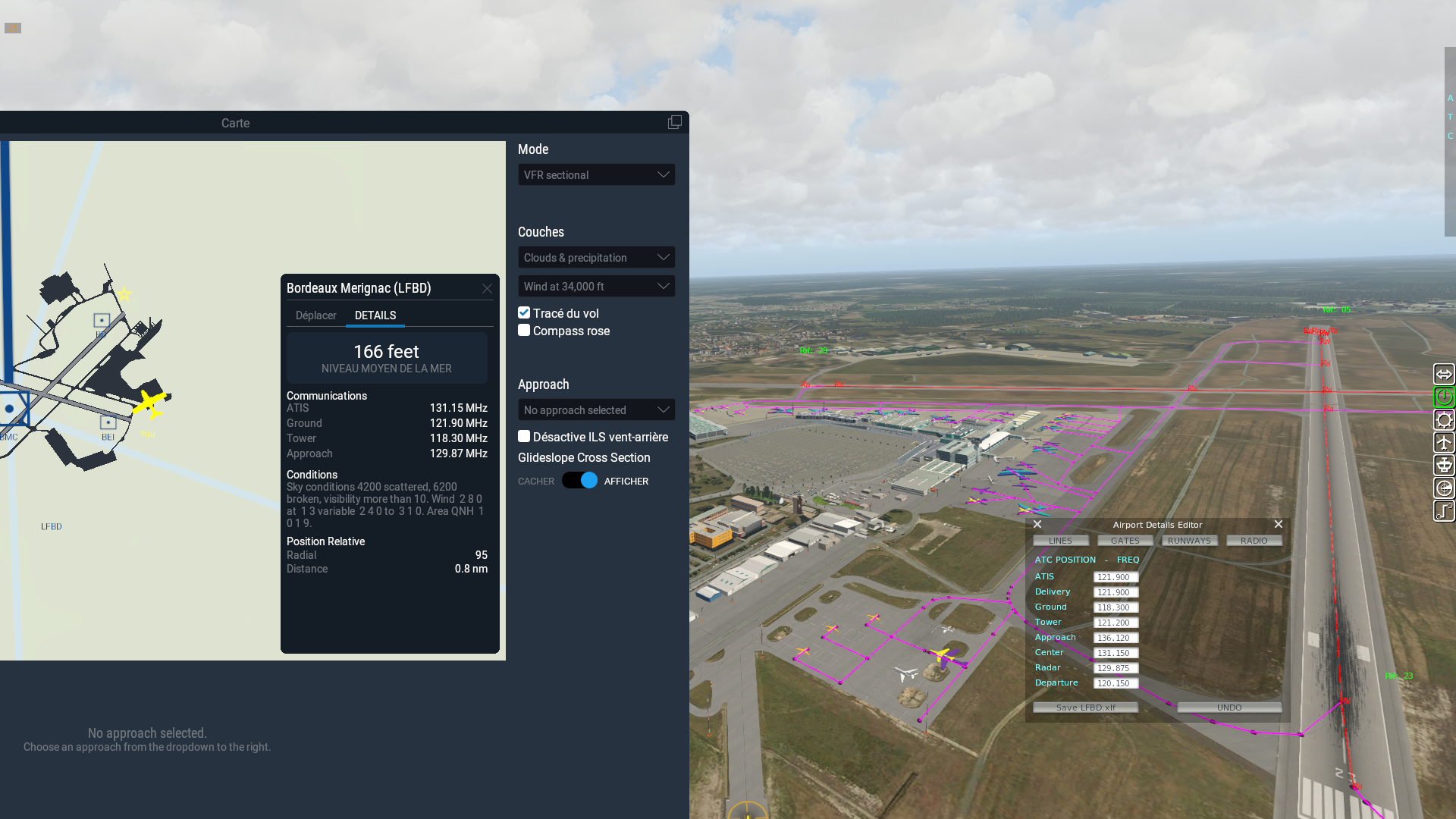

Just tried xlife 2.0r4 ---> same frequency problem than 2.0r3
It would be a good thing if xlife could pick-up xplane default frequency without any manuel change by airport editor radio tab
thank a lot

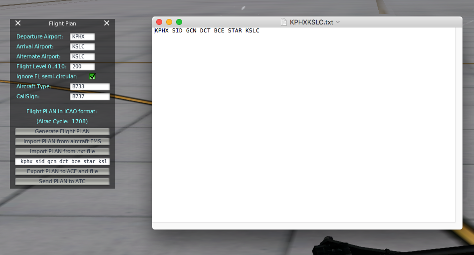

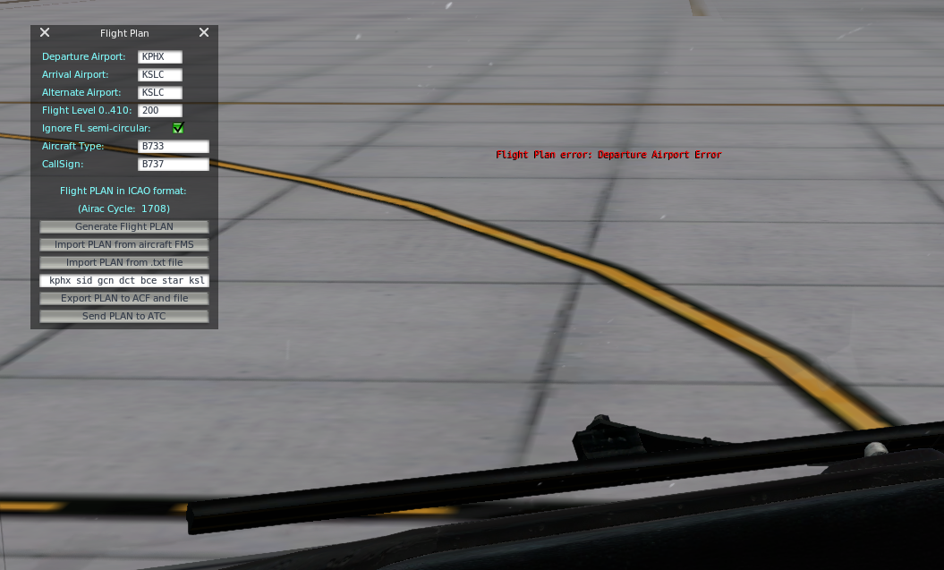

No, no, you are not understanding what I mean.  All works with the .txt file.  But, when I manually TYPE in the very same flight plan (letter per letter), it does NOT work.  Here are some pictures.  And yes at the end its KSLC, the C is cut off on pic view but it is there.
Attachment icon Screen Shot 2017-07-25 at 9.36.52 AM.png 245.79 kb, 151 downloads since 2017-07-25
thank a lot
So, as we just test, we can change FREQ and save it, and this changes will be reading after reopen this scenery. Is not it?
