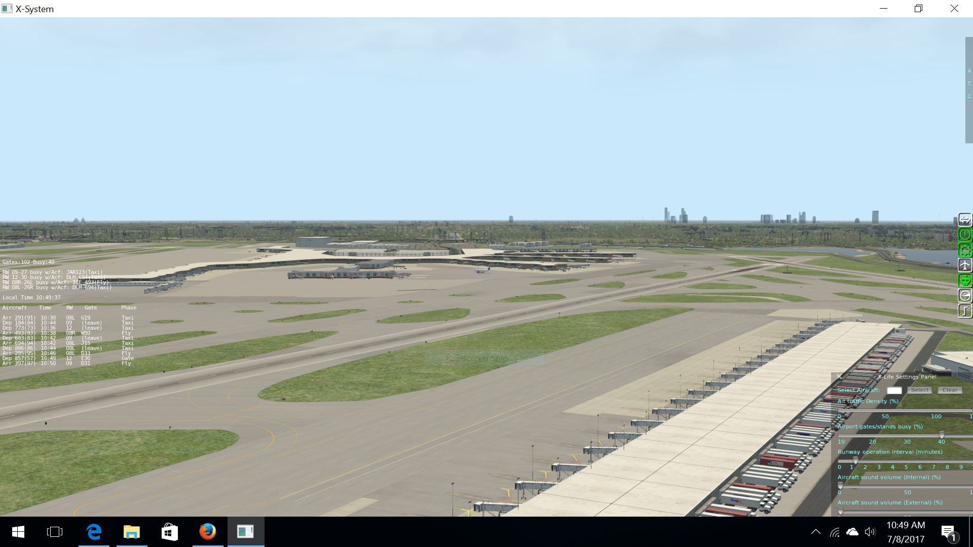

Still a problem with traffic not appearing or functioning. This is KMIA after cleared to land by ATC no planes at the airport. Possible bug? Thank for your help!
This happen Only with KMIA airport or ANY airport?

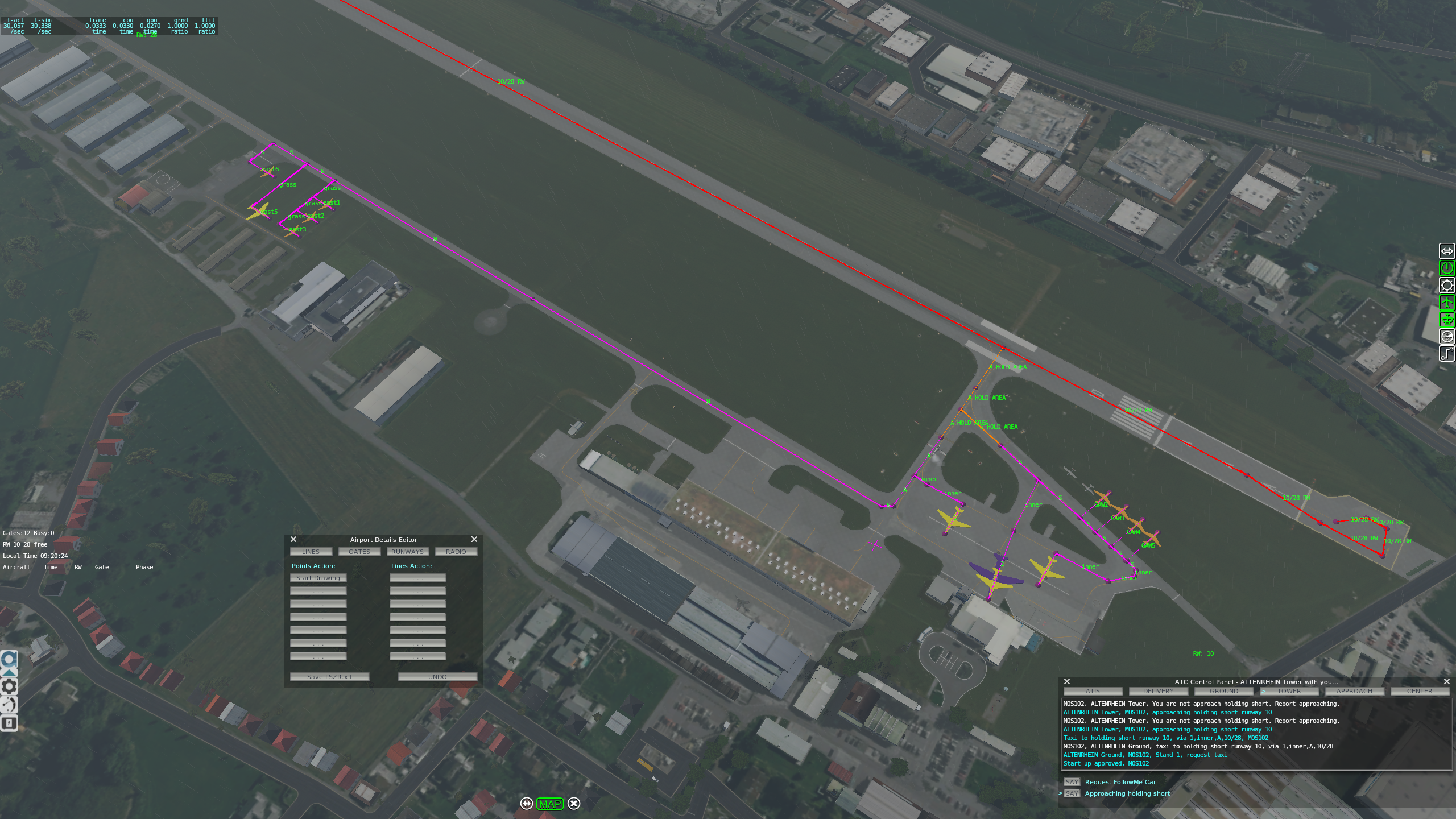

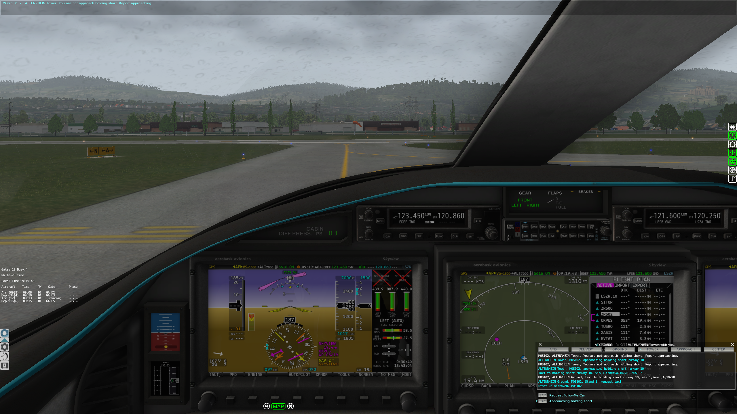

another problem: ATC says "You are not approach holding short ....", but i am on holding point (see pics LSZR)
"snap": i mean on nodes in "line-mode" (see pic E1000_3 near A to N)
Hi JAR,
how does "snap to nodes" work, because the snap is sometimes far away and works not well (cannot snap to another node) or i have made a mistakes ?
please reply
Did you mean Gate? So, if moving position not exact, need just move view closer to this place.
It also happened at KSLC but the problem is not constant only on occasion

Hi JAR,
Hi JAR,
please reply
You may be at any holding short, but you are too far from hold short your target runway for takeoff.
