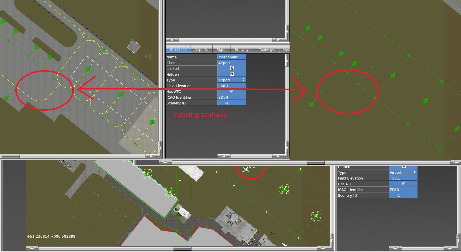

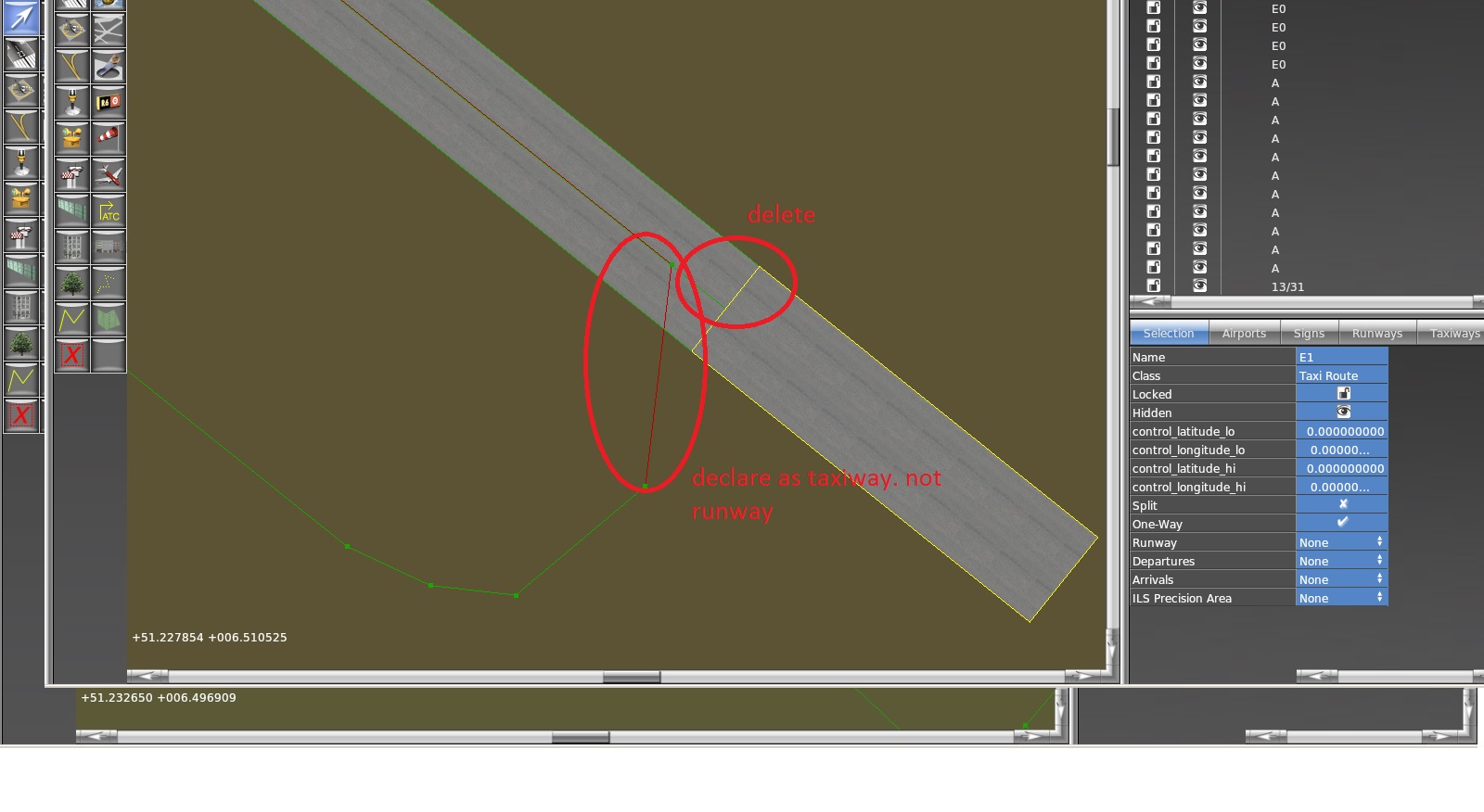

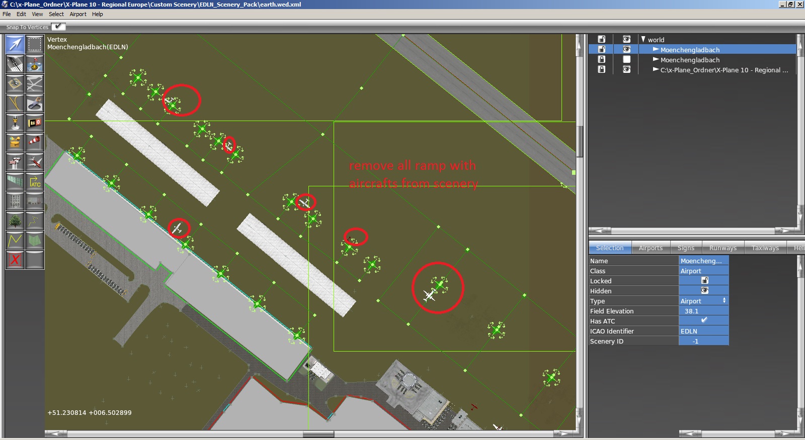

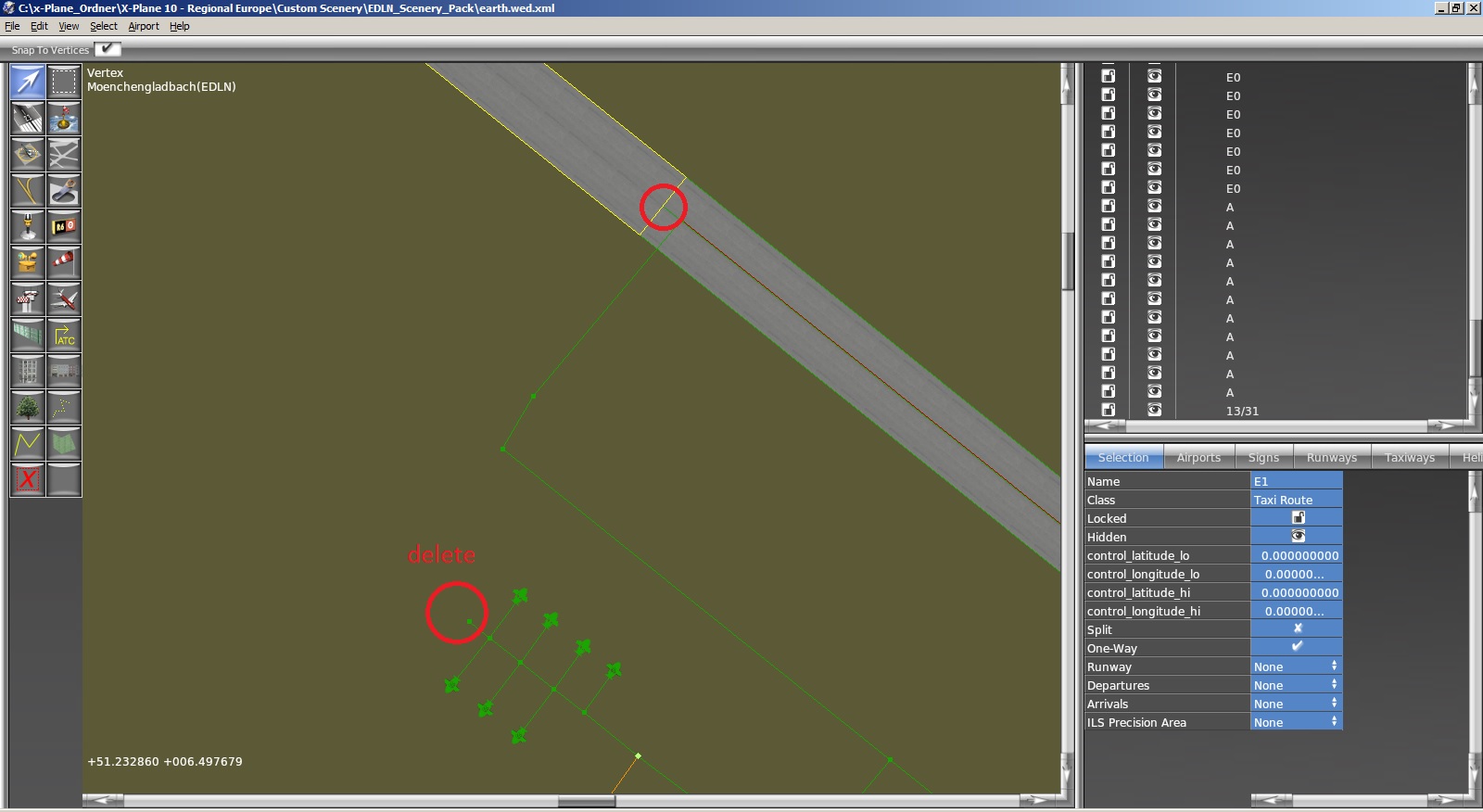

i have take a look at your edln.dat file. One rule is, that ramp has only 2 words. You have 3. Exampel: Main Ramp 33
Check attachment for more errors. I stoped after error 4.
Error 5: Your taxiroute dont follow the gateway airport. I tested your files with the gatway EDLN airport:
https://gateway.x-plane.com/scenery/page/EDLN
ID 797.
You should first reimplement your apt file.
