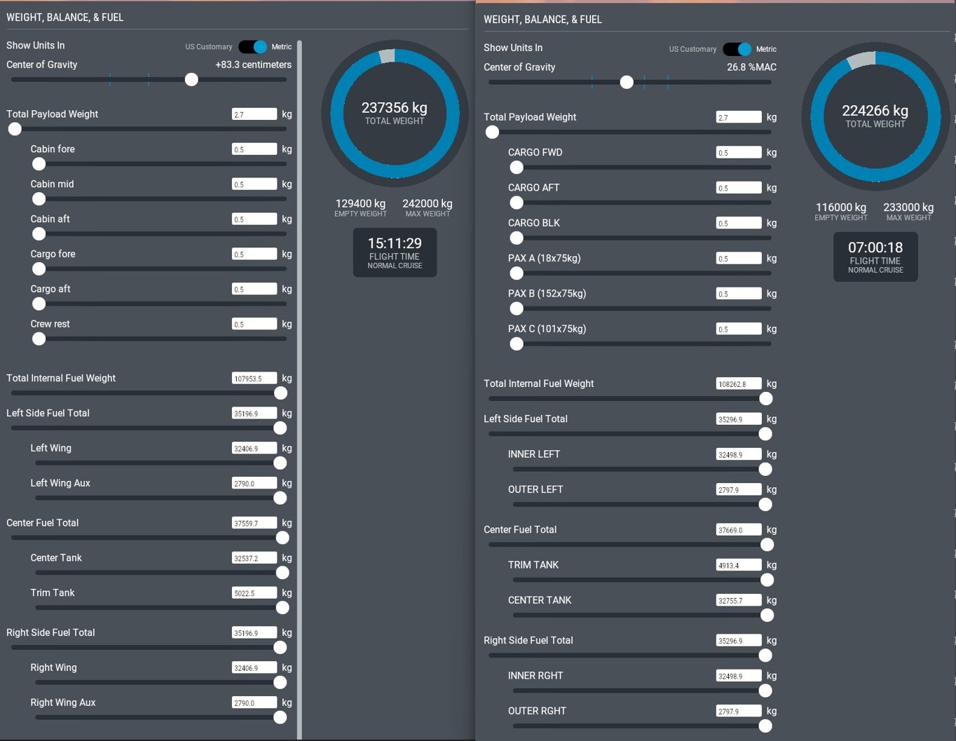

Hi. Hoping you can shed some light on this.
1. The flight time is short by about half. I've attached a screenshot comparing with the default A330.
2. The plane is constantly recalculating its positing, meaning it constantly jumps off course and then goes into a holding bank. I've attached two screenshots, just a few seconds apart to show this (see the chrono).
I'd disabled all other plugins, other than better-pushback. Unfortunately, it's unflyable right now.
1.You may follow MCDU prediction and not care about build-in X-Plane calculation.
2.Not sure in details situation you describe. If this happen constantly and you sure that everything that you do - right, please contact me skype j.a.romanov - we will do flight together and will see what happen wrong.
