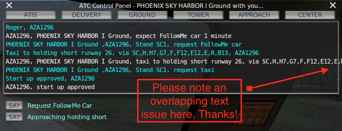

Hi guys!
I just came across this problem. I received a "very long" ATC taxi clearance, and I got this cosmetic issue (overlapping text).
Please see attachment, thanks!
Attachment icon Screen Shot 2016-04-10 at 6.09.56 PM.jpg 180.08 kb, 216 downloads since 2016-04-10
