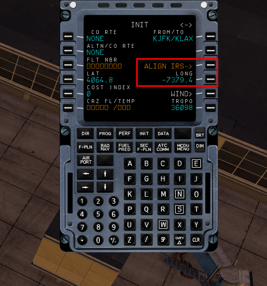

Hello, sorry if my problem has already been mentioned but I do not know where to look to see if there is already a solution.
I bought the 330 this morning and I just tested the ground procedures at LFBO. Tonight I wanted to fly KJFK/KLAX but when I entered my information on the FMC INIT page, I noticed that KJFK's GPS position was wrong with a latitude value of -73 ° instead of 73 °.
I saw that this problem existed on the 320 and that it seemed to be fixed but I did not find an identical mention for the 330.
Thanks in advance for your help, sorry for my english and again sorry if the problem had already been reported.

Thank you for your answer but it does not answer my problem.
I said that the GPS position of the departure airport was lost after I got KJFK/KLAX on the INIT page. When I confirm this, the GPS position where we click on ALIGN IRS on the INIT page is wrong and so I have a DISCONTINUITY between the departure airport and the 1st WAYPOINT of the route.
I explained my problem to a friend who owns the A330 JAR and he too has encountered this problem.
OK I understand now. I'll try the same and get the same picture on screen. Even I try to load different version of KJFK airport I'll get the same result.  This is really problem, but when you enter departure runways and SID in your flight plan and clear discontinuity you can go to fly.

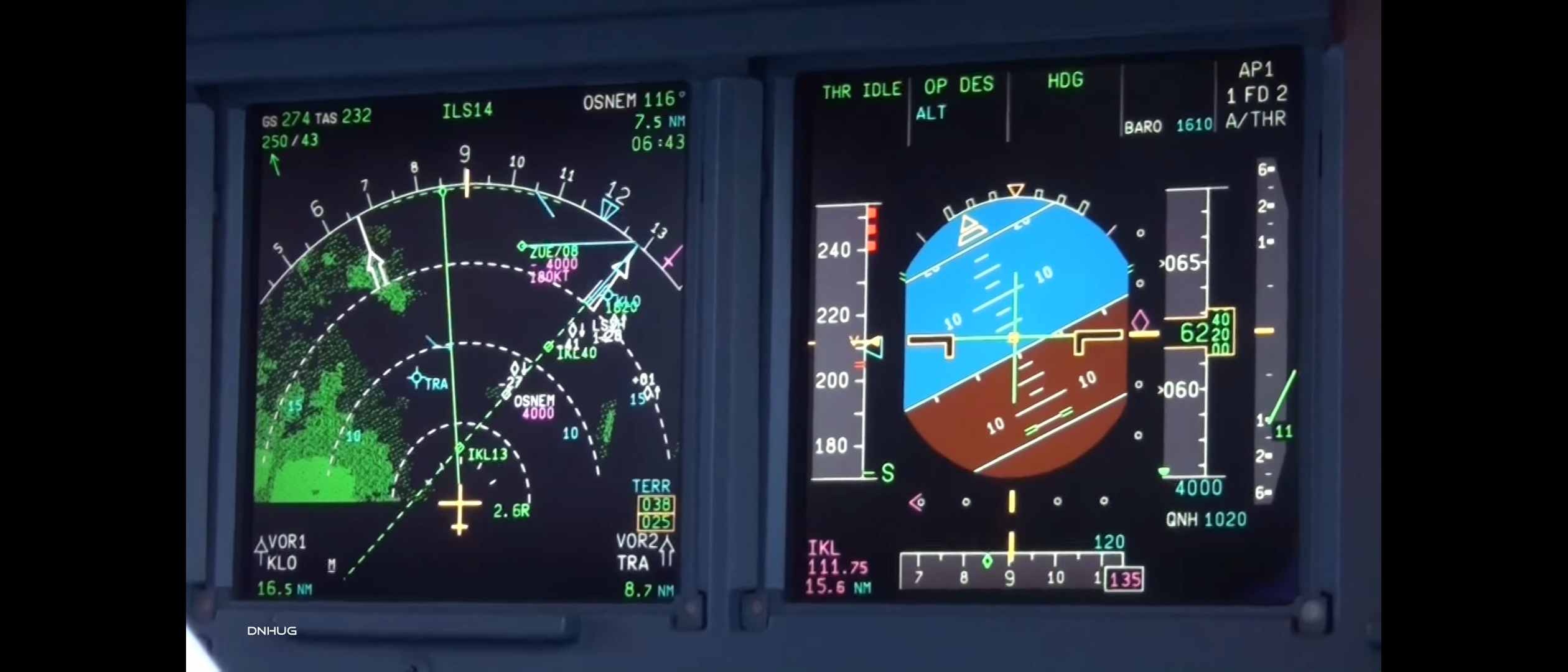

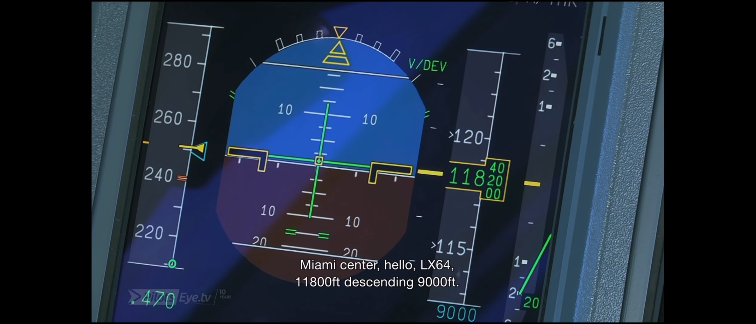

Евгений, доброго времени суток! Возможно ли реализовать вот такую визуалку на PFD? Заранее благодарен
