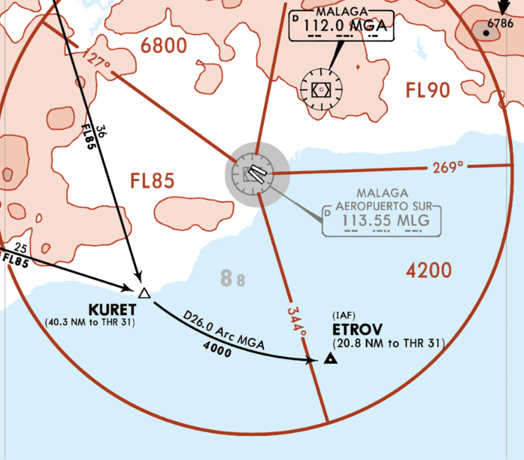

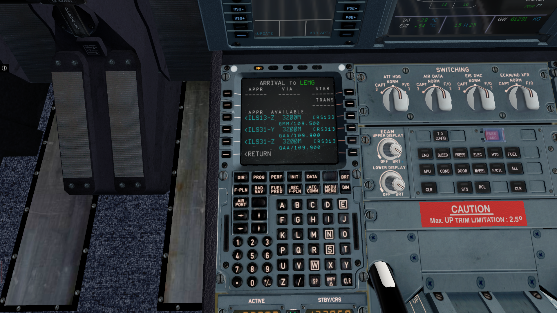

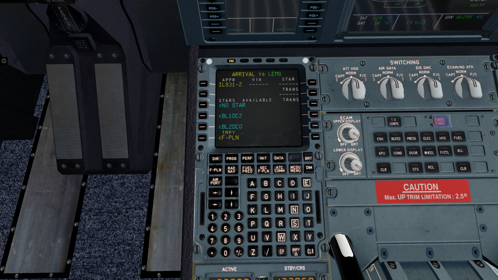

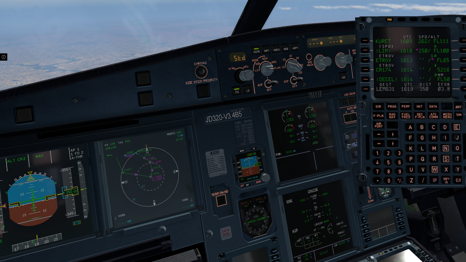

Been having an issue with the plane where when entering an arrival how it should be entered, some red text appears warning of apparent missing waypoints and the arrival doesn't enter correctly, can anyone else confirm the issue? Seems to happen when DME Arcs are involved, does this support DME Arcs at the moment? If not that explains smile.
Kieran.
EDIT: Some screen shots showing step by step what I mean. Arrival is LEMG ILS31Z via VU2DCJ which has a DME arc. The section that fails is between two waypoints that should be joined by a DME Arc bu instead there is just a discontinuity and you have to get rid of that resulting in a straight line instead.

Some (2 as i remember) kind of legs cant be read with correct way. This is a reason for message. We will fix this in future, but as for now - need use another STAR or add points manually. Sad about this.
