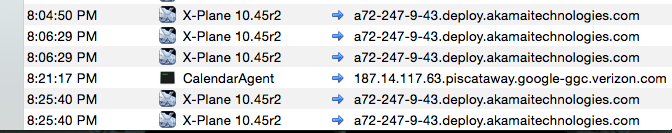

This is the issue I am now on the track of what is causing the issue... I I do believe this is everyones issue ...
B
Hey Capt....like I've mentioned before, either here, the org or both. Something strange indeed is happening.  Luckilly, all traceable smile
B
Yes, i am watching now ..

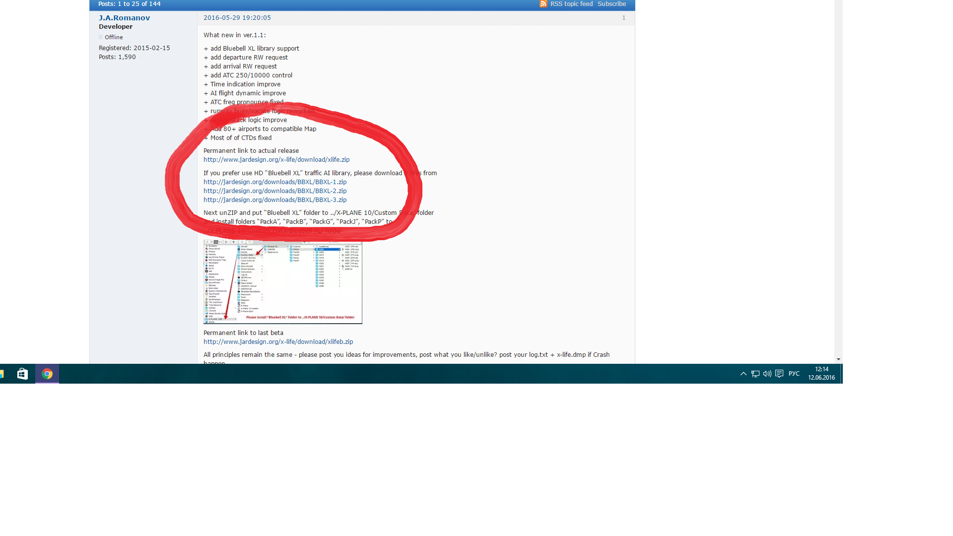

Здравствуйте. Я скачал то что обведено, и установил согласно вашему скриншоту. Не работает. X-Plane закрывается.

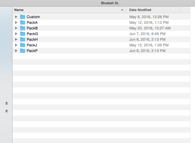

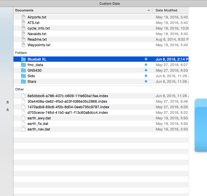

So, I understand you "Hello. I downloaded something that circled , and installed in accordance to your screenshot . Does not work. X-Plane is closed ."
So, the file (BlueBell) get placed into the //*Custom Data Folder/ then the following folders go into the Bluebell file;
Pack; A,B,G,H,J,P, and Custom ///
That is all if you do it right you will see a read out on the log.txt if you look it will be towards the bottom of the txt.
Happy Flying,
