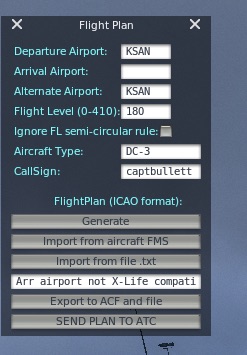

starting a new test KSAN to KAVX yet I am getting an error message that the KAVX airport that is on the list of approved airports yet it is, and the JPG is showing this error.
I am using the DC-3 aircraft so I re-started X-Plane and will see if using another aircraft is  going to change the system.
Attachment icon Screen Shot 2016-05-29 at 5.46.55 PM.jpg 35.32 kb, 245 downloads since 2016-05-29

You are not enter arrival airport (see at your screenshot). You enter just alternate.

I did enter the arrival airport and the widget removed it and gave me an error message...
this is why I posted the message ...
I also re-downloaded the airport so, I know i had a fresh copy this  also put me over my allotted 20 GB of data for the month so my Cable bill is going to be over 250.00 US dollars.

Understand. I check NavData - there is no procedures file for KAVX. This is a reason I think.

exactly, it is on the list of approved airports yet you cannot use the ATC to make a route was this checked at the time of development and or should it be posted on the site so people know this is so...
