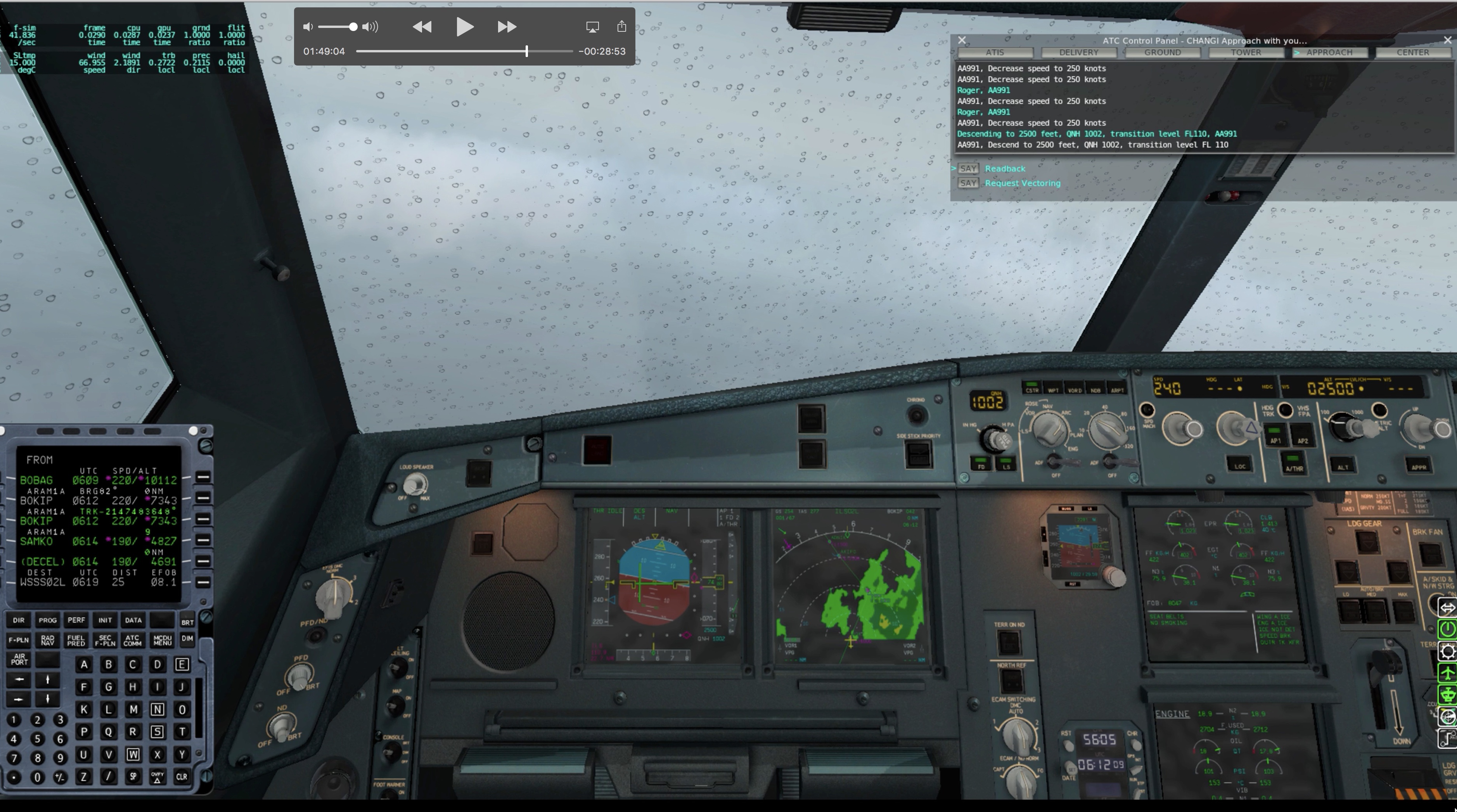

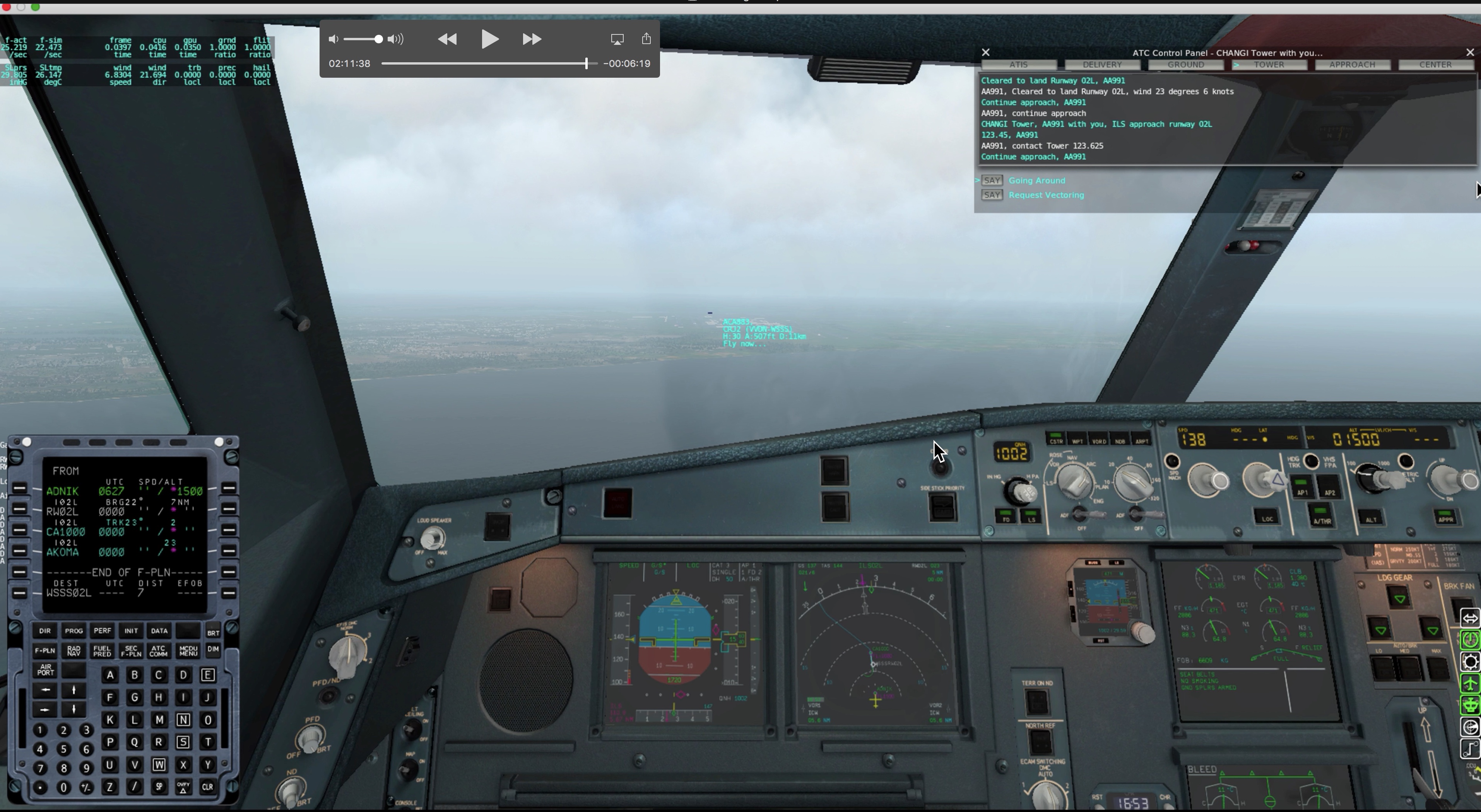

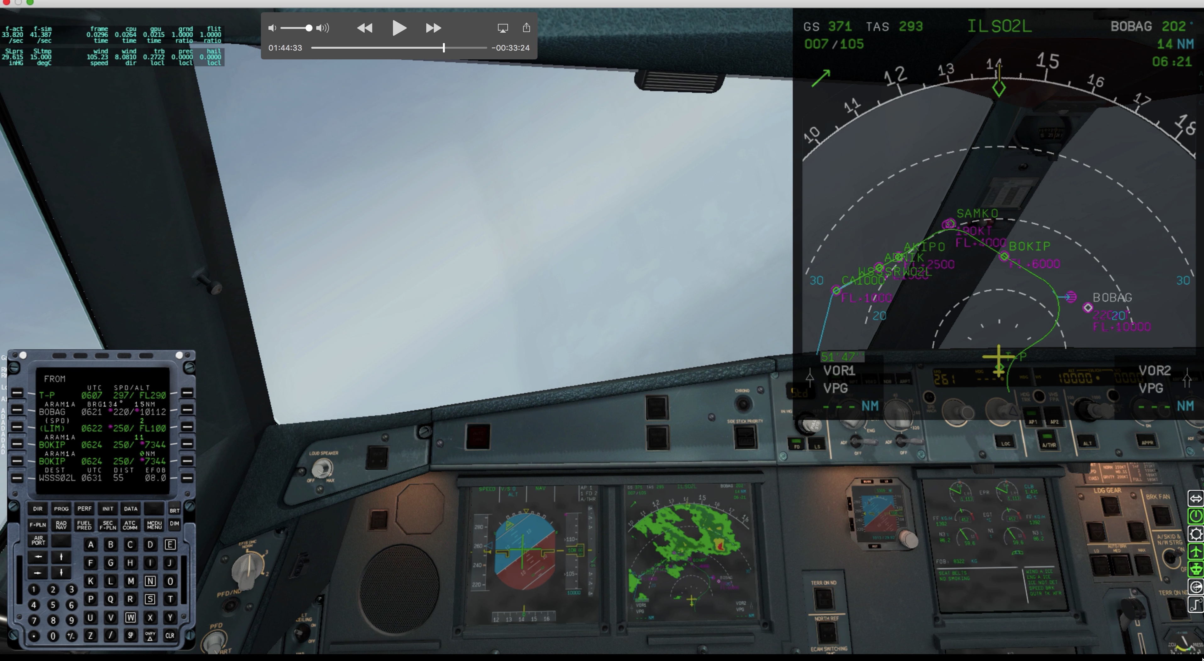

MrGeeBee wrote:
Pretty good flight, bad ending. Not sure what's happening. If it's me or something else.
Constructive feedback please.
https://youtu.be/pmYL59aZ188?t=7737
Too bad that you did not enlarge the route. It is difficult to see clear the ND. But I recognise at 02.14.41 that you ar flying toward PISAS at FL 5000ft too high to catch LOC or G/S. Then I see that the turn at OM23 is far too narrow for straightened with the runway.
I didn't follow the whole video and don't know about the flightplan, but I think that I had added at least on or more additional FIXes before OM23 to have a less sharp turn to RWY. Adding FIXes can be handled through the A330 MCDU. Or as I now see delete LBV and you solve you problem.
BTW I see now that you didn't activated the APPR probably on time. It initiate the speed reduce and descent to G/S.....

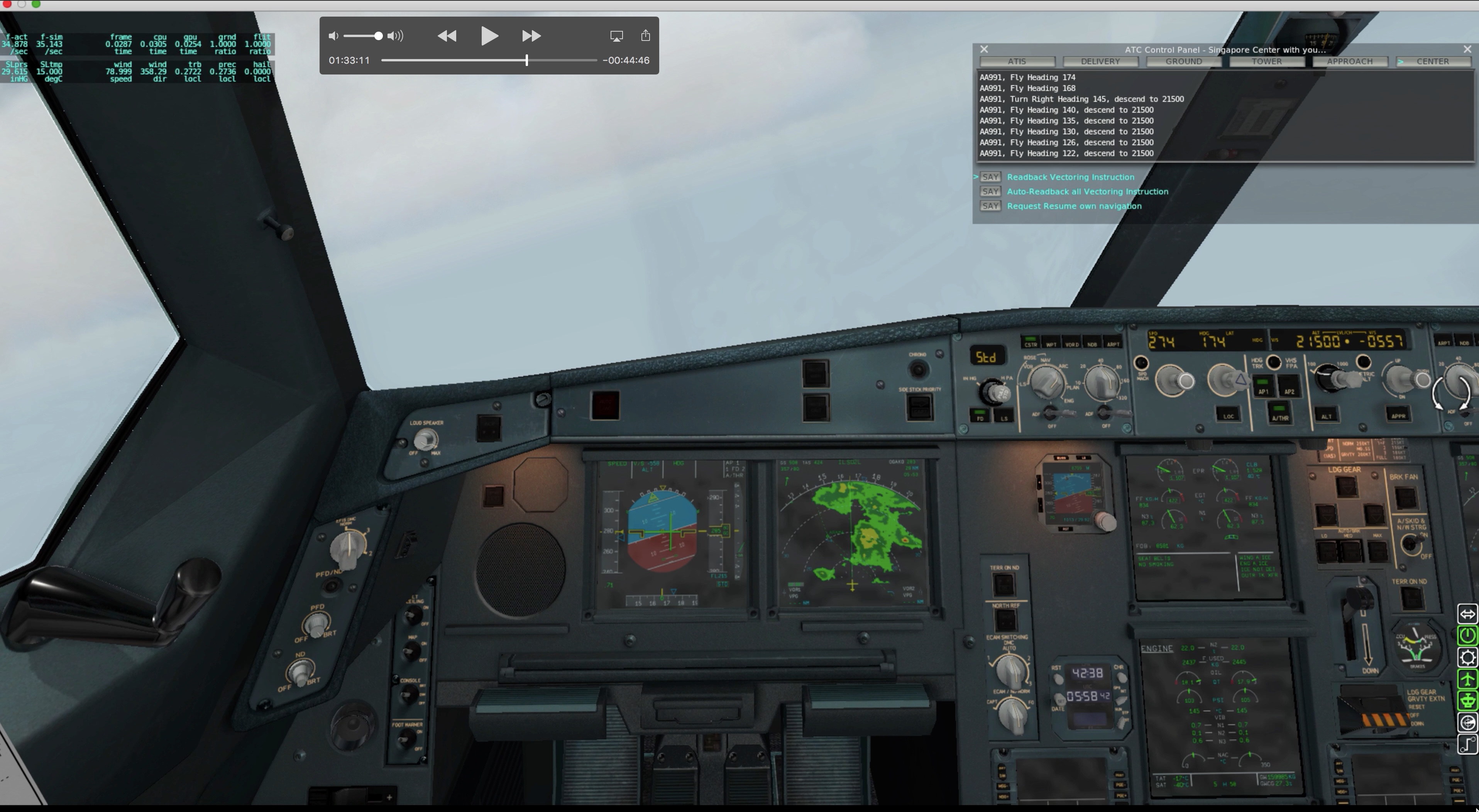

202 (edited by ilankrt 2018-02-16 23:34:26)
Test flight A330 v.B4 using XL: All systems are working well. No special occurrences.  This time I waned to see how aircraft behaves under stormy weather conditions, so I turned off real weather conditions and configured manually a stormy weather.
At 88kt tailwinds entering storm clouds aircraft lost the AP ability to hold flight route. Then AP disconnected several times and aircraft seems to roll over. flying manually through kicking the rudder helped to level aircraft but I couldn't"t hold flight route any more. Having now 77kt sidewinds I had to reduce speed and get the right FL - too much for one pilot ....
At least at 105kt (!) tailwinds I reached 10000ft and began with the approach. The imported thing is that the aircraft model stayed full functioning all the time through..... though this behaviour there was no way to land. Back to real weather conditions and Go-Around (flight path was not correct this time) manually back on G/S I land safely...
Thanks for the feedback. Yes, I should have looked at the approach better, it was way off. Fixes definitely. smile But if you check the start, is also where I program the MCDU, but it's still wrong. Done other flights and they work great now. So will do some more streams soon. And keep it up Jar! You are doing this great.

I too just watched the video and unfortunately, you were a victim of an "incomplete MCDU" which should have allowed you to insert the proper arrival/transition for RWY 23.  Manually adding fixes appears to be the only solution at this time until JAR can at least acknowledge that the MCDU is not complete.  Had you been able to properly add the transition route from LBV (or initial approach fix ELBE) it would have taken you on a course of 066 for 21.8 miles from LBV.  Then a procedural turn to PISAS or a point 9.3 miles from the RWY at 3000 feet.  Then, the landing would have been much easier to manage along with your altitude, speed, flaps deployment, etc during approach.  Looking forward to a complete MCDU......
Yes, I'm using Pilot2ATC and this is how the plan looked there, but transition is not in the MCDU, it always give No Transition:
