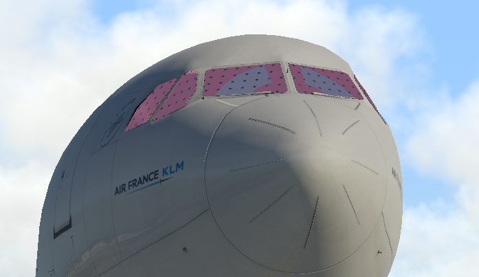

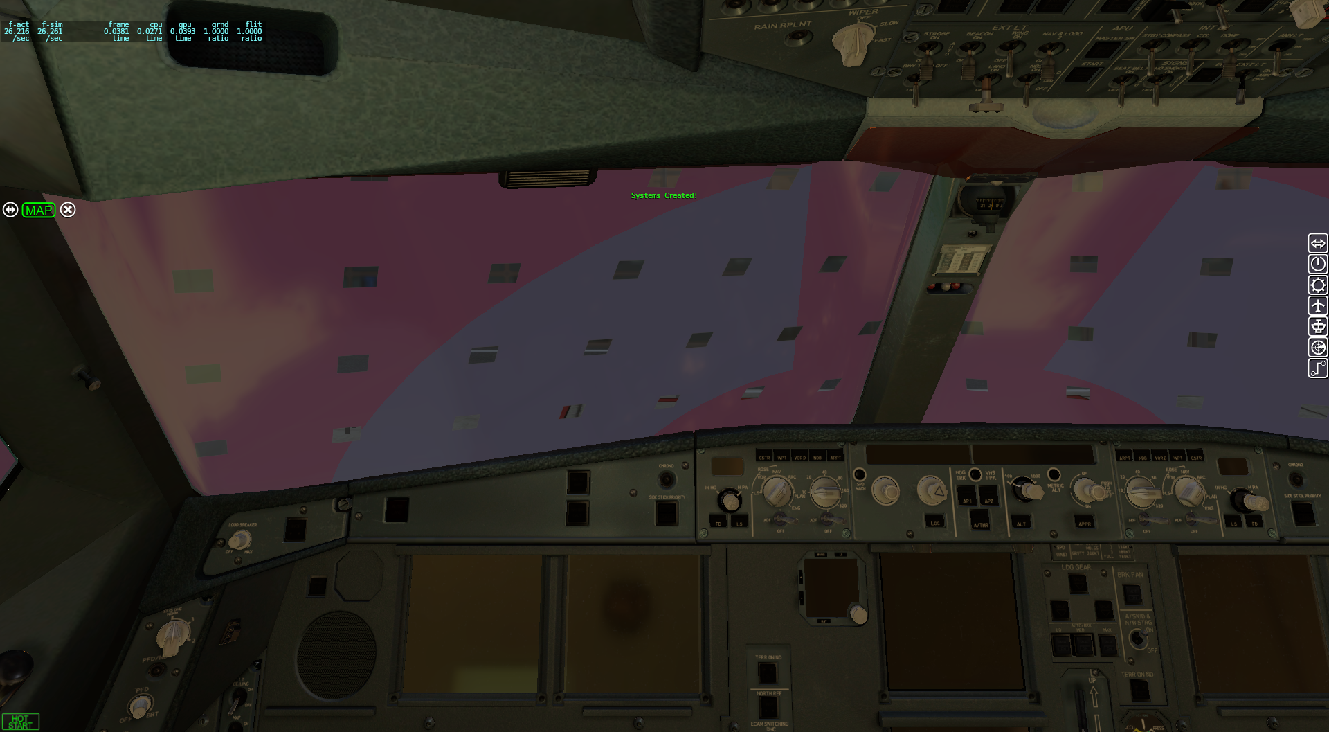

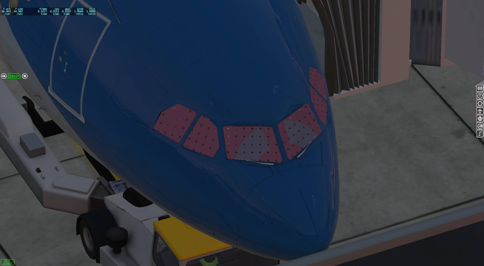

jmb35 wrote:
zpampal wrote:
Downloaded, installed. Used my existing key. And this is what I get.
The same problem for me...
MCDU MENU -> Settings -> rain window disable

96 (edited by TKurzweg 2018-02-09 15:01:03)
Hello JAR, after sucessful beta 3 activation the aircraft looks like this! Default, JARDesign and all other paints. What's happened? Thx for your answer, Thomas
see answer of enrigolan79 above
