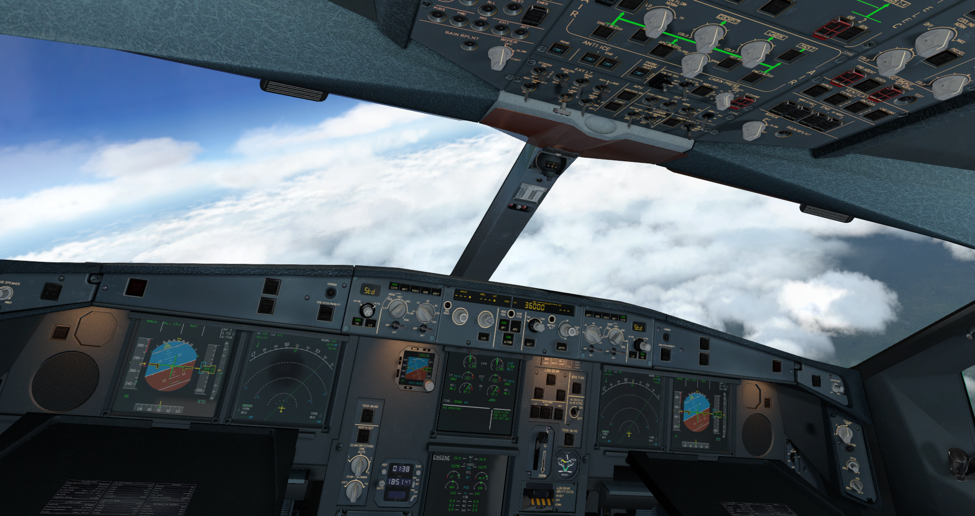

207 (edited by sidiclei 2018-04-16 15:45:13)
Re: XP11 JD330 v.3 r1,r2,r3,r4,r5

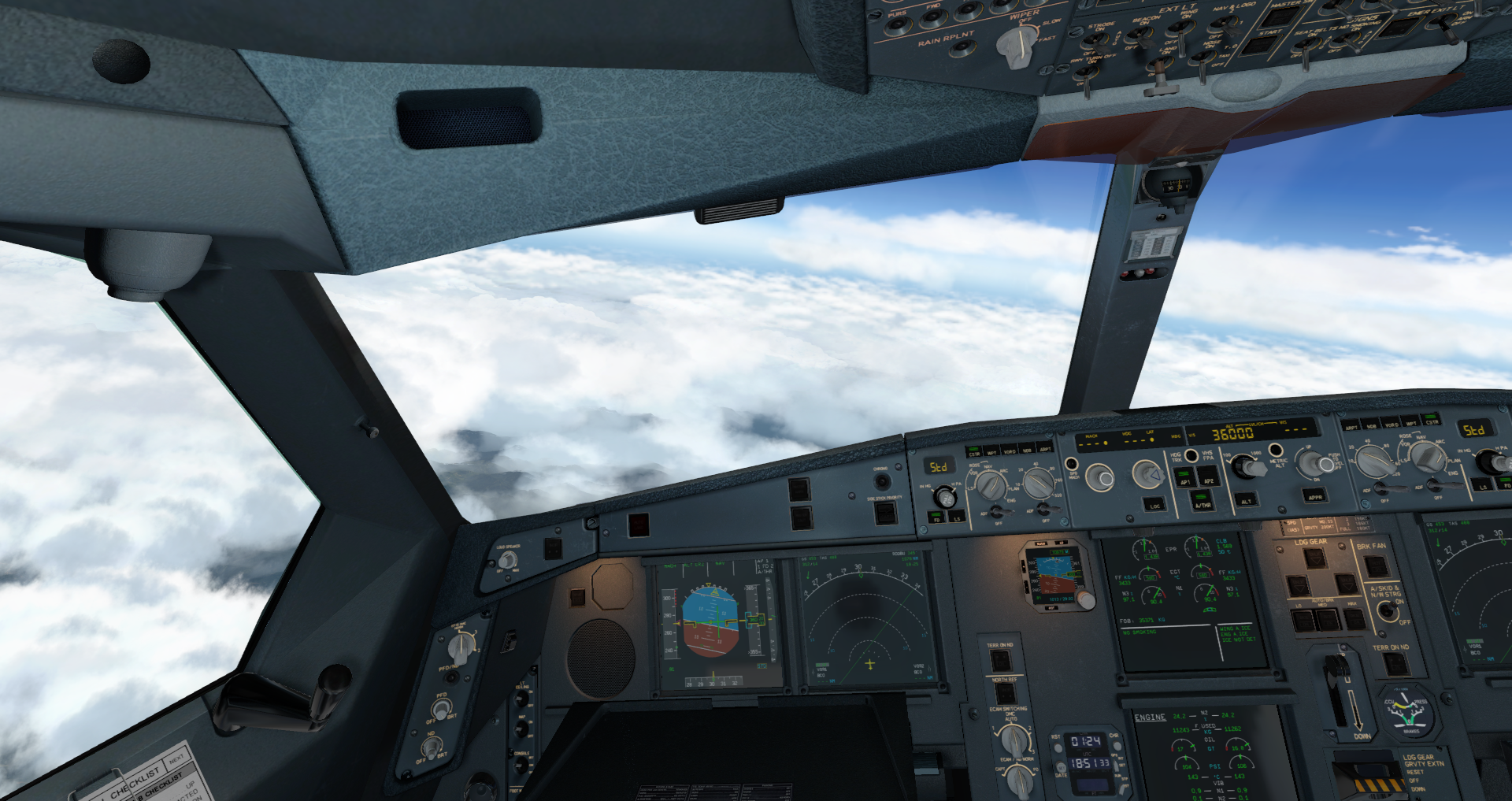

hello there. Since I updated my A330 I've being having a problem. It doesn't fly straight. It flies in zig zag. Does anyone know what's going on? I love this bird and use it all the time with my long haul flights. Attached are pictures of what it's being doing lately.
thank you!

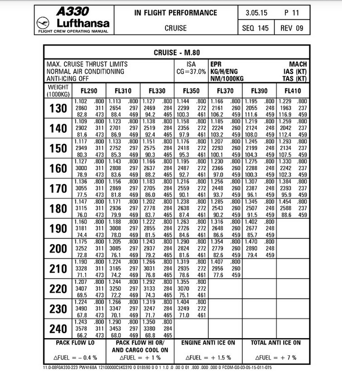

Seriously i am quite surprised. I first didn't want to invest time in having to prove that there is a problem and am seriously wondering why you still didn't notice the big difference in fuel burning beetween reality and that model. I was expecting users here having enough knowledge in aviation like having made observations from real DVD-flights and cockpit preparations etc. to notice this inacuracy. Anyway, here are the exact numbers:
On the left you will find the burning rates according to the original performance table from Lufthansa and on the right the ones measured during a Test-Flight with the Jar 330:
weight 185'000kg, FL390, M 0.80: 2'599 Kg /h    Jar = 2'099 Kg/h (difference: -19%)
weight 180'000kg, FL390, M0.80: 2'507 Kg/h    Jar = 2'054 Kg/h (difference: -18%)
To measure it i disconnected the Autothrottle and adjusted the thrust leveler to the exact point where the speed stayed at Mach 0.8 during at least 10 minutes, so that the FF was constant.
The test-flight i made was LSZH-GMMN. The professional flight planner PFPX - built using real world professional performance datas - calculated 14'852Kg of Tripfuel. But the Jar burned only 12'360 Kg on that trip (-17%) although the winds were quite similar to the ones taken into account by the Flightplanner. On longer trip these difference is a bit bigger since the take off and landings are counted in that number and on short trips the cruising phase is shorter compared to them.
Another thing i noticed is that the take off performance seems to be quite inaccurate as well. I could barelay take off form RWY 28 in LSZH (2500m) with a weight of only 190 tons, flaps 2 and Flex 40. I had to push the throttle to TOGA to lift off 300m before the end of the Runway.
Summary: the perfomance of the Jar 330 is quite inaccurate and i dont understand why nobody noticed that before or why there is no interest fixing that.

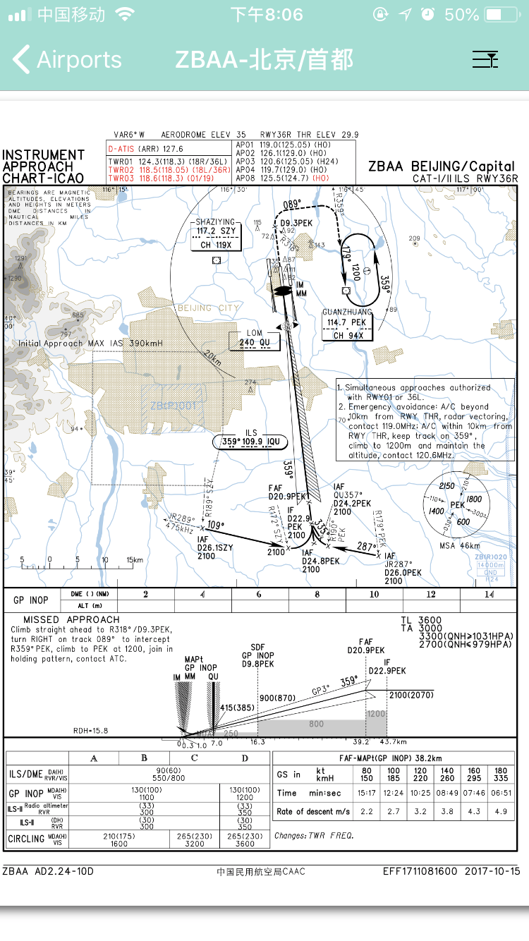

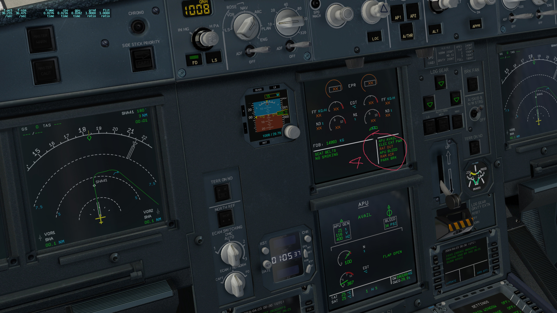

219 (edited by shanemontoya 2018-04-23 01:40:18)

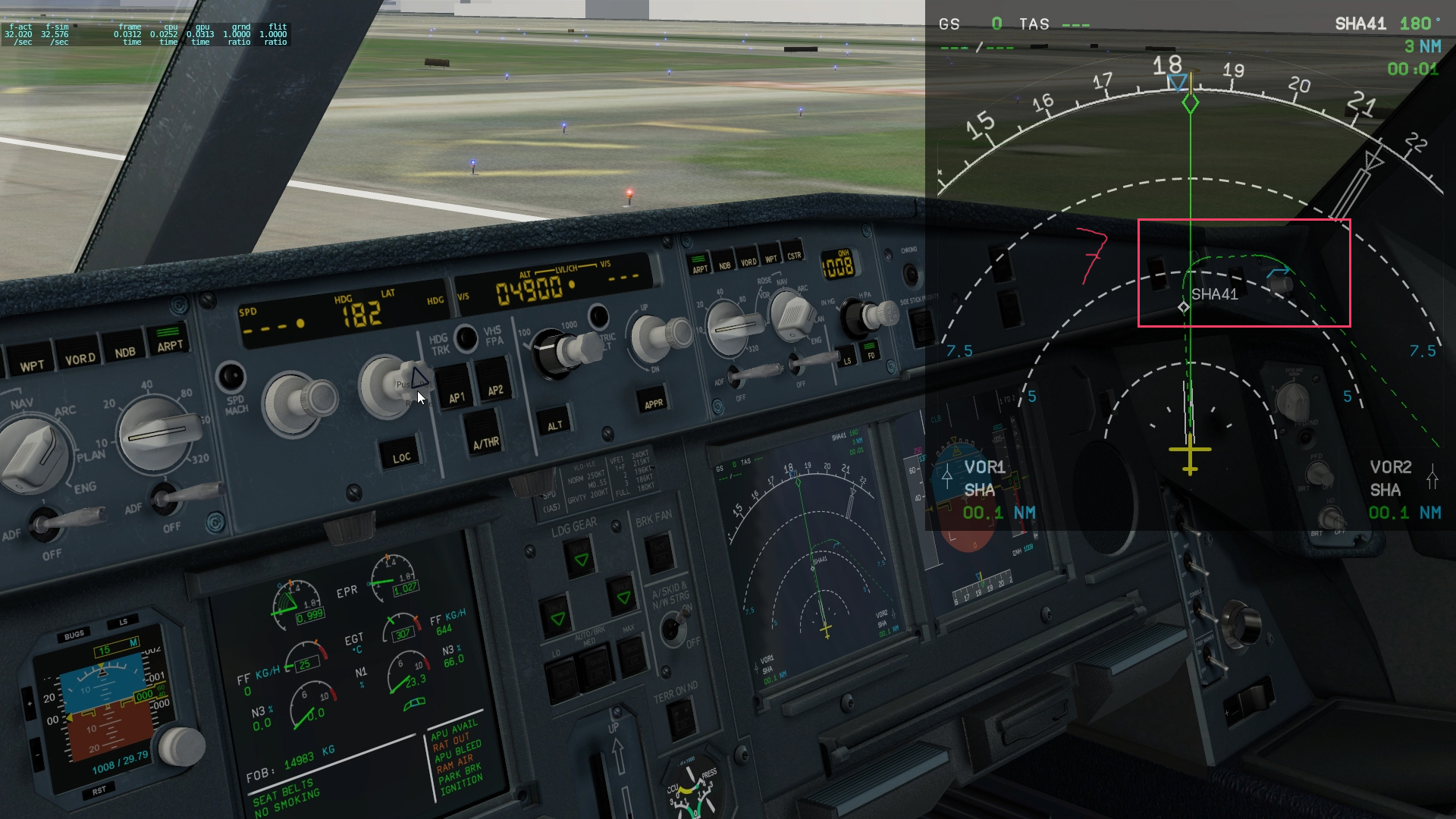

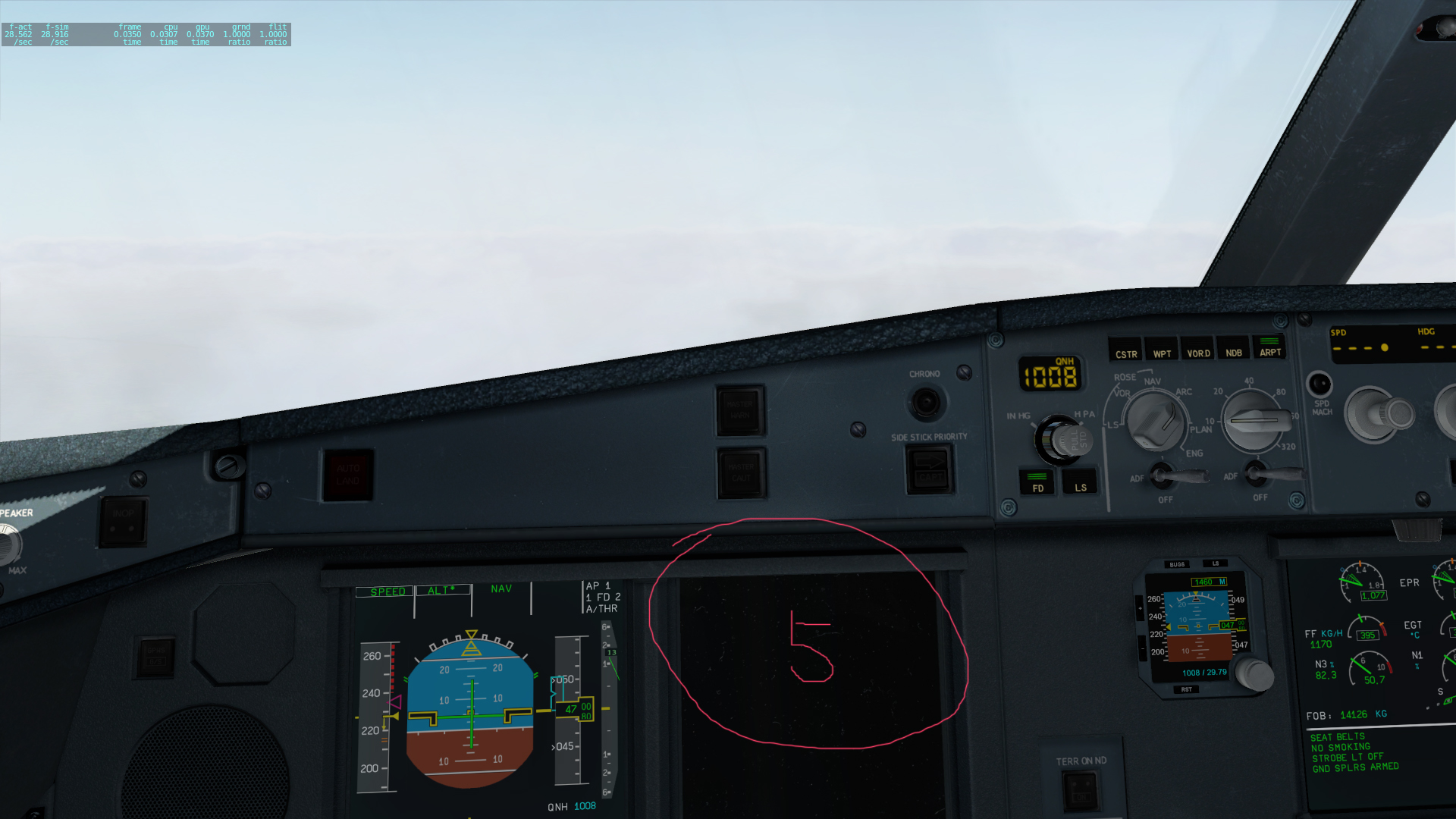

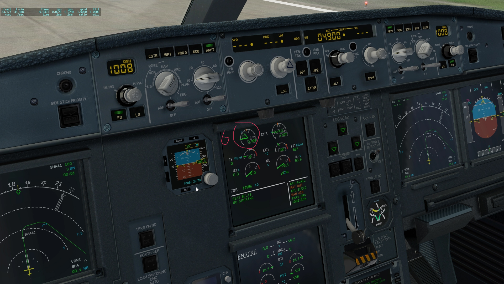

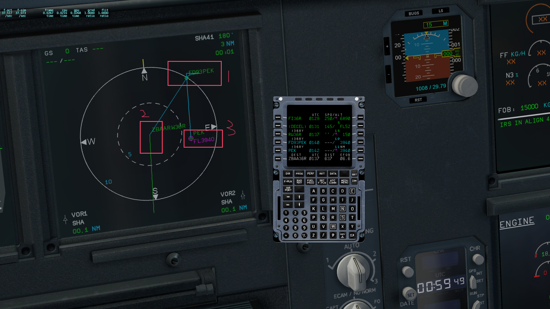

v3r4
1. ZBAA RWY36R Go-Around route - why the aircraft draws such awkward turn like that?
2. Missing runway symbol ("="symbol)
3. Alt constraints below FL100 shouldn't show "FL" - 3940ft shouldn't be FL3940 right?
4. From cold and dark, why the RAT is deployed?
5. After takeoff, the ND went out however the zoom function of the ND is still available.
6. Forget one thing during engine start - before clicking the ENG1, the EPR indication in the EWD rotates violently - I just used keyboard for my engine input, no hardware throttle control.
7. F-PLN in selected mode - the curved f-pln is still solid, but the rest of the straight lines are dashed.
I am using the latest stable version of XP11.
Please fix them in the next version.
220
shanemontoya wrote:
v3r4
1. A330 works fine to me
2. Please read checklist fot A 330 you will find in "JARDesign Group Board → Flying school, DOCs, FAQ → Airbus A330 Jardesign Checklist & Real A330 flight procedures Video" so you will correct prepare aircraft for fly
3. Your point 7 its dashed becouse you have entered heading 182 and not have in automatic position.
4. Your point 1 - missed approach route. Its look that MCDU missed to put on plan Track fix PEK, but if you fly 6 nm straight and then turn AP its all be fine. I add picture for missed approach procedure from Little navmap.
5. When you start engine start first engine, wait for that engine is AVAIBLE and then start the second engine. Throttle is in IDLE position.
6. ND go out becouse you maybe by mistake turn ND to off. Look knob on left side of panel.
7. RAT is maybe  deployed by you by mistake.
8. At the end why you are on runway width no started engines ?
9. I'll try to make fly from ZBAA to ZBAA width FPLN from 18L to 36R with procedures saw on your pictures without problem including GO ARROUND.
http://jardesign.org/forum/img/m/4390/t/p1cbone8f11knt1ku5rrv10tb1eip3.jpg

shanemontoya wrote:
v3r4
I followed all the instructions (I started using JAR when their A320 was in version 1.2 so you don't need to ask me to read about the FAQ - we wrote the operation manual in simplified chinese dated back in 2014 in Chinese x-plane portal).
My point 7 - yeah in the selected mode all the f-pln should be in dashed however only the straight lines are dashed - I am asking why the curves are not. (And from that time I have pointed out there was no dashed line in selected mode in 2014 but no one replied in this forum.)
My point 1: simply because the drawing algorithm for the f-plan and ga route is not as clever as other aircraft. Just admit the fact that it has shortcomings and will improve.
For starting the engine sequence - first engine? it doesn't matter which engine starts first - both engines indication rotates. Throttle is always in idle position. Usually we start our right hand engine first as the jetways are usually in our left side - starting engines from the right side will minimize the risk of potential damage to jetways if the engine on the right side fail/or catch fire.
ND went out - come on I didn't touch anything.
RAT - again I didn't touch anything.
On runway without engine started - simple. I respawn on the runway just to test the aircraft. Are there any problems?
Please, focus on my findings.
And thanks for the map however it's rather useless to me. As the RL airline guy, I have the latest and full set of charts for ZBAA published by CAAC and my company operates about 20 flights a day to ZBAA.
Anyway thank you for your reply.

Franz007 wrote:
@Homer and Ilankrt: i doubt Simbrief is an accurate base. Or do you seriously think its more accurate than PFPX? Without comparaisons with real tables like i've done its useless. And below 3 hours of flight its also quite useless since the main difference appears during cruise. And on short flights you wont remark that difference because 5%-7% could be also because of winds differencies or differences in take off / approach performances. So its not an accurate way to compare.
Anyway: it was about the A330 and not the A320 (to Ilankrt)
So as long as nobody can show that the values are correct based on REAL tables like i've done, do we have a chance that these wrong fuel burning values will be fixed in future? But as it seems there are no developpers reading here?
Today I did another fuel test flight. Duration: 6,5h of flight. As source I used a real world OFP for an A330-243 and simulated the flight which took place at the same time.
As per OFP I should have used 31100kg.
As per vacating the runway I have used 27600kg, so only 89% of the planned trip fuel
AT the middle of the flight I only used 93% of the fuel I should have used.
So I'm still not getting your results.
