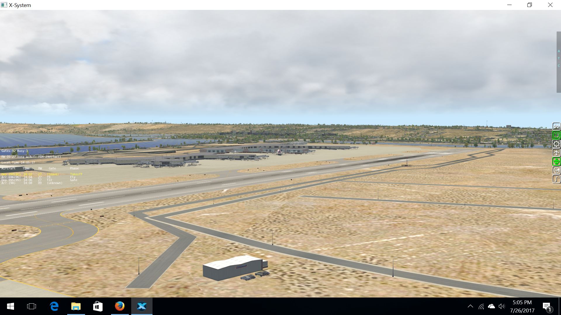

I have been having issues with planes not appearing at gates upon arrival. Here at KSAN there are 92 gates available but only one in use. For whatever reason the traffic does not fully load or render. Anyone else have this problem? Slider gate percentage set to just under 40%

I have been having issues with traffic not appearing at airports upon arrival. Here at KSAN there are 92 gates available but only one in use. For whatever reason the traffic does not fully load or render. Anyone else have this problem? Slider gate percentage set to just under 40%
Indeed not traffic at all !!!
http://jardesign.org/forum/img/m/1591/t/p1bm0ik7didik1b1q1pbn1am91tqf4.jpg
