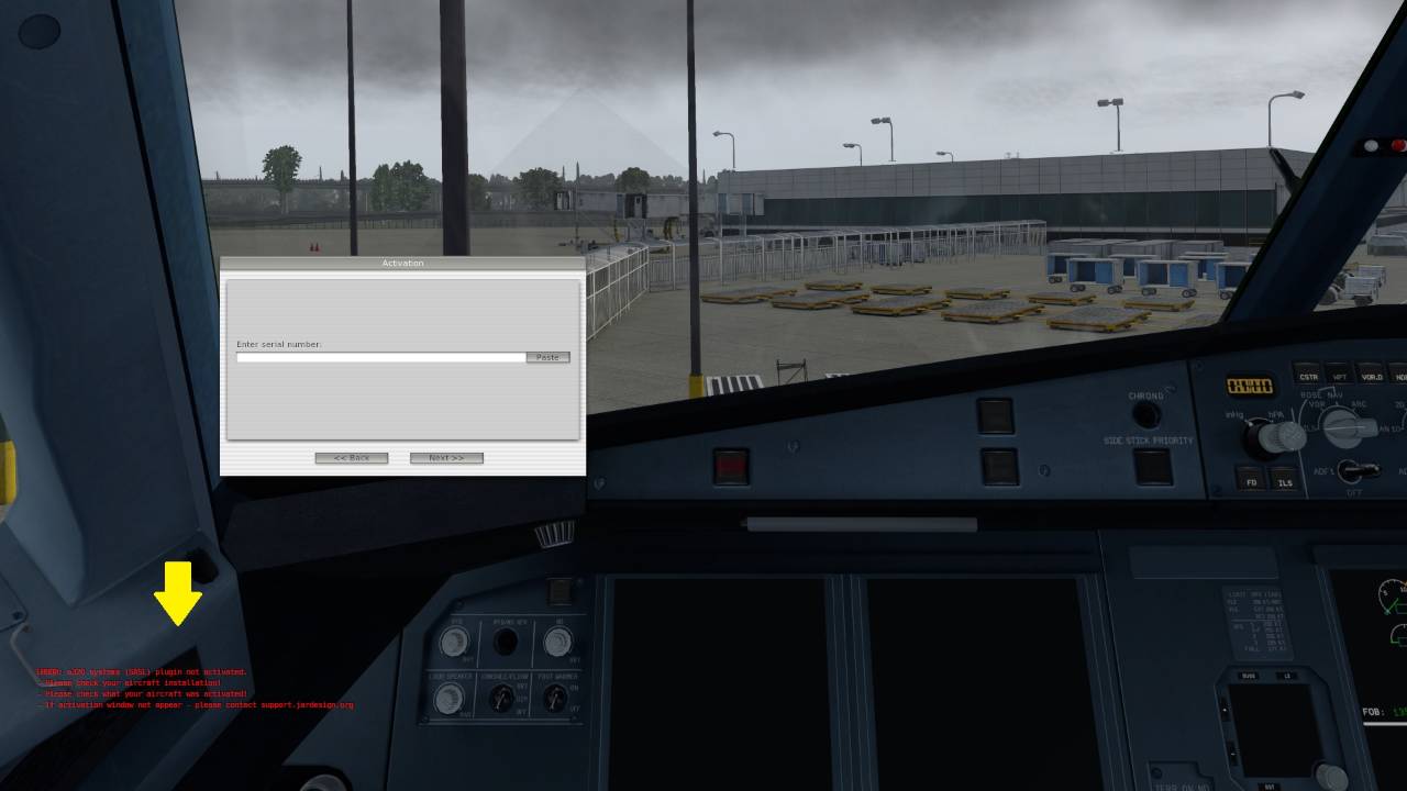

I can not activate the JarDesign A320neo beta in X-Plane 11! I already deinstalled all plugins and checked but it didn't work! I have the latest navdata cycle and my serial number is valid as well. As you can see in the image I get this error message and I can not see the sasl plugin in the upper bar - but I enabled it! I have no idea how to fix this - can someone please help with this problem!
If you can not read the error message,
It says:
ERROR: a320 systems (SASL) plugin not activated.
- Please check your aircraft installation!
- Please check what your aircraft was activated!
- If activation window not appear  - please contact support
Thx!

Are you using old or new key?
philip-freitag wrote:
Hello everyone!
It says:
Thx!
235
Re: ver.3.0 beta 2,3,4,5,6,7 for X-Plane 11
I use a new key.

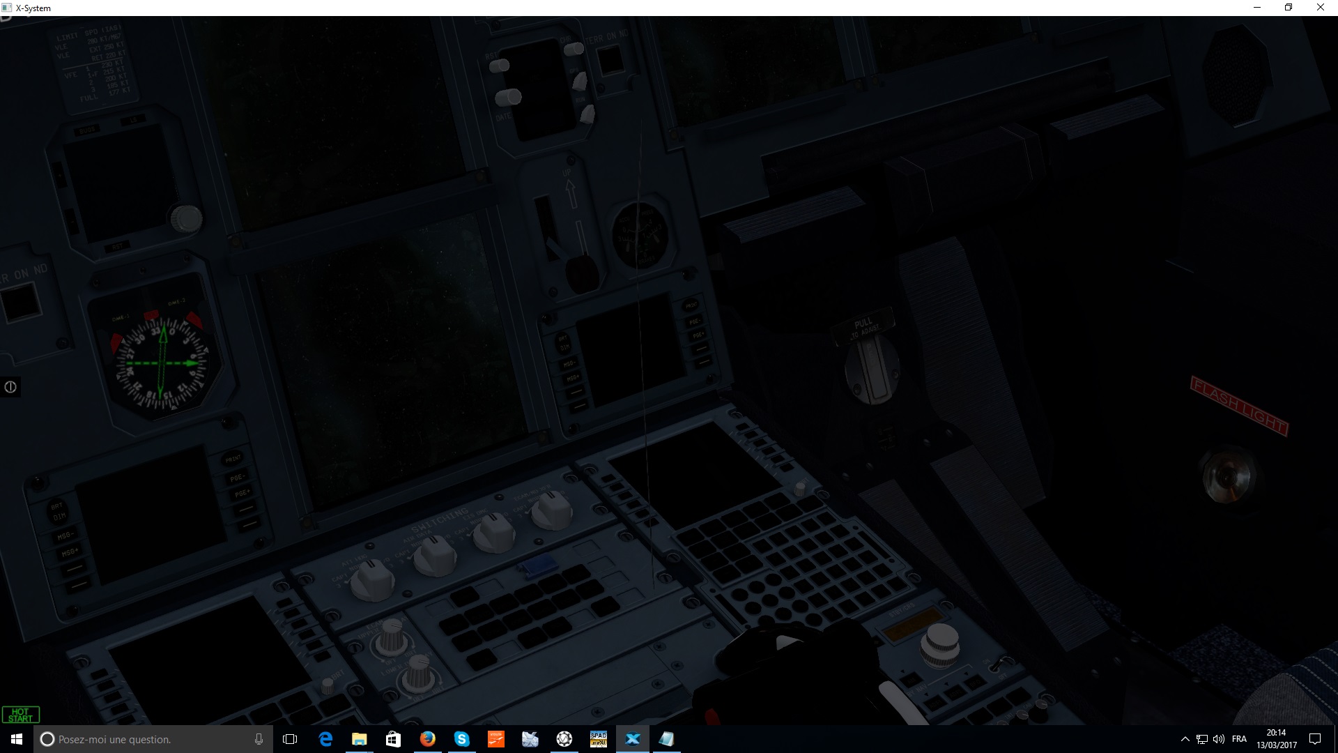

you have like a broken glass in the middle of the cockpit
Please attach log.txt. I'm not seeing this in my A320...
247
Hello Eugeny,
This is part of seat in view area.
