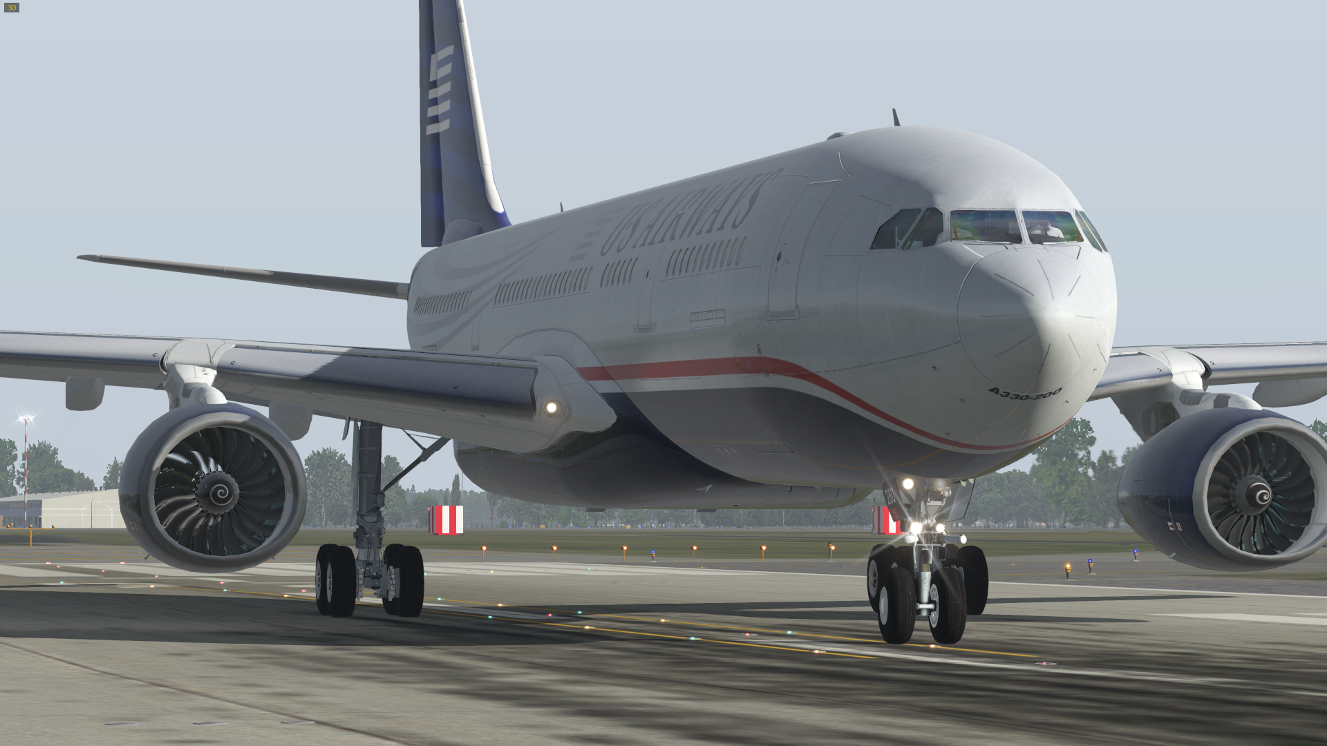

Just one minor visual detail, engines seem empty smile

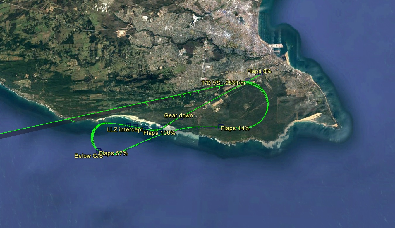

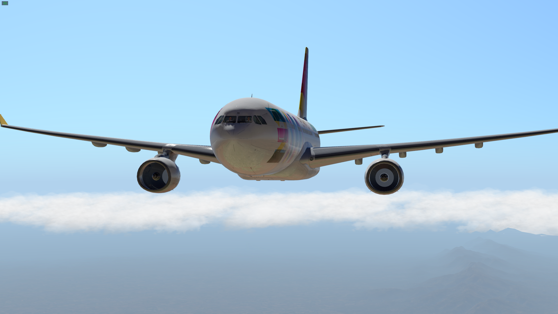

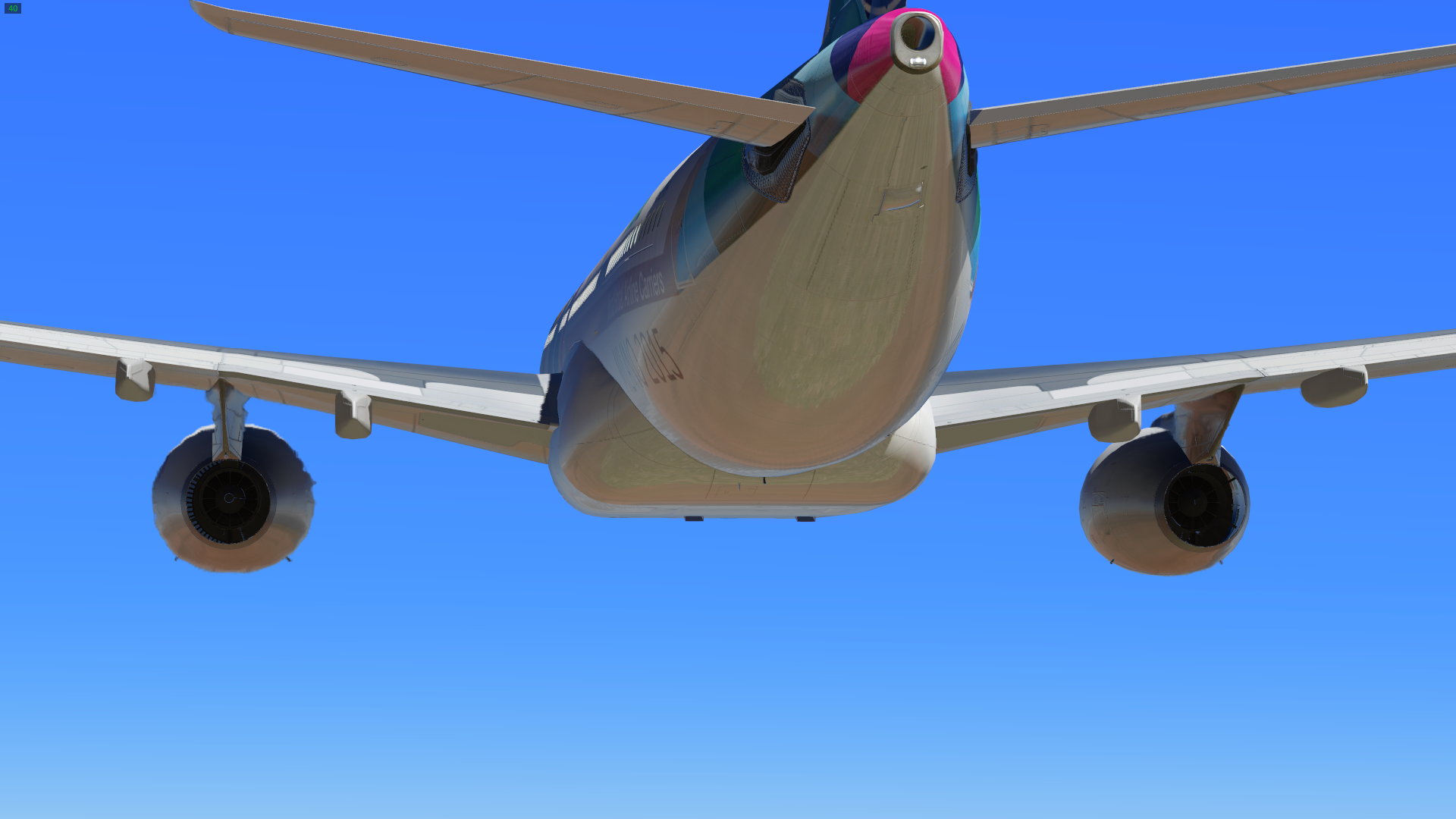

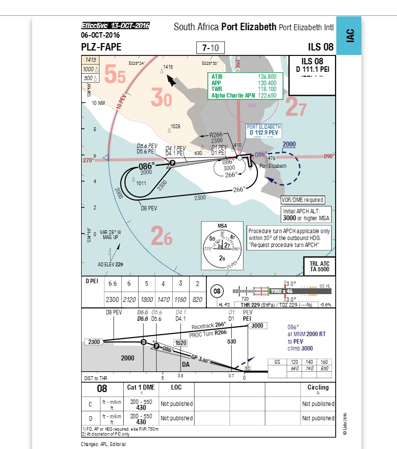

I did a flight between FACT to FAPE , XP 11 PB5
1. Engines are see through from the front
2. The STAR is drawn incorrectly , Navigraph 1701  Flight Plan OKTE1C OKTED UQ12 XUGOL UQ56 OKSET DCT PEV DCT " PEV1 " transition for RWY 08
As you see on the Flight log the aircraft tried to fly it correctly ,  : )
3. Still cant enter any DH above 200 , as it always shows 200 on PFD
4. There was an Issue with after lading at gate the engines would no shutdown , had to switch fuel pupms of the kill engines ..
