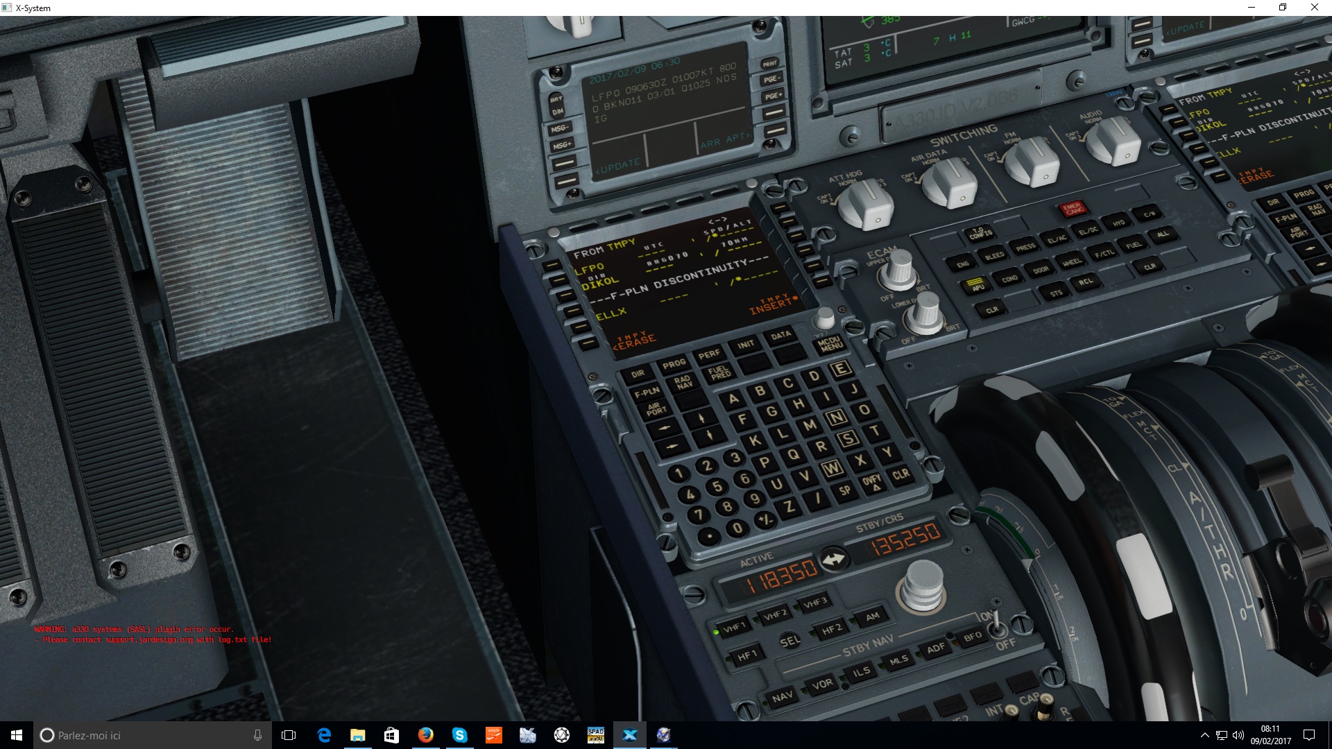

It ask me to contact support for bug SASL just after i type DIKOL and paste it on LFPO.

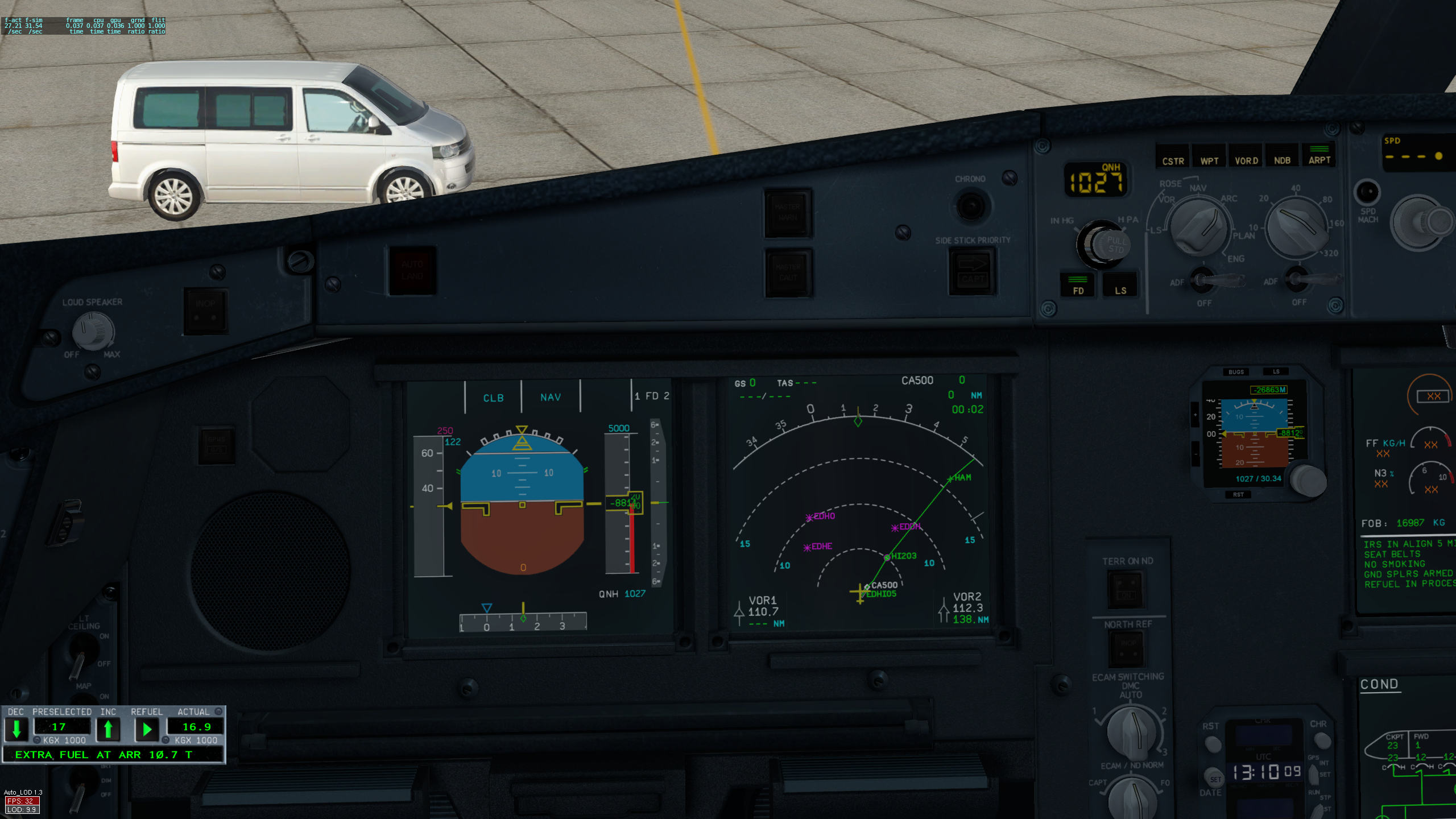

Hello Guys,
I´ve two problems:
First problem: I´m on the ground and the PFD shows me a altitude of -8800ft.
Second problem: When I give a little bit thrust, the PFD shows me after 5 seconds 300knt+ indicated and I´m very fast airborne - not flyable. The Secondary Flight display shows me the correctly ground speed.
My system:
Mac OS X 10.12.3
A330 V2.0b6 - X-Plane 11 pb10
Saitek X52
Greets Max

To your first problem: I think that your QNH was wrong? (see if  airport altitude is the same as on PFD...)
Second problem: maybe you have to calibrate your thrust levers (Saitek?) probably they went to TOGA ..  Weird...
