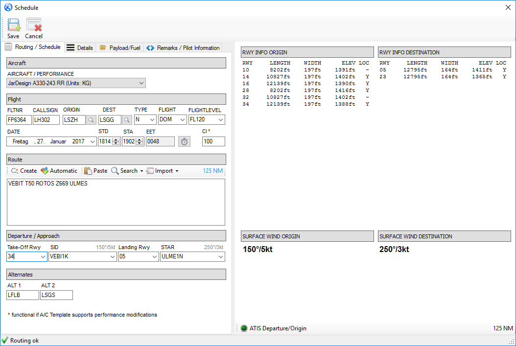

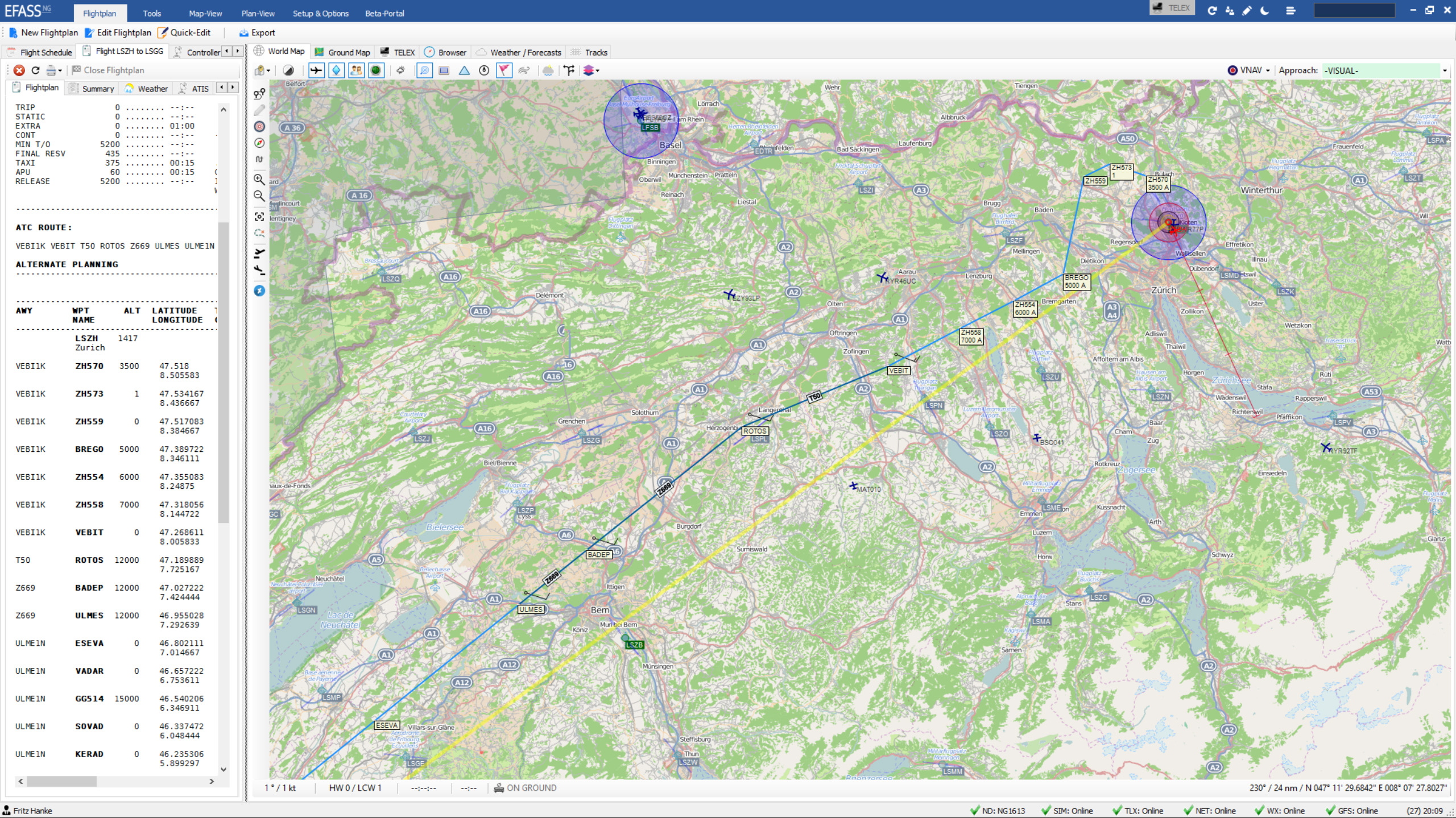

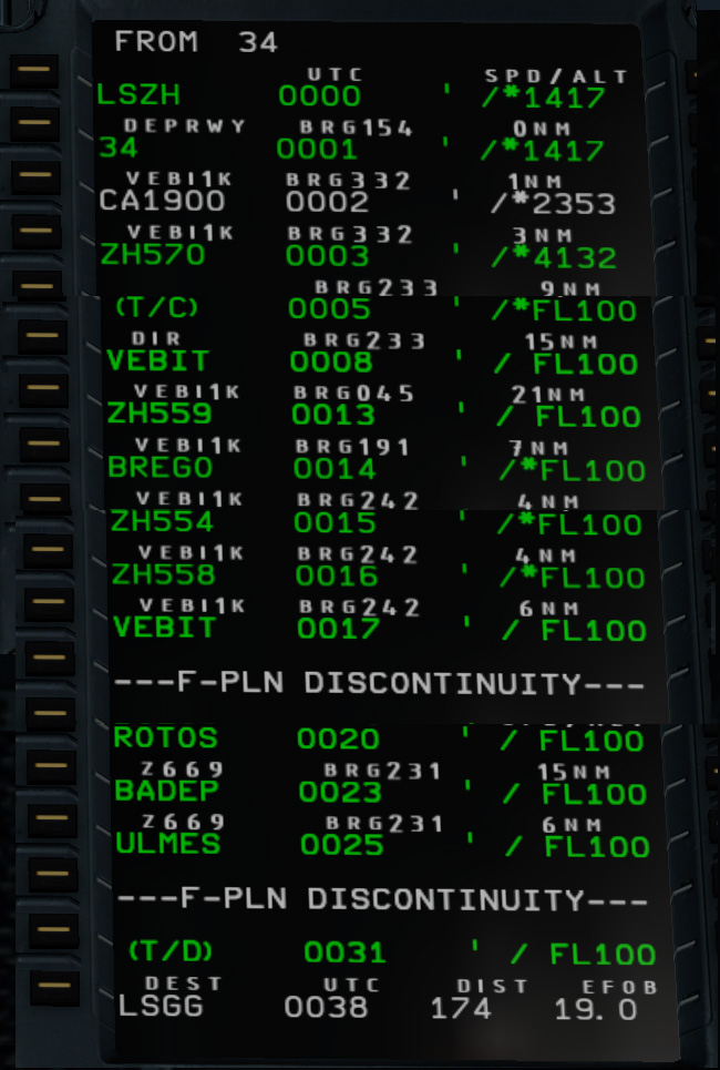

I see a strange behaviour entering a SID to my flightplan LSZH/LSGG. I attached the EFASS NG data for the flight with chosen SID VEBI1K. On the EFASS Map you can see the SID route from runway 34 up to VEBIT.
If I load the company route LSZHLSGG.txt into the a330 it logs:
new fpln full = 1 LSZH (APT) >>> 2 (T/C) (pseudo) >>> 3 VEBIT (WPT) >>> 4 ROTOS (WPT) >>> 5 BADEP (WPT) >>> 6 ULMES (WPT) >>> 7 DISC (DISC) >>> 8 (T/D) (pseudo) >>> 9 (DECEL) (pseudo) >>> 10 (SPD220) (pseudo) >>> 11 LSGG (APT) >>> DIST=124.80117
After I entered the VEBI1K SID it logs:
new fpln full = 1 LSZH (APT) >>> 2 34 (DEP_RWY) >>> 3 CA1900 (CA) >>> 4 CF341 (CALC) >>> 5 ZH570 (WPT) >>> 6 (T/C) (pseudo) >>> 7 VEBIT (WPT) >>> 8 ZH559 (WPT) >>> 9 BREGO (WPT) >>> 10 ZH554 (WPT) >>> 11 ZH558 (WPT) >>> 12 VEBIT (WPT) >>> 13 DISC (DISC) >>> 15 BADEP (WPT) >>> 16 ULMES (WPT) >>> 17 DISC (DISC) >>> 18 (T/D) (pseudo) >>> 19 (DECEL) (pseudo) >>> 20 (SPD220) (pseudo) >>> 21 LSGG (APT) >>> DIST=175.24187
This is obviously wrong; it passes VEBIT twice and makes a large circle increasing the distance of 124 miles by more than 50 miles. You can see the circle in the a330 display.

This happens from time to time with EFASS (I use it frequently).
I suggest you check that  EFASS airac and A330 Airac are the same .(May be you have already checked that)
To see the profile (top view) of flight plan place the view on plan(not on arc as during flight) and starting from departure Airport of FPlan on the FMC go , step by step , to arrival Airport looking at th same time at the screen showing the route . That way you can see where you have to adjust your plan erasing what is wrong .
Hope this wil be useful (and understandable)   smile

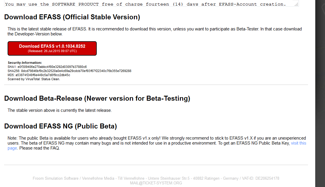

you are using Efass NG public beta version...
"The beta of EFASS NG may contain many bugs..." see warning message on pict attached from efass web site

To enrigolan and jcdp: EFASS is beta ! I mentioned EFASS only because there you can see the correct route based on the VEBI1K SID. If I use the "same" company file in the Boeing767PW-300, everything works ok and there is no problem. The whole thing has nothing to do with EFASS NG.
If I use the "same" company file in the a330 (a330 loaded it without any problem, you can see the route I copied from the Log.txt) and choose the VEBI1K SID, the a330 sw creates a complete nonsense route. I showed the nonsense route in my post copied from the Log.txt.
I assume this is a normal bug in the a330 sw which has nothing to do with X-plane 11. If you have a company route, where the first waypoint is identical to the last waypoint of the SID, the a330 sw creates complete nonsense. I assume in real life the device can handle this case like the Boeing767PW-300 sw and the EFFASS NG sw does.

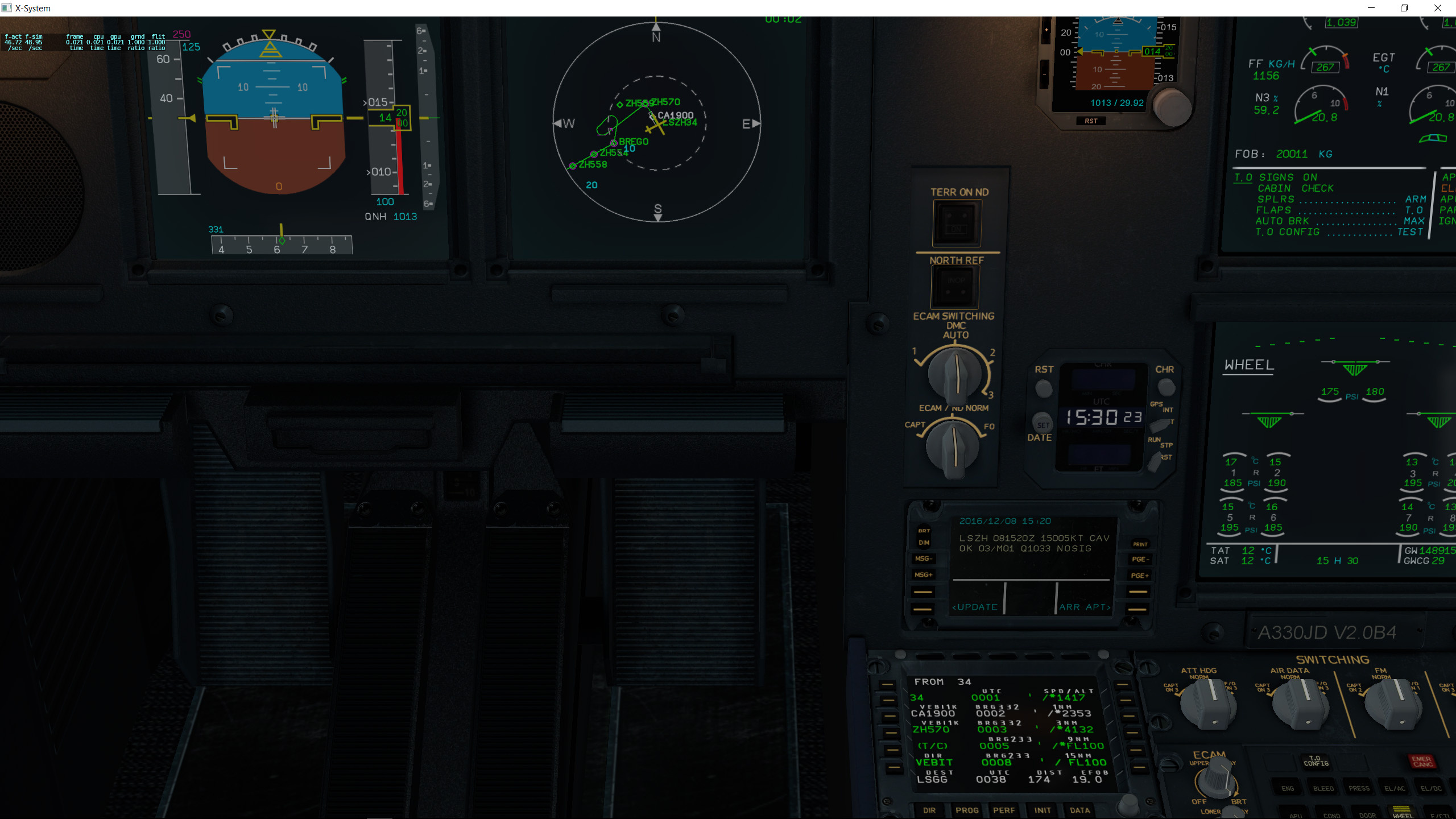

1 You missed some steps for preparing the aircraft for TO
2 the aircraft has also not enough fuel on board
3 before take-off you ignored the warning T.O. Inhibited
4 after disengage AT you got blue messages (configuration for landing, gear down, flap full Landing configuration - Test
So what are you expecting from the AP to do after this mess....
1:
Which steps? Help others and me to understand, what you mean. Otherwise your statement adds no value here and looks like it's just to bash myself... And note, that I paused the recording after programming the MCDU to keep the video file small and having a high resolution.
2:
Pilots decide by law, how much fuel they take on board. Even if they potentially risk their job or going to jail if something serious happens. Nobody else. 4,000 kg fuel are not much. But should be sufficient for a traffic pattern. By the way, this flight was just to provocate the unintended and automatic activation of the approach phase shortly after getting airborne.
3:
Well, I took off. No strict inhibition though. But I agree, should for sure be avoided. Be so kind and explain us why the takeoff was inhibited? I shared another video with the developer (Eugeny) which can be found here: https://www.youtube.com/watch?v=IopwzH7_W2Q. I took off having the same T.O INHIBIT message. I expect Eugeny to concentrate on such detail, if it plays that role. We considered this video, we spoke/ wrote about my observations, but the inhibt message hasn't been mentioned by him.
4:
Yes, but why? Makes no sense to me. I mean I understand where it comes from. But is it the real behaviour? I don't know, might be. Difficult to investigate without having access to a real A330 and the chance, to make such a "flight". But can not imagine, that these messages disappear after 5 sec as shown in my video (beginning at minute 03:33).
