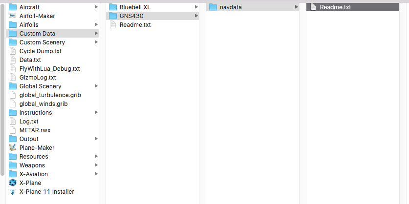

435 (edited by cram 2016-12-06 08:08:22)
Re: X-Life ver 1.1 (r1, ++)
My log.txt
http://marcpalencia.com/Log.txt
Yes, i have GNS430 in Custom data:
Thanks you so much!!!
Attachment icon Captura de pantalla 2016-12-06 a las 8.54.27.png 63.5 kb, 197 downloads since 2016-12-06
Well, in addition to many other problems, the one that is most likely to cause XL to quit is the fact that you don't have any navigation data in your navdata folder. They absolutely need to be there!
Sorry for my question , but...
Where are the "navigation data"?? In X-plane 10 I do not remember having to do anything
Tnaks!!
438
I found it!!
My folder with navdata it was in "resources/ plugins/ GSN430.
Copy the folder in X-plan 11 and work perfecti!!!!!
Thank you very muuch!!
I hope I hepl to others users...

Is copying the NAV folder the only thing we have to do to make X-life work for XP11 PB3? Love the program.

XL: 0 : OpenSceneryXpath find: C:\x-plane11\X-Plane 11\/Custom Scenery/OpenSceneryX/
XL: 0 : !!! Error: Cant read file C:\x-plane11\X-Plane 11\/Resources/GNS430/navdata/airports.txt
XL: 0 : !!! Error: Cant read Ats file
XL: 295 : X-Life plugin ver.1.1r6 061116 detect crash.
If you still got X-plane-10 Installed  Go into   Resources folder, Copy folder GNS430 and paste into X-plane 11's Resources folder.  This should solve your problem.
Please read the forums people already mentioned about this. Thank you.
