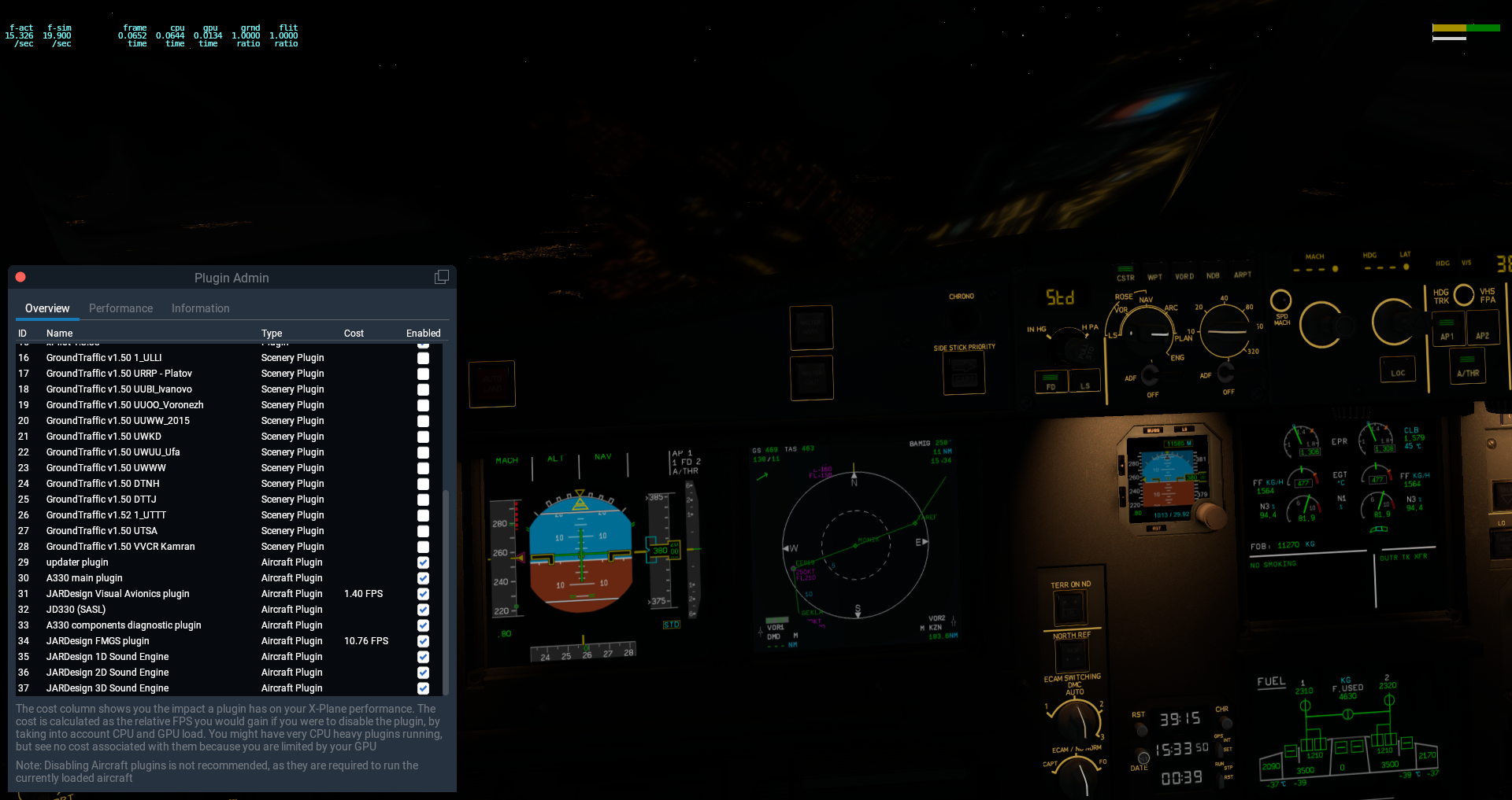

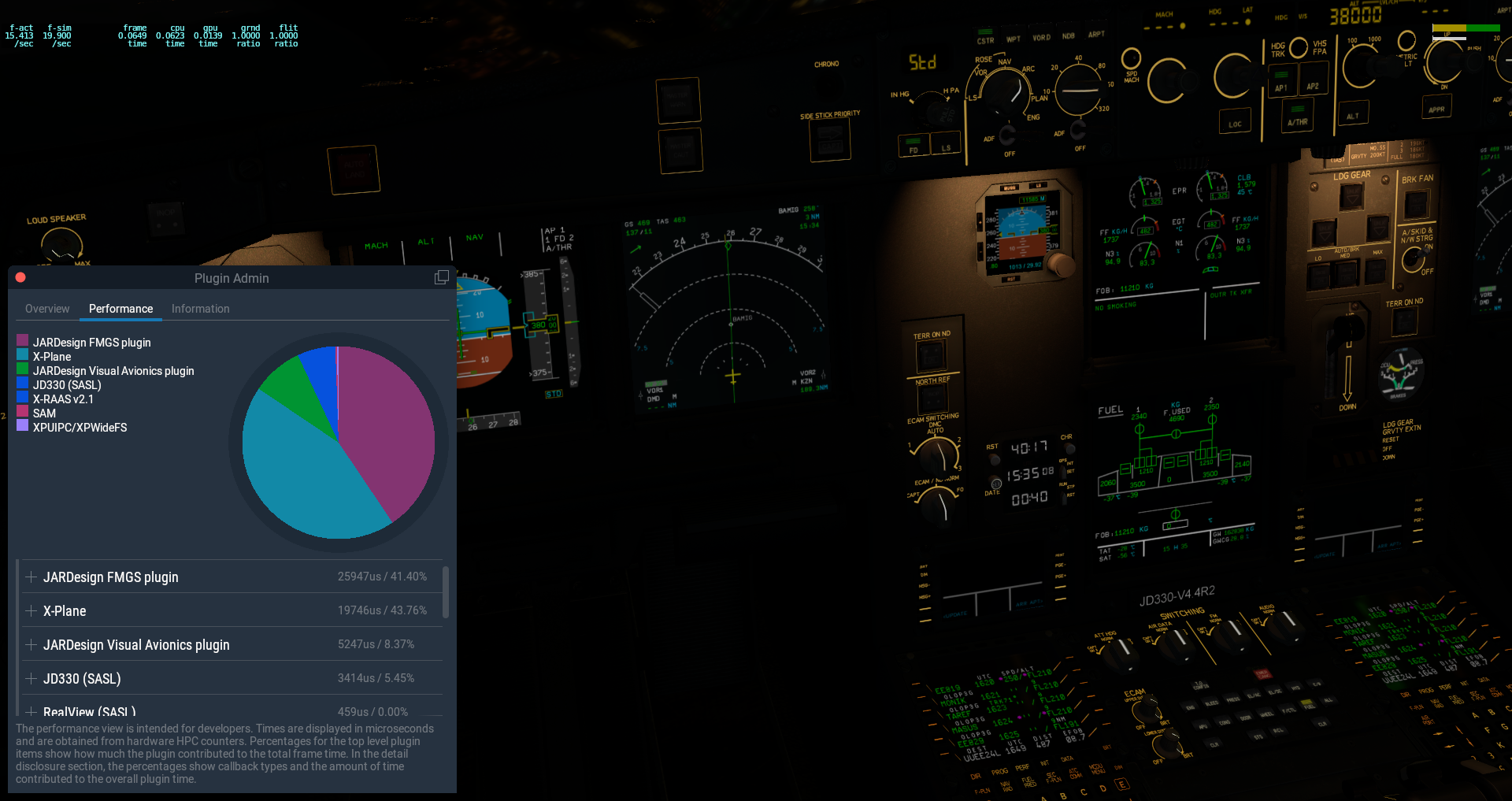

Good afternoon! Now the plugin has taken FPS on the echelon. What should I do?

Is it possible to send to www.support.jardesign.org Log file saved just after fps drop happen to check details?
Re: XP11.50 JD330 v.4.4
Good afternoon! unfortunately, it is not possible to provide a log file. Next time I will definitely send it. Thanks for the answers
