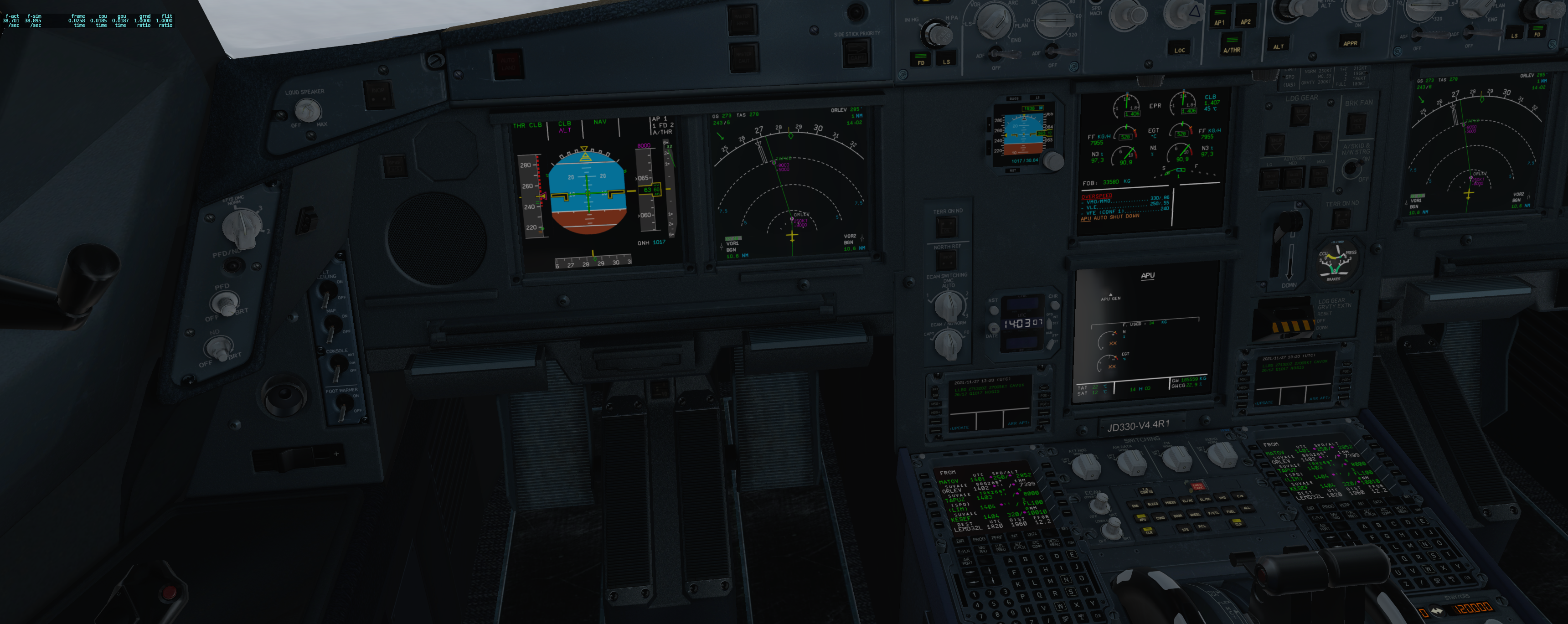

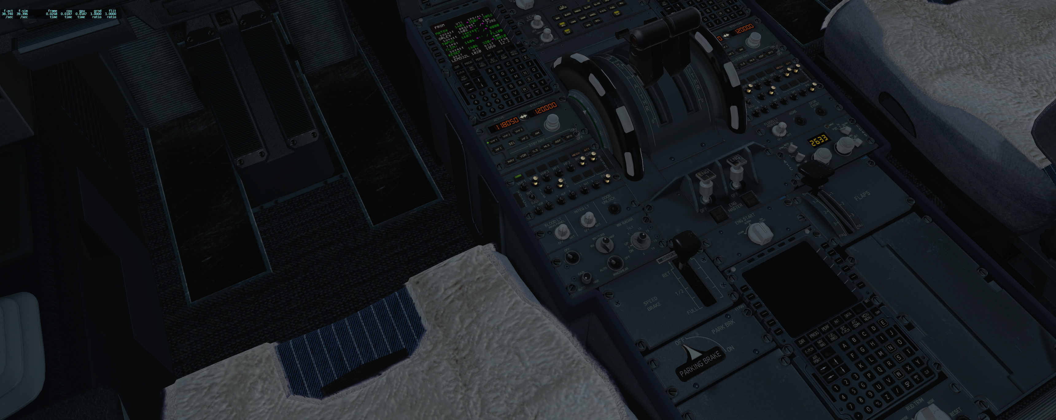

IRS Align time is still wrong. It says it needs 6 more minutes but PFD shows data supplied by an aligned IRS. (after 2 minutes). And looks like it is possible to align IRS systems while the switches are in OFF position.
http://jardesign.org/forum/img/m/12096/t/p1fm8e0ait1hao1n81kqm1ahafuh3.jpg
http://jardesign.org/forum/img/m/12096/t/p1fm8e0aiu1vh6i2lifcu9mb9q4.jpg

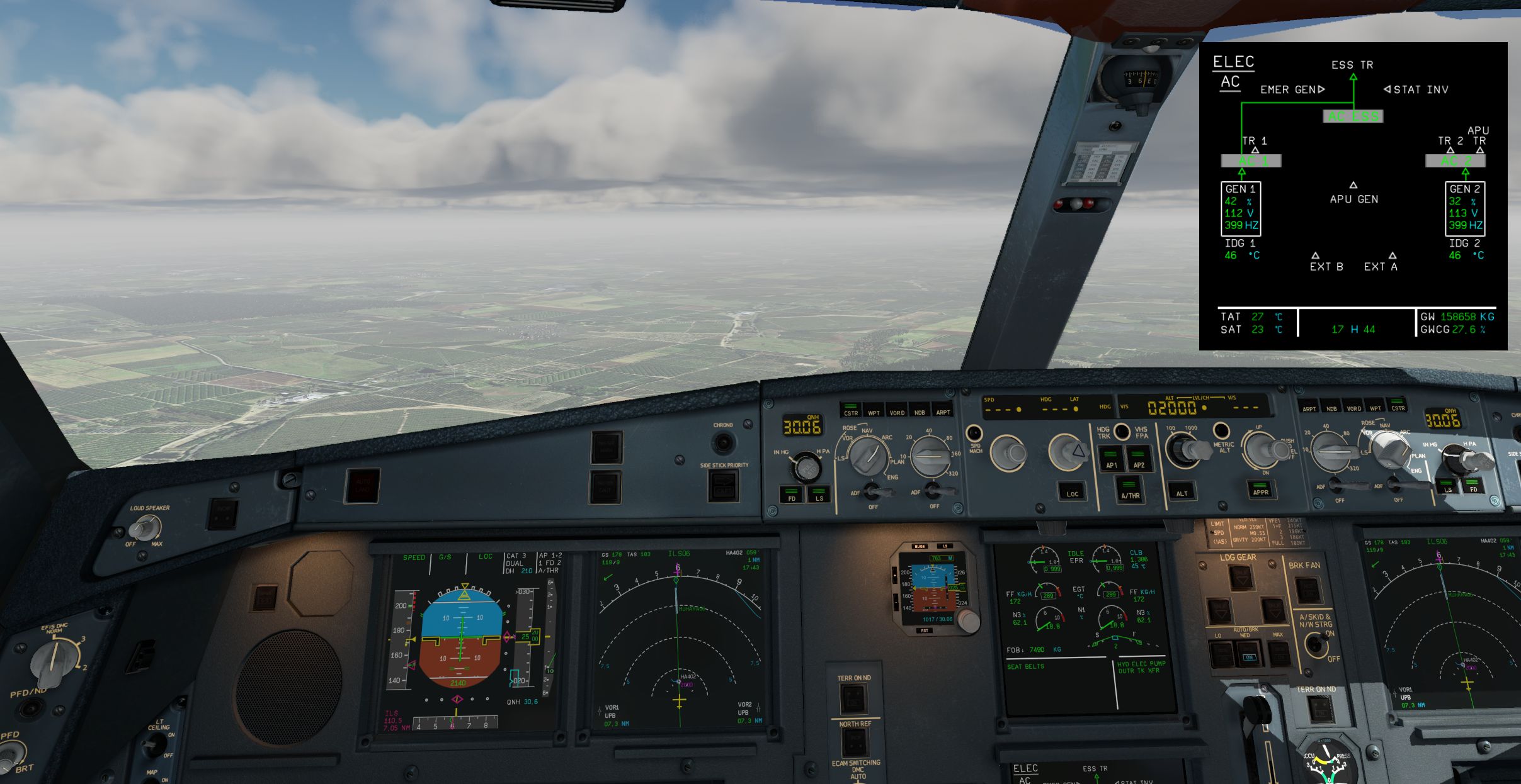

Need just check ELEC page during flight/approach/landing
48
Re: XP11.50 JD330 v.4.4
Here are more information:
Before Landing (everything is okay and looks good): see attached file
After landing:
http://jardesign.org/forum/img/m/12935/t/p1fpsa3p241vbq192g13tj1102log5.jpg
This happens right when I activate the reverse thrust.

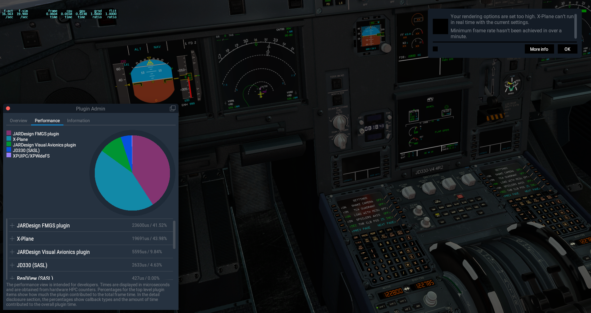

Good afternoon! I have a problem with fmgs plugin. When entering the PERFORMANCE tab, FPS drops from 30 to 18 and 12 FPS is occupied by the plugin. I can't attach a photo. Writes exceeded the size, and the size is only 2 MB.
Seems like it's some sort of special issue. Sure, you can contact me via skype j.a.romanov for direct help - we will check this issue online. You may call anytime when my skype label is green.
