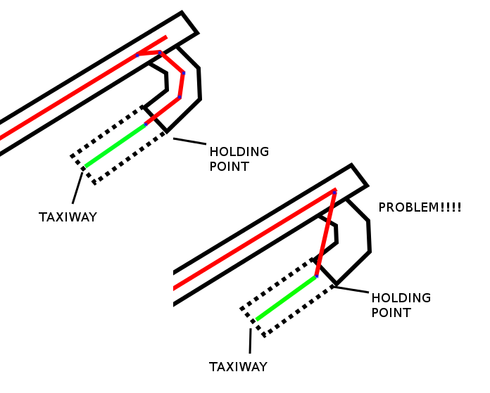

As I wrote in the previous post, I had constant crashes. I think I have localized the bug as I noticed X-Life crashes everytime when an aircraft stops or approaching the holding point before takeoff. The taxiroutes Ihave built for ESGG have several route-lines (which is set as runway taxi routes, red color) from holding point to runway main taxi route, and I think that is the main problem.
I think I understand now that X-Life sets the holding point automatically for the first non-runway taxi route connecting to a taxi runway route, or more easily explained, it prefers just an one long red runway taxiline. So I did remove all the red taxi routes connecting with the runway taxi route, and replaced them with just one normal taxiroute from the preferred holdingpoint. Now everything works perfectly with no crashes.
The downside with this is you cannot create nice curved taxiroutes on to the runway if your holding point is far from the runway, according to some charts.
I hope you understand.
Need check ATC-taxiroutes for this airport. This may me a reason.

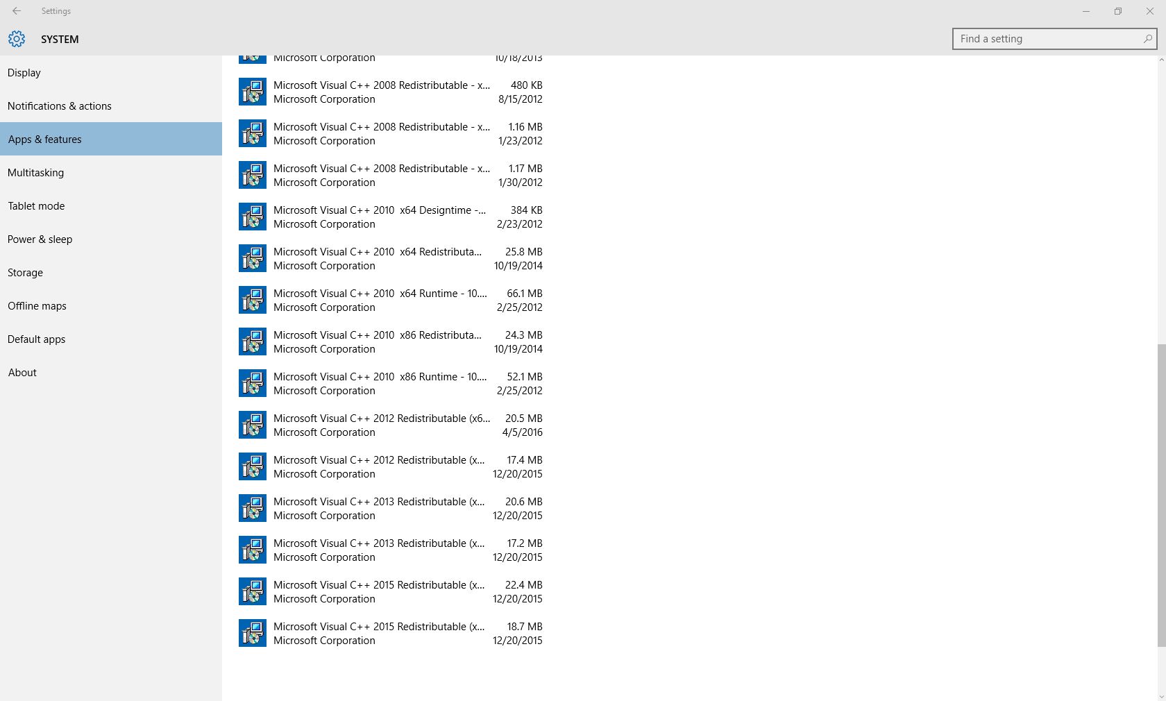

Hello all,
Whenever I start X plane, X Life doesn't load and gives me this error:
/X-Plane 10/Resources/plugins/X-Life/win.xpl : Error Code = 182 : The operating system cannot run %1.
I am using Windows 10, X plane 10.45r2.
Any ideas what this could mean?
61
Captkittyhawk wrote:
Hello all,
1. Check what you use computer under Admin mode and with 64 bit mode.
2. You use Windows 10. In this case, please install "Microsoft Visual C++ Redistributable 2010" pack https://www.microsoft.com/en-us/downloa … x?id=14632

Thanks for the tips, but it still doesn't work; when I downloaded the 2010 redistributable pack, it said I already had a new version installed. I double checked, and it looks like I have versions 2005 to 2015 (both 32 and 64 bit). Do you think they are conflicting with each other?

65 (edited by Vantskruv 2016-04-06 08:05:49)
Vantskruv wrote:
Me blablabla....
I want to clarify the problem visually. I've attached an image.
As you see, if you have holding point at a further distance from the runway in a curved taxiway, you will not be able to create a holding point if you do not want the aircrafts to take shortcuts over the taxi-line. This will be a problem if the holding point is automatically identified as the the beginning of the last taxi-line to the runway.
Also, if ever a holdingpoints for ILS-areas will ever be implemented, this would greatly worsen the problem.
Actually, forget it, I think I solved it anyway, as it seems now it does not crash. You where right Romanov, it seemed there was some problem with my routing, but sadly I do not know how I fixed it.
Anyway, how do you define taxiroutes with no name? I've several small taxiways joining up on a big apron. What should I do about the taxiroutes on the apron? If I name these routes to nothing, ATC tells me to taxi via 'non'. I then name these routes to 'Apron', which ATC pronounced to 'Alpha pron'. lol
