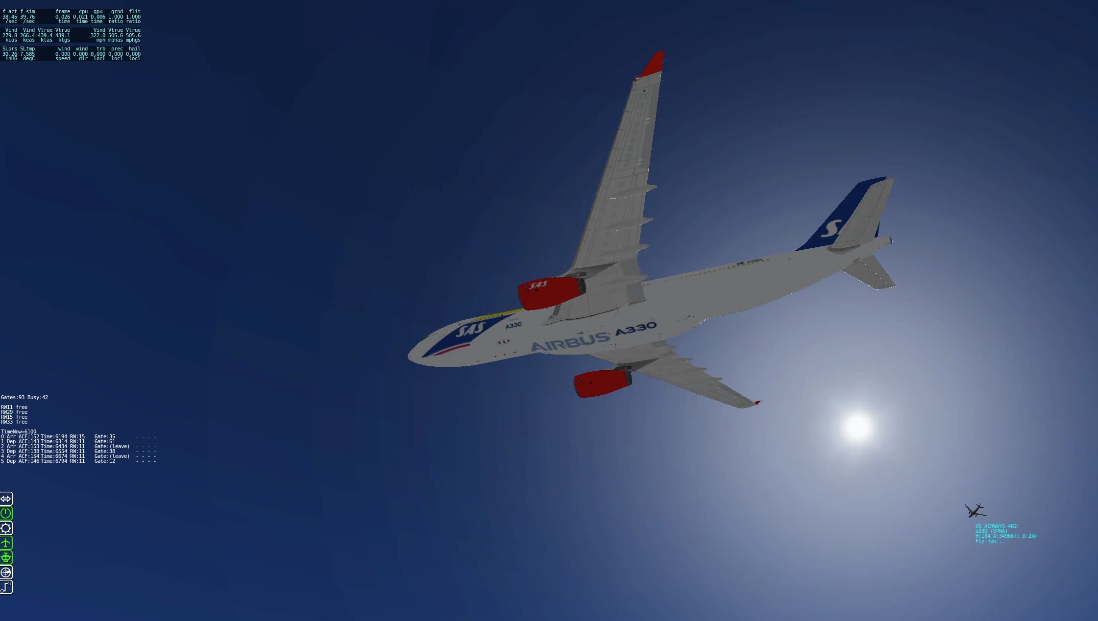

27
http://jardesign.org/forum/img/m/1591/t/p1afb9dmp6ioa1laj16fd10971lpm3.jpg
28 (edited by ThommiTechnik 2016-04-02 15:38:14)
Wow! I will talk to ATC smile Need think about it.. may be need change some in code..
You won't believe, what happened today at LSZH: Edelweiss 140, you're number 2 after Airbus A320, waiting time 7minutes big_smile big_smile
