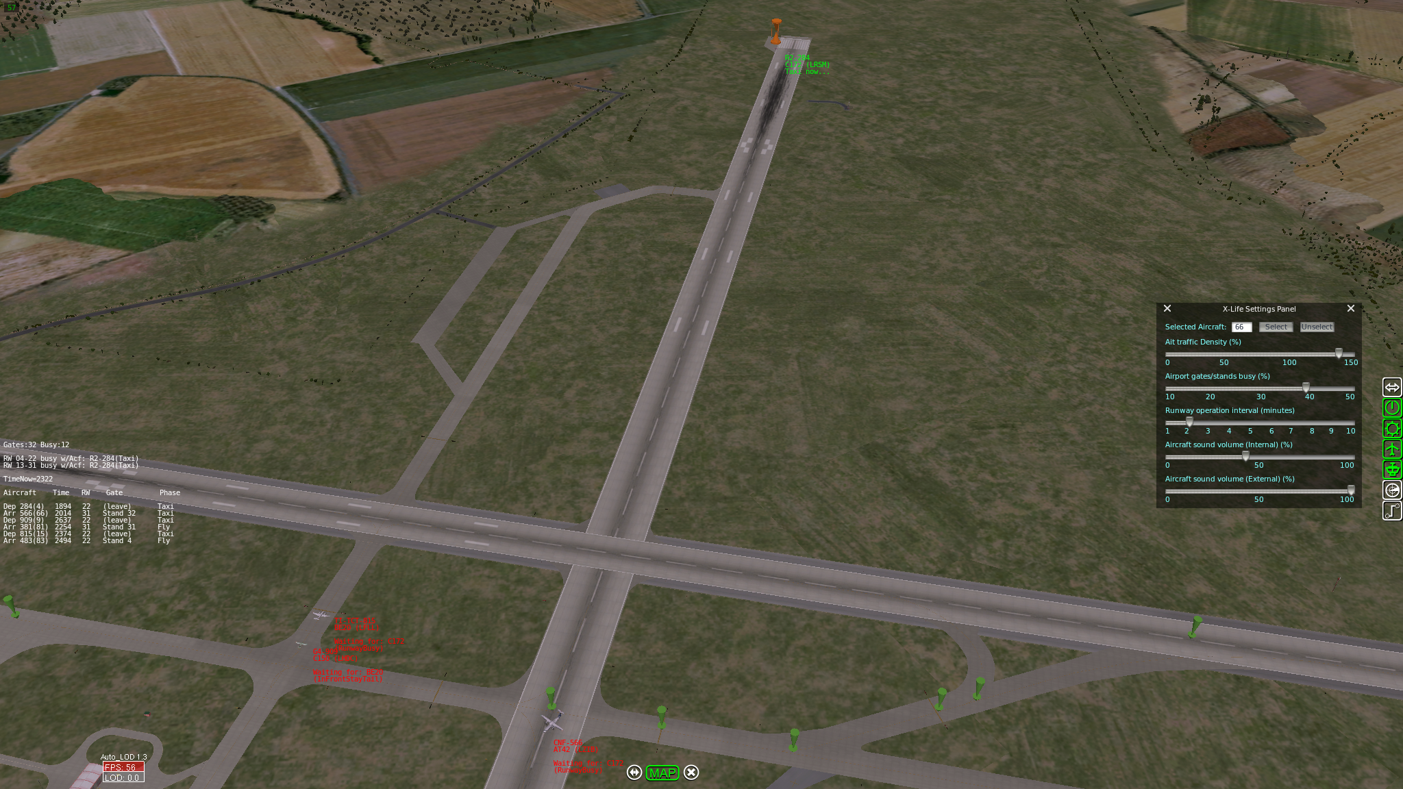

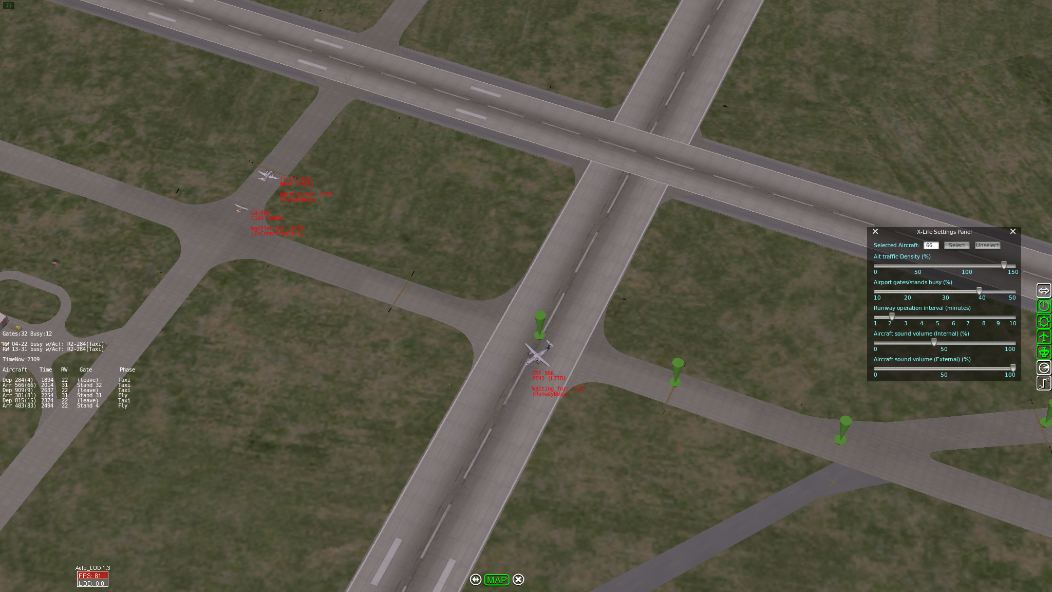

X-Life beta (BlueBell) 6 ver 1.1crash:
JAR A330 1.3b1
LFMN-LEGE
Everything normal until arriving at holding runway 4L (as directed to)
Held for 15 minutes and I decided to takeoff anyway since 15 minutes is way too long...
After retracting gear, atc says continue taxi, I then press repeat and then crash.
all logs attached

this is what you need too do when you are told to hold short,
1) open your radar so you can see the other aircraft in the area and change the range 50NM
    this will show you the aircraft inbound to the runway that you are going to be taking off from.
2) close the radar screen and open the ATC, then let it close and wait for the ATC to give you clearance.
    This process works for me when I get a command hold short and you will get a CTD if you do not wait for the ATC to clear you from the hold short since, the string command is broken in the ATC.

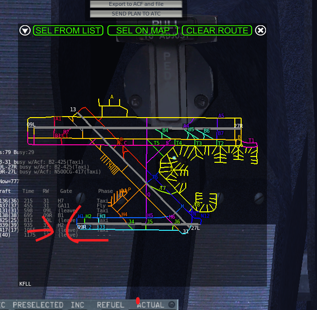

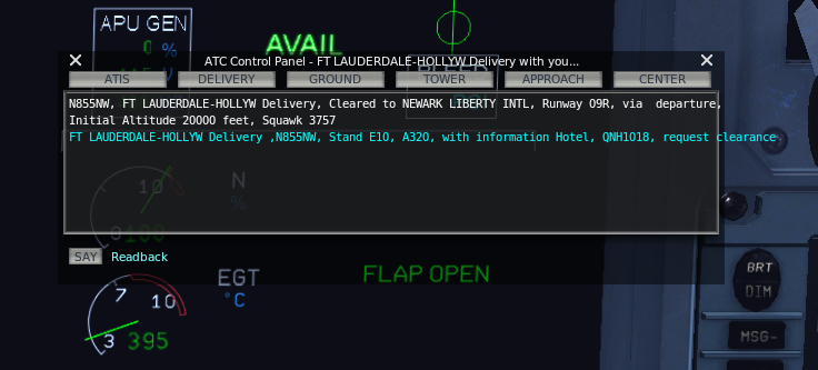

442 (edited by captbullett 2016-05-15 17:24:05)
as I was saying in the post above the ATC cleared me to use 09R at KFLL to KEWR and the runway did not show-up on the MCDU list.
first time I had this happen to me.
Since this is a Nav data issue JAR I am sending you My Nav data the ATS.Txt ...
should help you sort out any bugs.

bug in x-life logic -> see pics (LZIB)
CNF-566 is waiting on runway for taxi, while C172 is taxing to starting point
