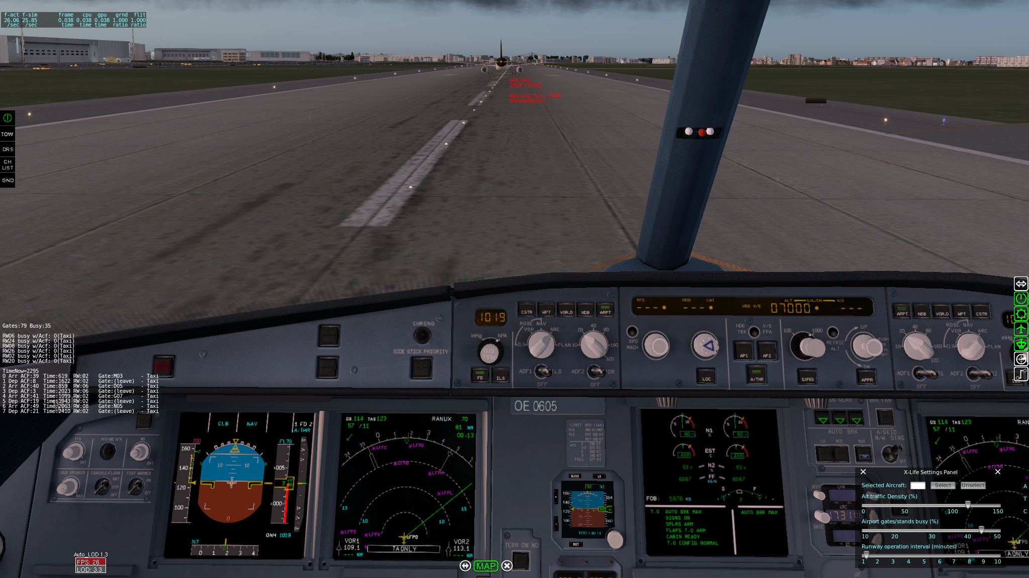

oops, while departing in LFPO (Orly) on RWY 02 in front an stopping aircraft. I did it with 25°, starting over the aircraft, but i think there is a small issue
-> see pic
