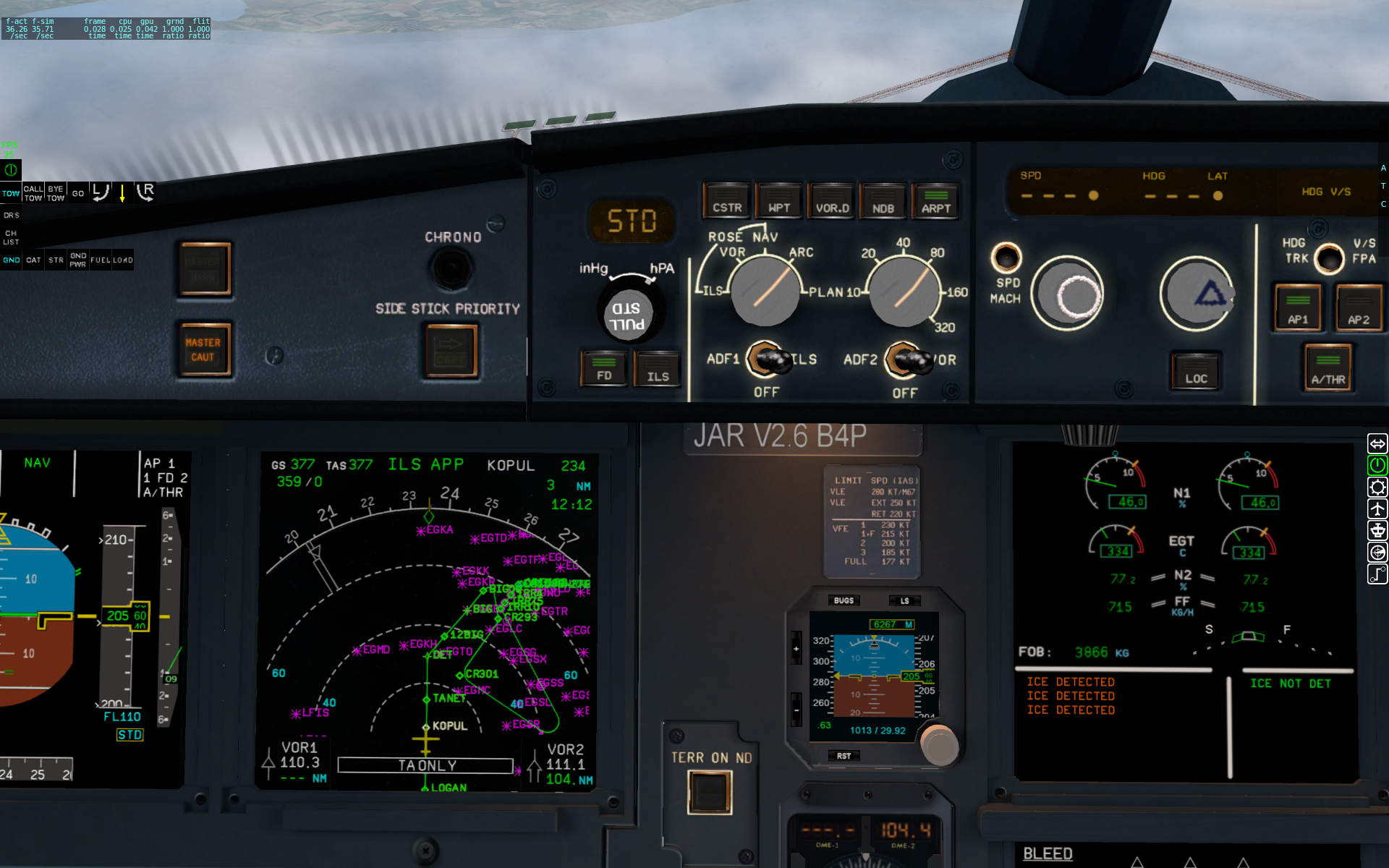

Successful flight from EHAM to EGLL. All aspects of the ATC worked fine, no CTD. Not much traffic at EHAM even though I had set it to maximum but there was lots at EGLL.
One issue - I was given STAR BIG3E by ATC. When I added this the FMS the resulting route made no sense and took me on a strange loop. I had to fly the approach manually looking at the real world chart.
Files attached for info if it's helpful to find CTDs for others.
