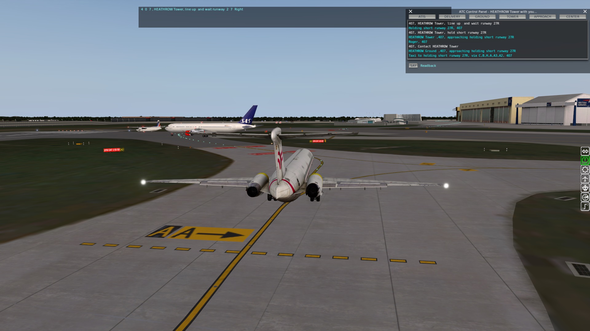

2 Aircraft in front of me at hold.
I get clearance before them.
Pic attached.
