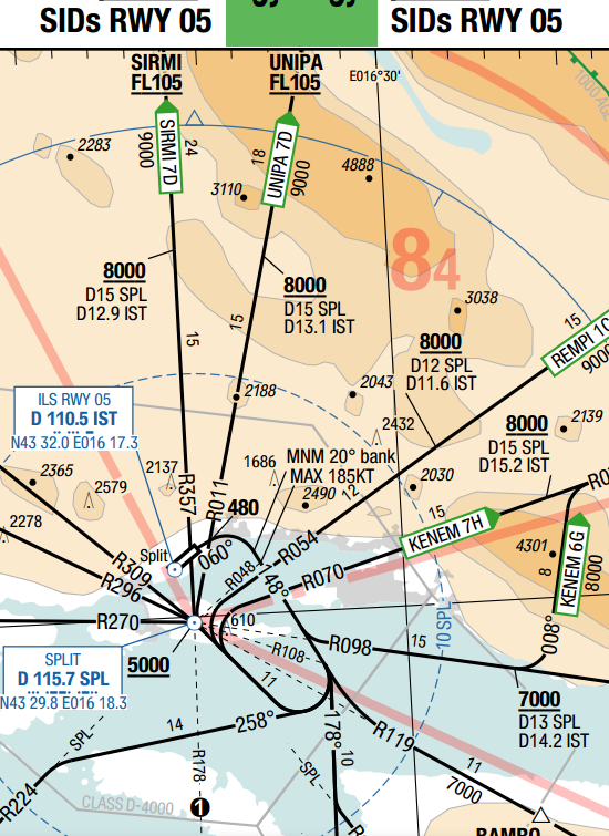

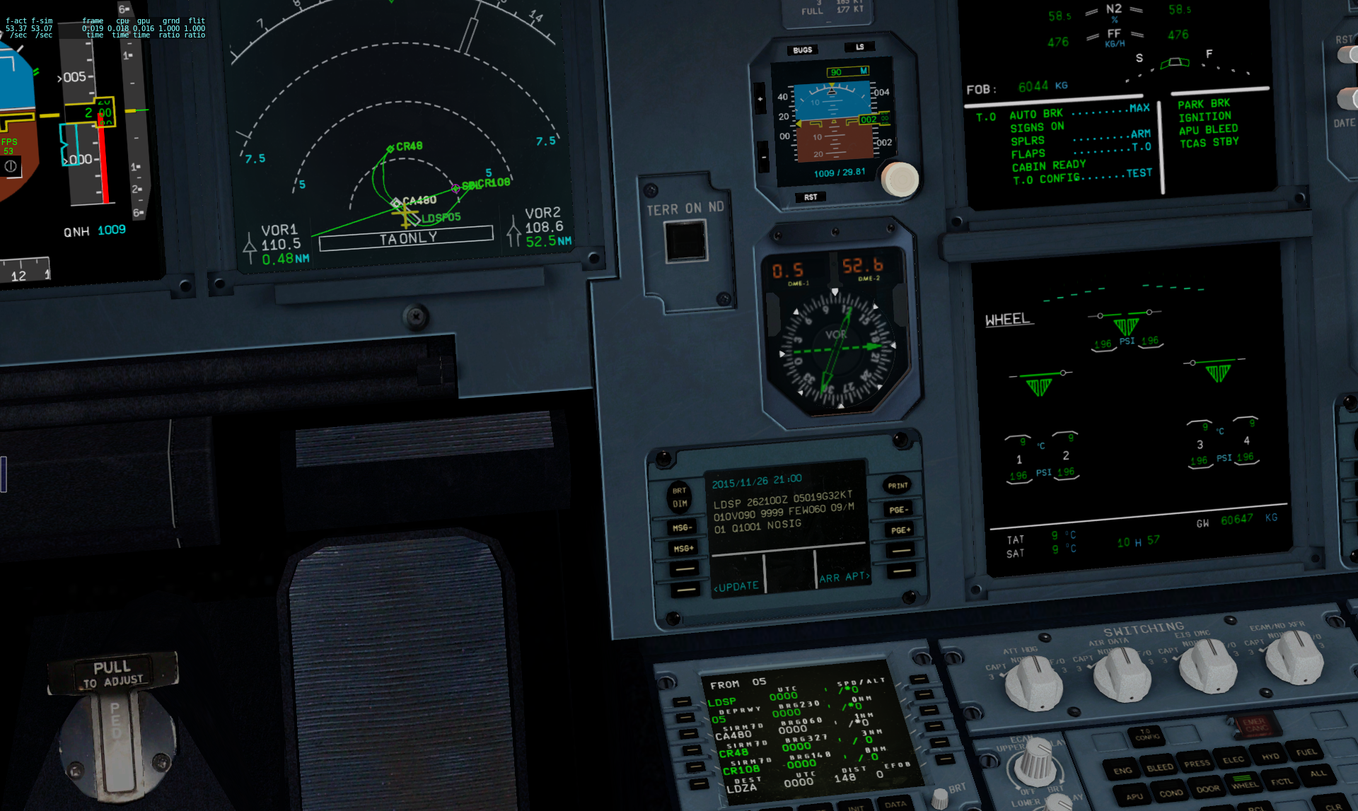

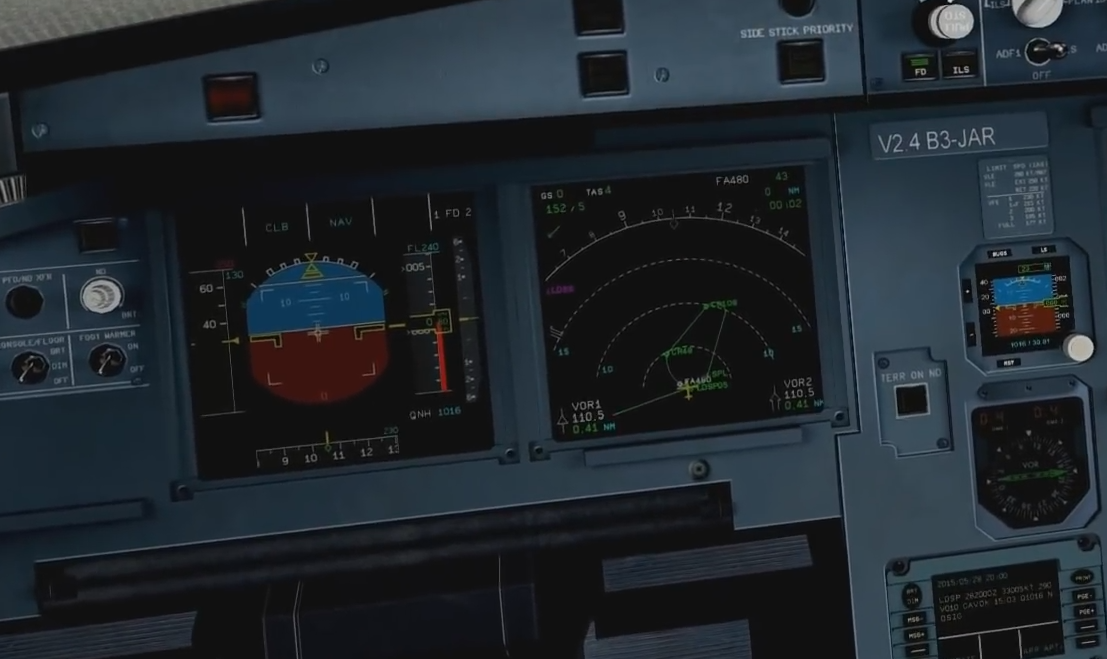

ivota wrote:
problem draw SID LDSP look video.
http://www.twitch.tv/ivota_hr/v/27609353
Sorry, i need just
1.Screenshot of wrong drawing
2.Picture of true drawing from charts
3.Details
LDSP rwy05 SIRMI7D
picture 1 = old drawing SID jar a320 version 2.4b3
picture 2= chart LDSP SIRMI7D rwy05
picture 3 = SID drawing v2.6b1
picture 4 = BLUE line show correct drawing SID
Re: ver 2.6 beta 1 WIN/MAC 64 bit
ok, good info, fixed for beta 2
