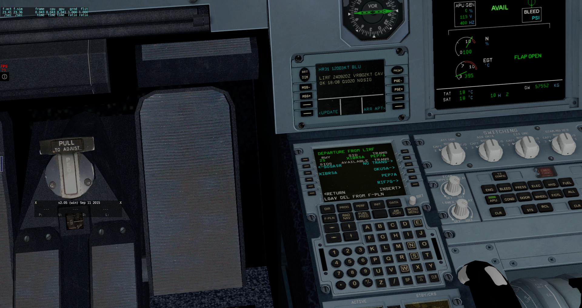

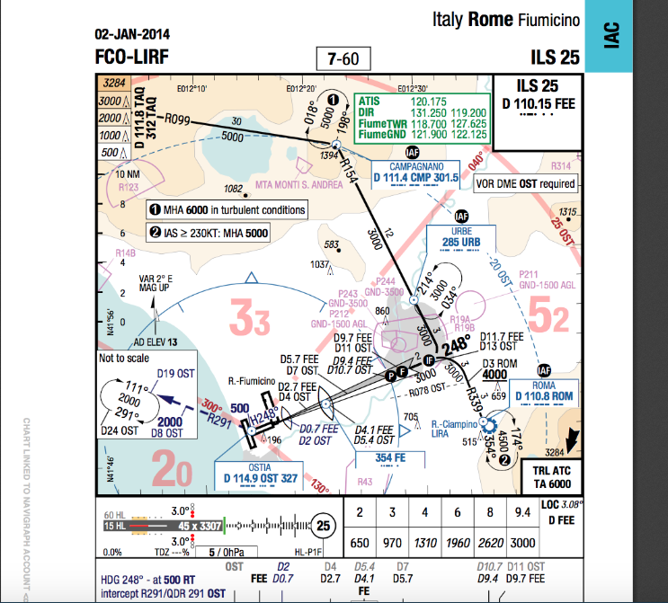

I've tried again the same route (lirf-lgav) from rw25 with sid xibri5A via pep7 (gave from ivao ATC)a but the problem is still present. As  in yout post i've insered the dvd 1. In attach the logs. thanks in advance Davide
i've disabled IVAO (x-ivap), restart PC and try again but the problem is still present. I send again the logs and a screenshot with error. (the FP  LIML/LIRN was from other user with same problem)

K, I added the LGAV STARs first and now I am working out the take off plan ... the JPG is Navigraph's SID chart of LIRF..
25R SIDS SOSA5A no trans.. and now I have a workable Flight plan...
the issue is resolved ....

Hi captbullet
