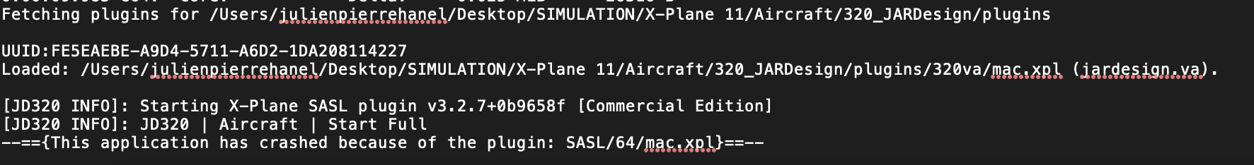

Hello, I downloaded the last version (3.8), impossible for me to open A320 flight with xplane 11.55r2, xplane crash when the aircraft charge, SASL problem in my log txt. A320 charge in the first time, after SASL plugin crash xplane when I reload the plane, same thing with basic scenes
Mac OS catalina (I followed your procedure about xpl file)
Xplane 11.55 r2
A320 V3.8
Attachment icon Capture d’écran 2021-12-10 à 20.10.34.png 72.3 kb, 69 downloads since 2021-12-10

JD320/330 should work well under Catalina/BigSur. Please redownload JD320/330 and reinstall it from:
http://jardesign.org/forum/viewforum.php?id=44
Next, please follow this instruction:
http://jardesign.org/forum/viewtopic.ph … 793#p31793
If no luck - you can contact me via skype j.a.romanov for direct help - we will check this issue online. You may call anytime when my skype label is green.
