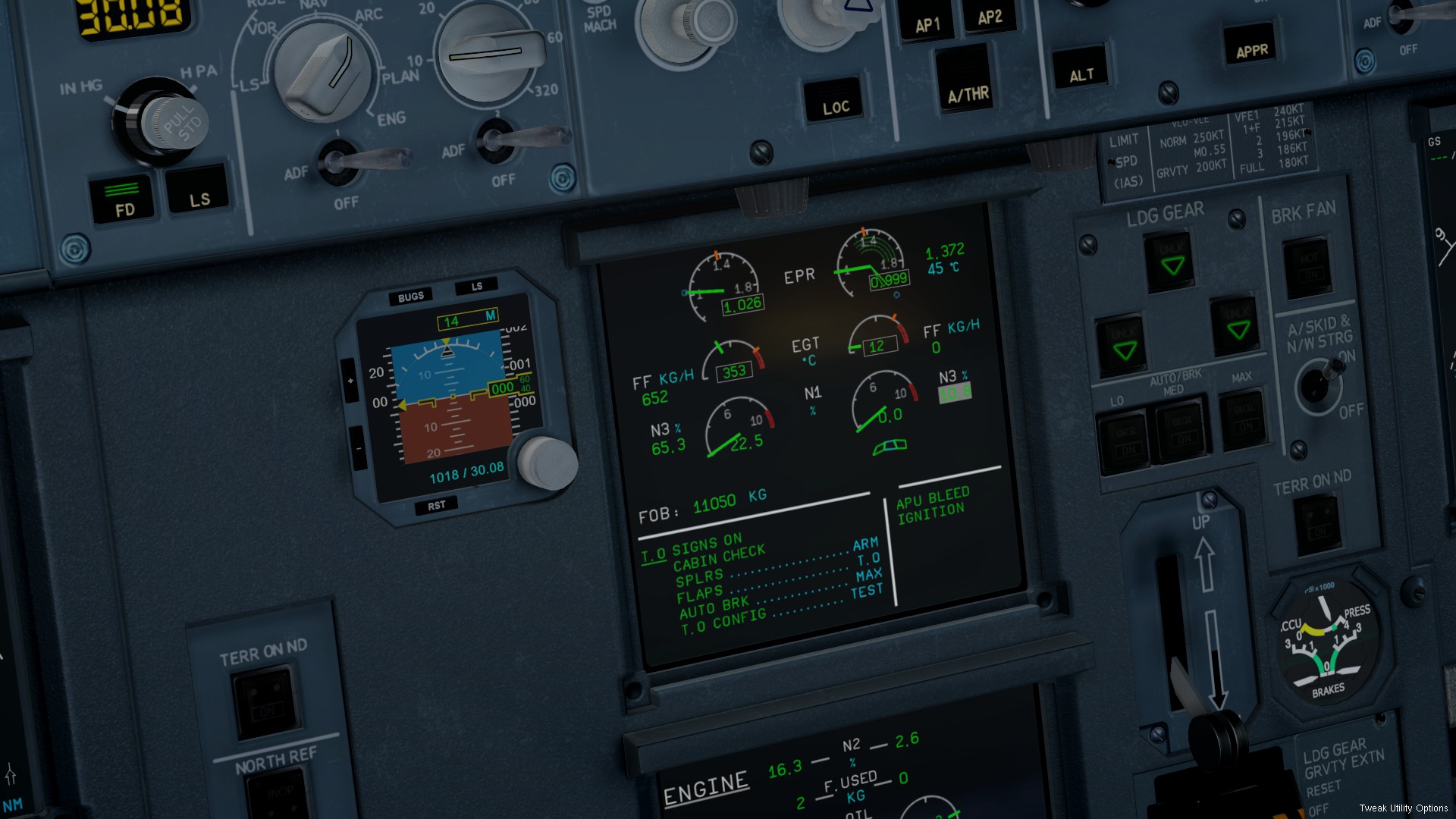

The autothrottle seems fixed, the fuel flows fluctuate rapidly at cruise but it does maintain fuel. more importantly on start up I have the following on both engines during start https://steamuserimages-a.akamaihd.net/ugc/766110385442724119/500D8CFC95F4FBC6C7C32EE6B669021926E4EB8F/
edit: the copilot also seems to get stuck in a loop much easier now as well.

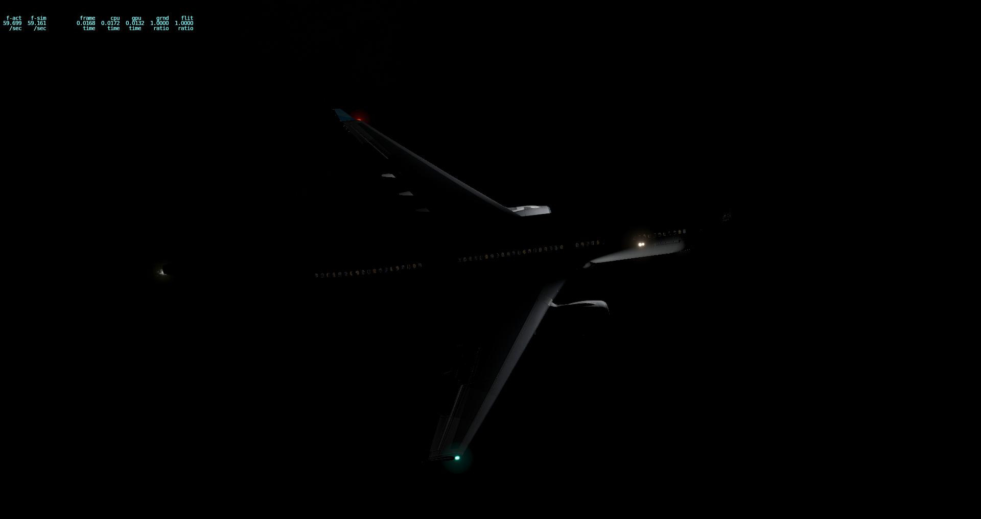

Hi there,
the LOGO lights do not work in any setting.
Is this a program bug?
The A330 is V3.3r2.
JD A320
JD A330
Re: XP11.41 JD330 v.3.3 r1, r2, r..
Are you flying of standing on ground?
Because the Logo Lights of an Airbus are only on in certain conditions.
That are:
Nav Light Switch set to Pos 1 or 2 and gear compressed or flaps extended to more than 15 degresss.
Hello Homer,
thank you for the fast answer.
The A330 was in flight and I tested it again, your answer is correct. Thanks again.
