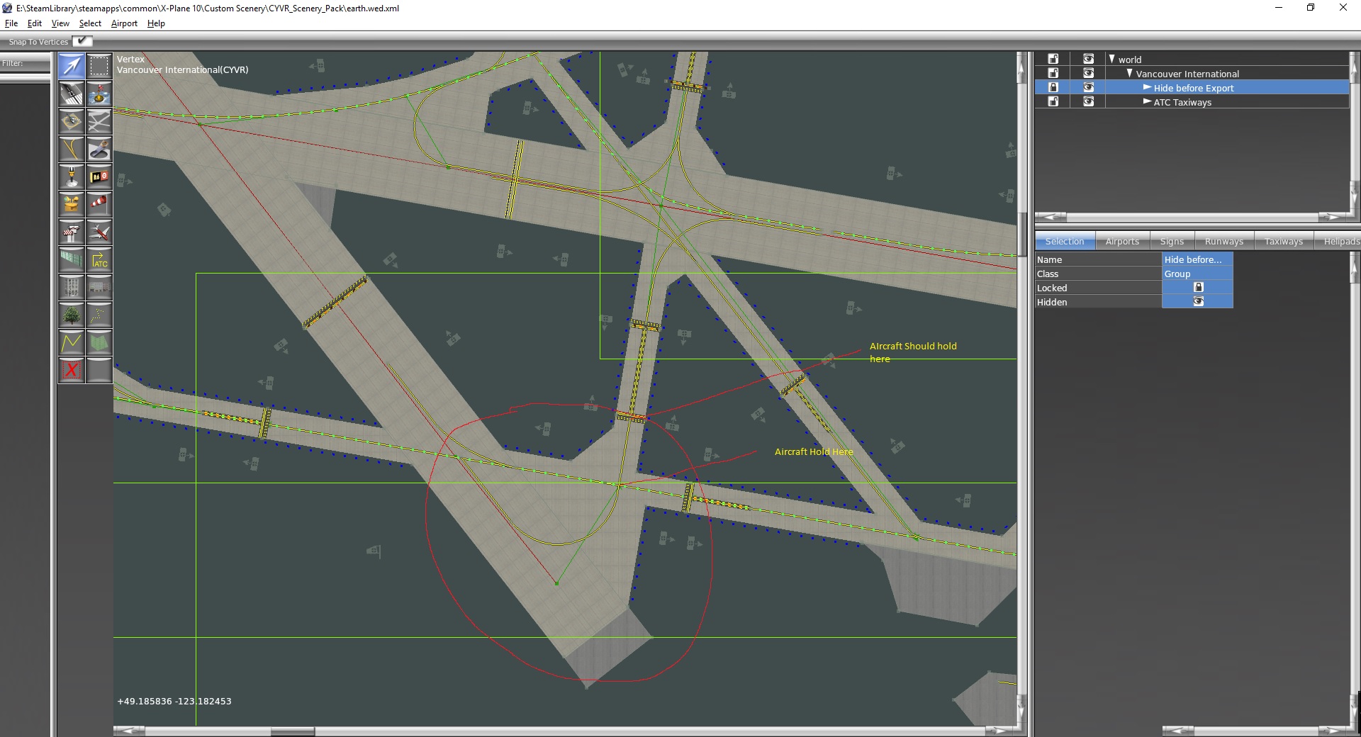

I have run into a bug (feature) doing CYVR. Runway 31 is crossed by a taxiway leading to 08R. I am trying to get the A/C to stop on the hold point , unfort because taxiway crosses the runway and I need the taxiway line the next line after the hold point is the taxiway line leading to 08R.
Is there a way to designate a point as a hold point.

Post a screen from WED please

@work, will do when I get home.

Here is the problem I am having.
