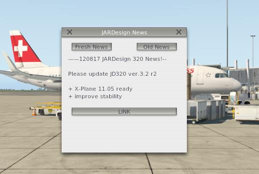

In the news of the A320neo is indicated: please update JD320 ver. 3.2 r2
The link always refers to version 3.2. r1
119
Re: JD320 Airliner ver 3.2 r1,r2 WIN/MAC 64 bit (X-Plane 11)
I'm starting to think that r1 is the latest version and that reference to r2 was just a typo
