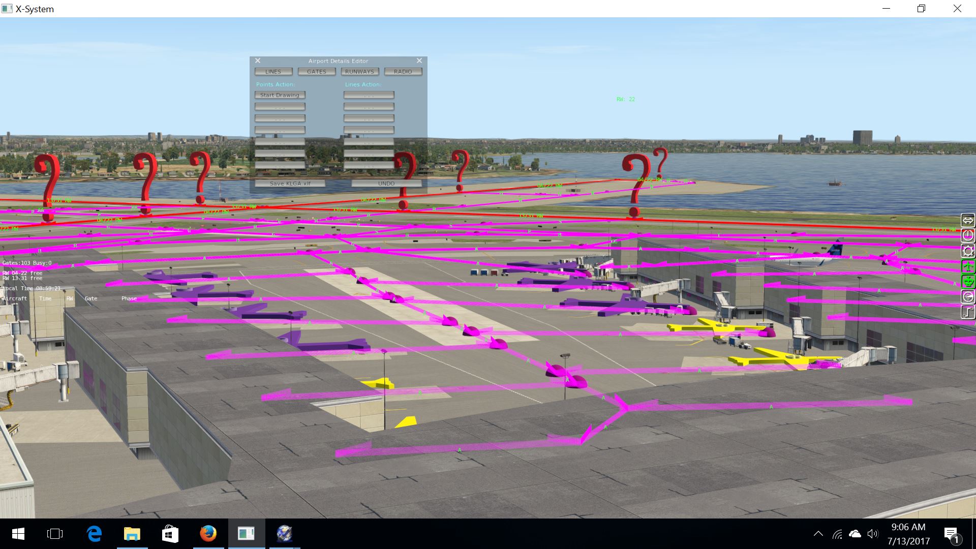

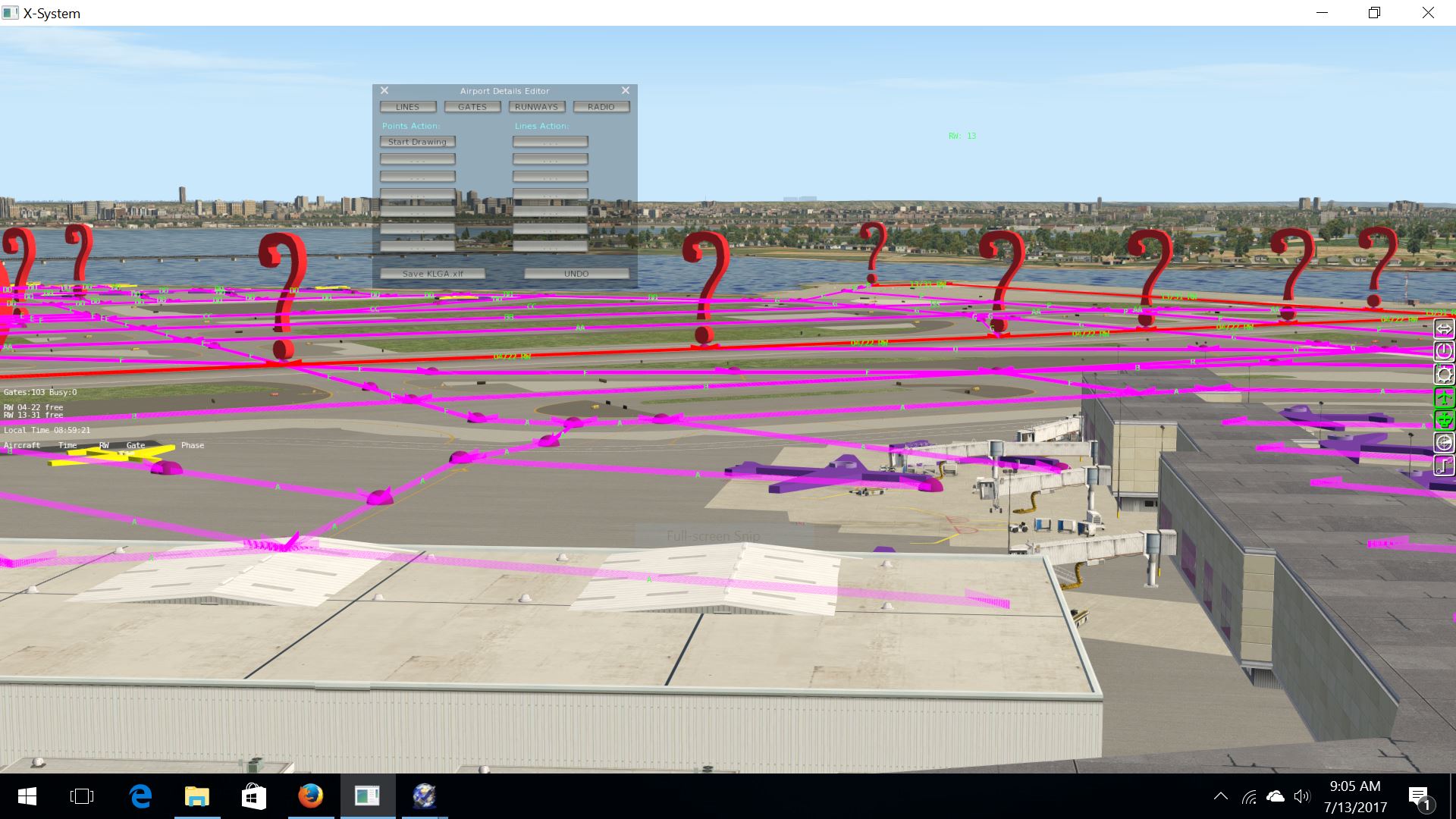

If KLGA is a verified airport to use for X-Life and included with airports why so many ?????? Images are from what was included in latest version 2 rc1. At least now we have another way to make edits and corrections with airport editor and WED if we choose. Thanks JAR
