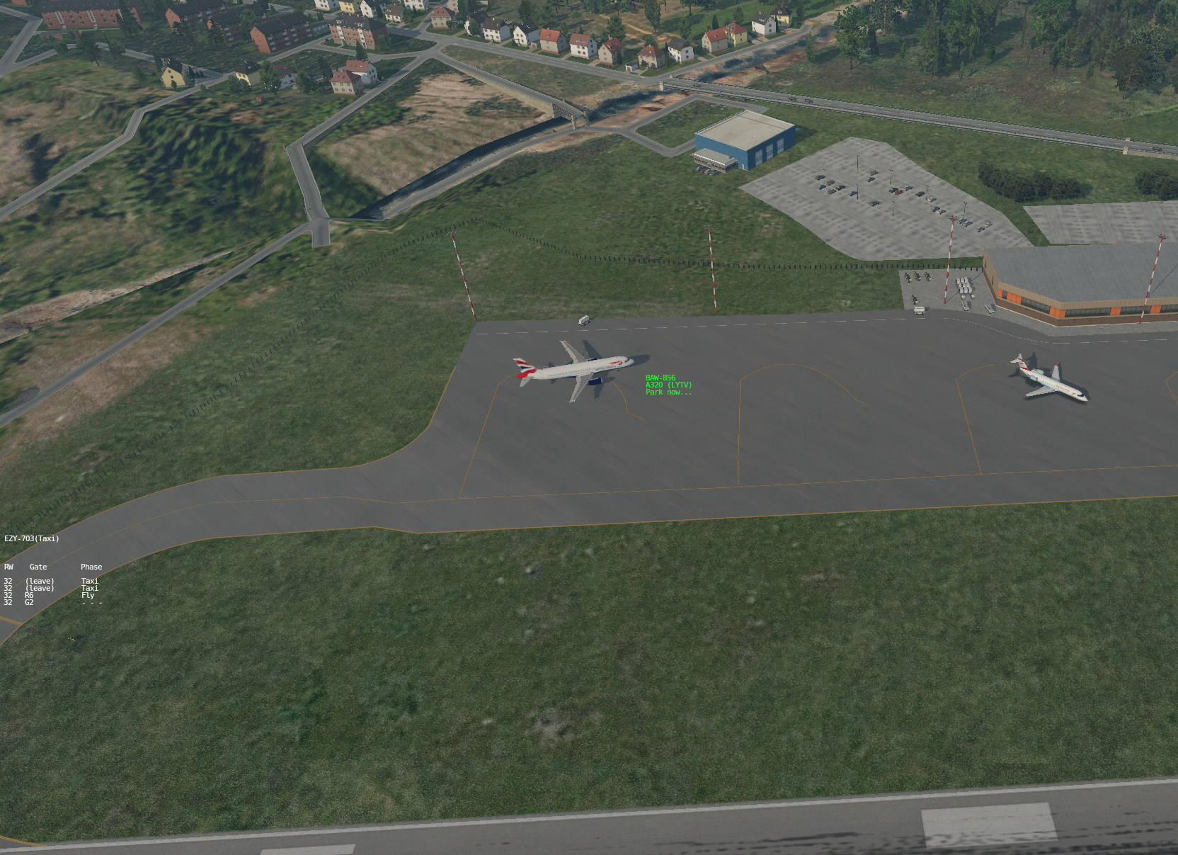

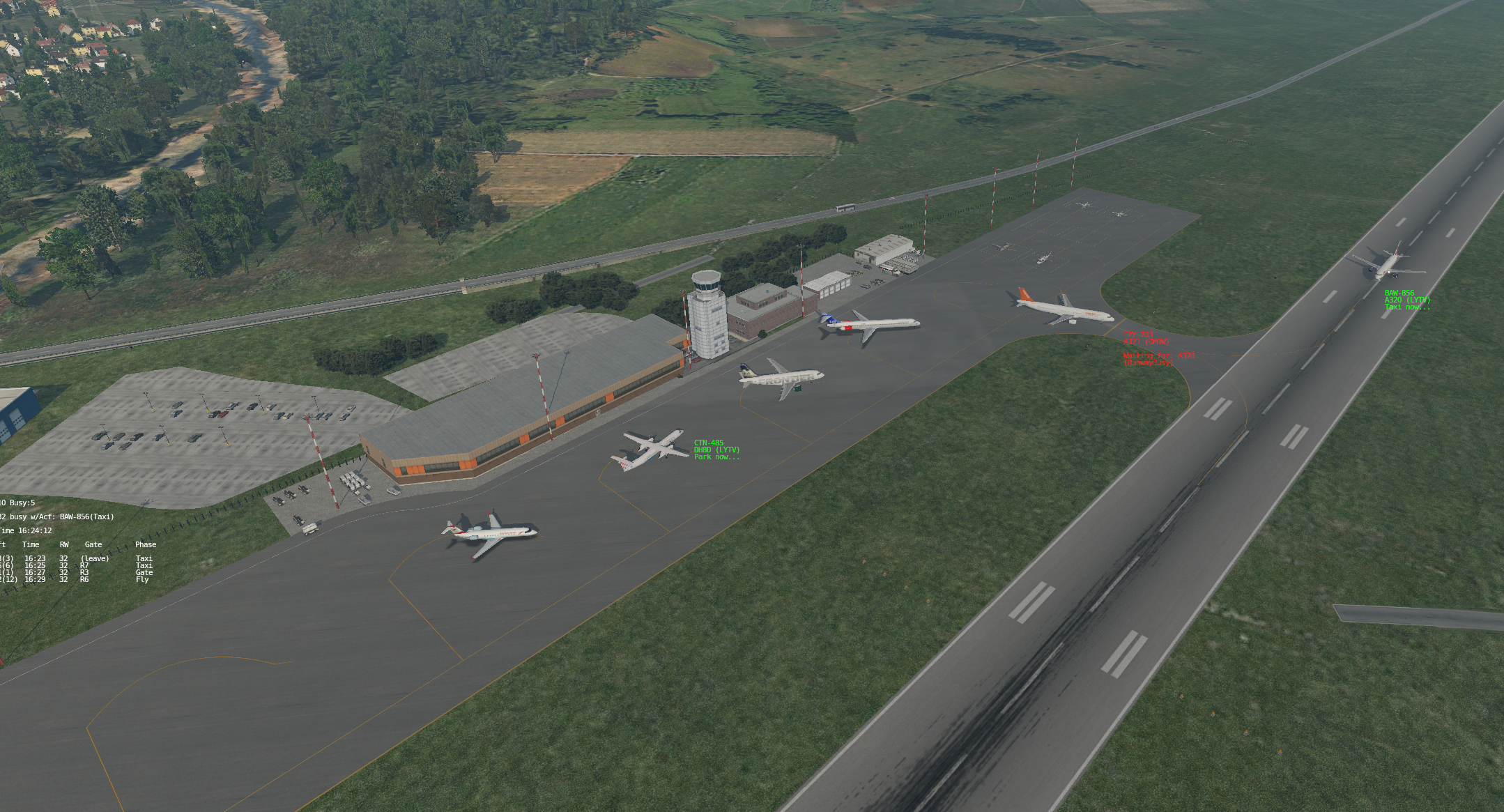

I'm trying to build custom ATC taxi routes for LYTV Airport based on this scenery package https://gateway.x-plane.com/scenery/page/LYTV
I managed to make it work for RW32 departures and landings.
However departures and landing on RW14 doesn't work. The traffic pops up on parking ramps but nothing happens aftewards: no landings, no departures... nothing.
I have also a question regarding the aircraft parking position at arrival, for some reason they are not in the required position (taxi in / taxi out) although at the init of the scenery they are...
