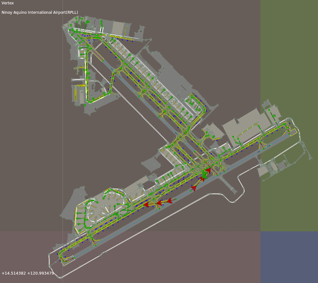

I created a working taxi route for use with x-life for Manila International Airport (RPLL). Can you please verify and add it to x-life if approved?
Link to scenery file:
http://forums.x-plane.org/index.php?/fi … l-airport/
Kind regards,
Mark
P.S
Updated dat file to remove unknown taxi route N between G4 and J (April 16, 2017 6:oo PM MNL Std Time)

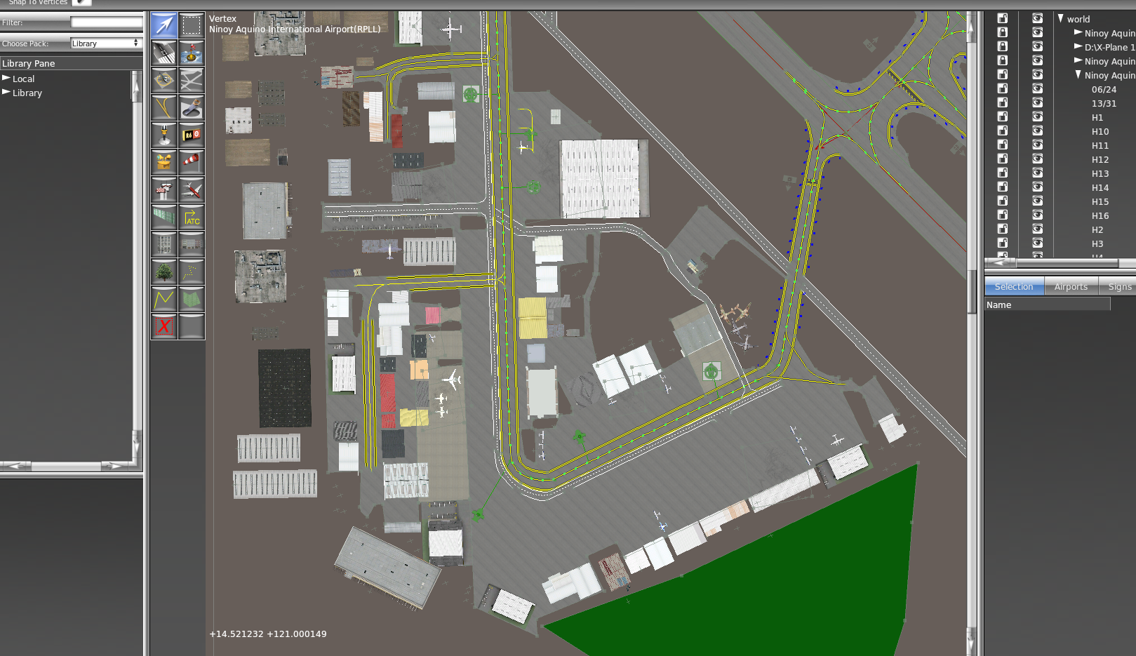

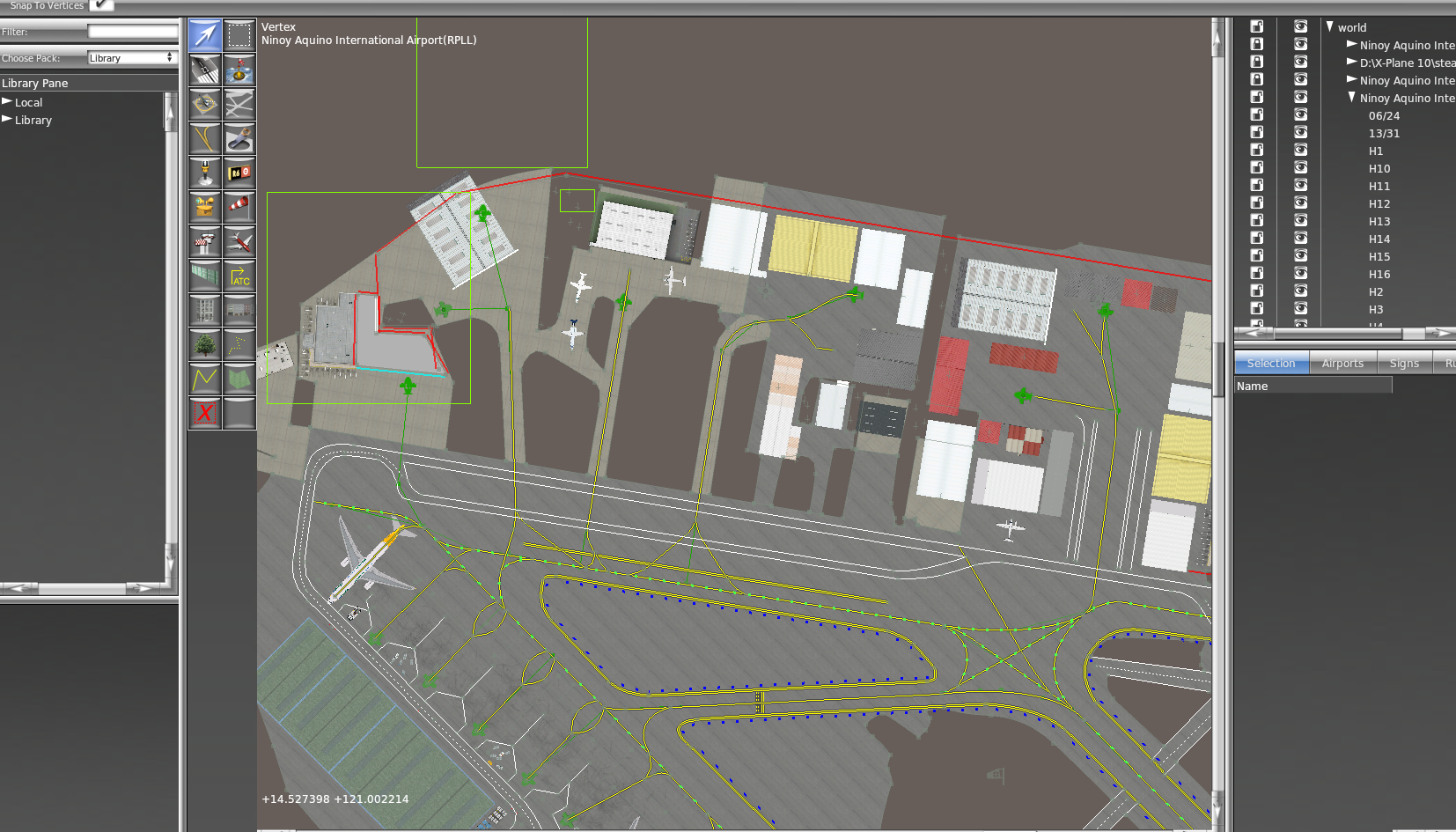

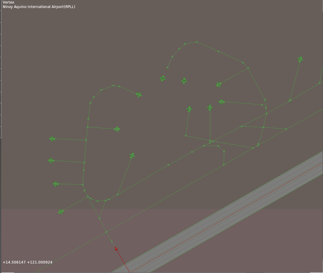

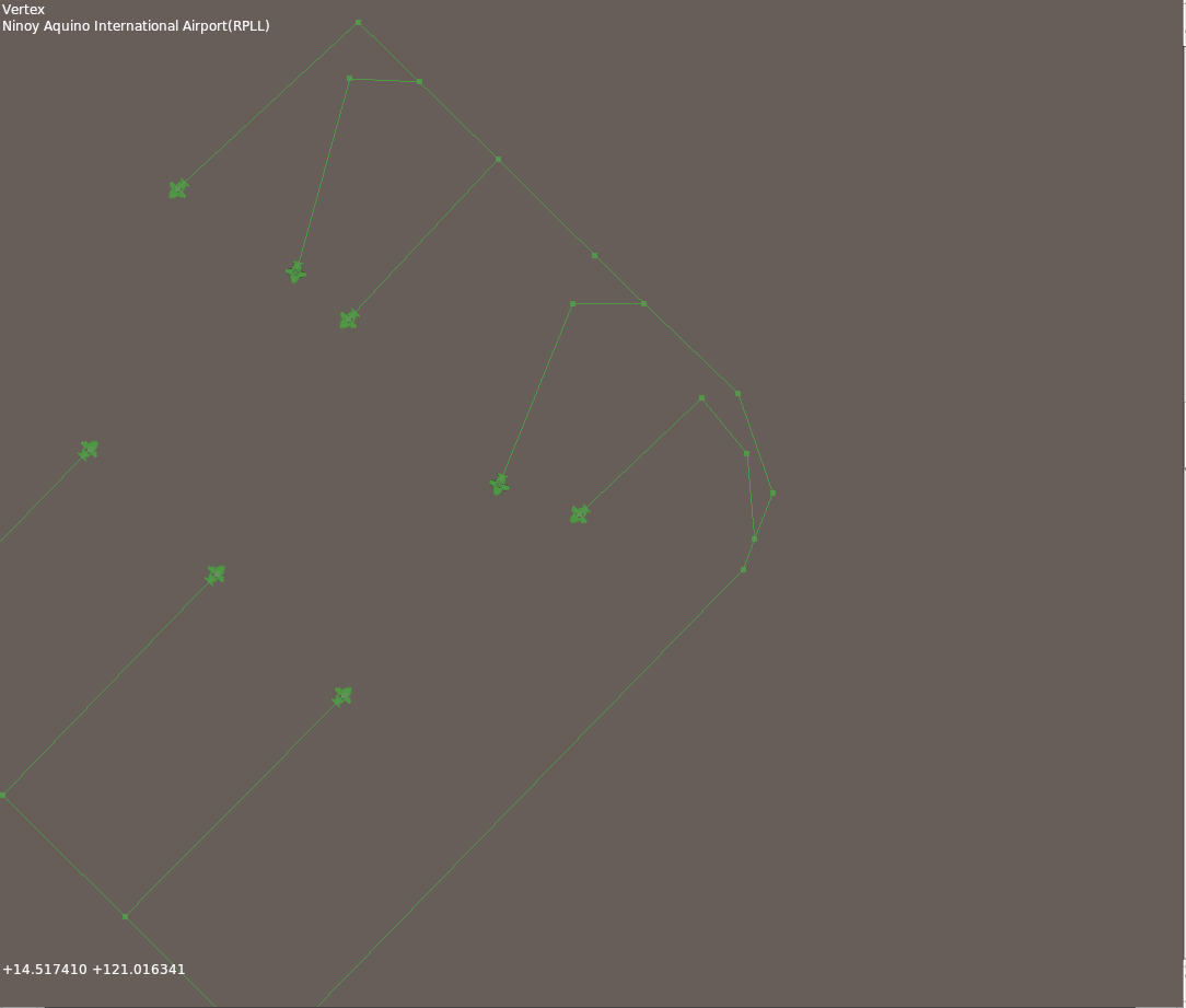

This ATC-taxitoutes have a lot of wrong. Better - if you look at typical wrong practice places to understand what wrong and what is true way http://jardesign.org/forum/viewtopic.php?id=1941
