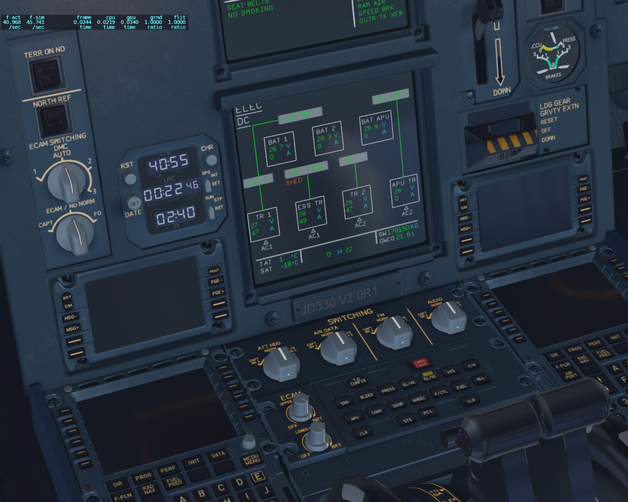

when I was decreasing flight level and prepared for  land I faced to switch off the ND and MCDU , how can I fix this issue in flight? or I should restart x-plane?
XP11
Windows 10
Ali
http://jardesign.org/forum/img/m/3067/t/p1bdtcpbk8ieu1tbt1hk41218vfj3.png
http://jardesign.org/forum/img/m/3067/t/p1bdtcpbk91f4ql0f1nskbll1im94.png
http://jardesign.org/forum/img/m/3067/t/p1bdtcpbk9giv1j5c2hdd8da2g5.png
