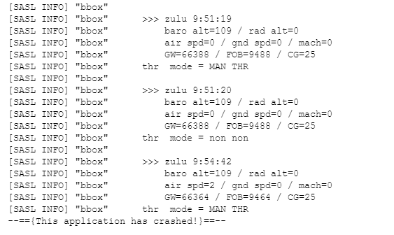

Here's my log from one of the flights with Jar320 that ended with a crash while taxiing for take-off.
Exactly the same "last words": SASL reporting something about thrust mode. Interesting coincidence!
http://jardesign.org/forum/img/m/4188/t/p1bdckc0abvh61boqbqpdthk3e3.png
I'm not trying to be smartass here (well, if only just a little), but I don't think XP logger could always pinpoint crashes down to the details like "hey, looks like module A of aircraft B doing thing C instead of a D, so I'm gonna report this and then crash".

The main way to explain bug or crash - reproduce it under debugger software. Log is mostly unuseful for details. MAC OS crash report - some better way for this - we can read what function produce crash.

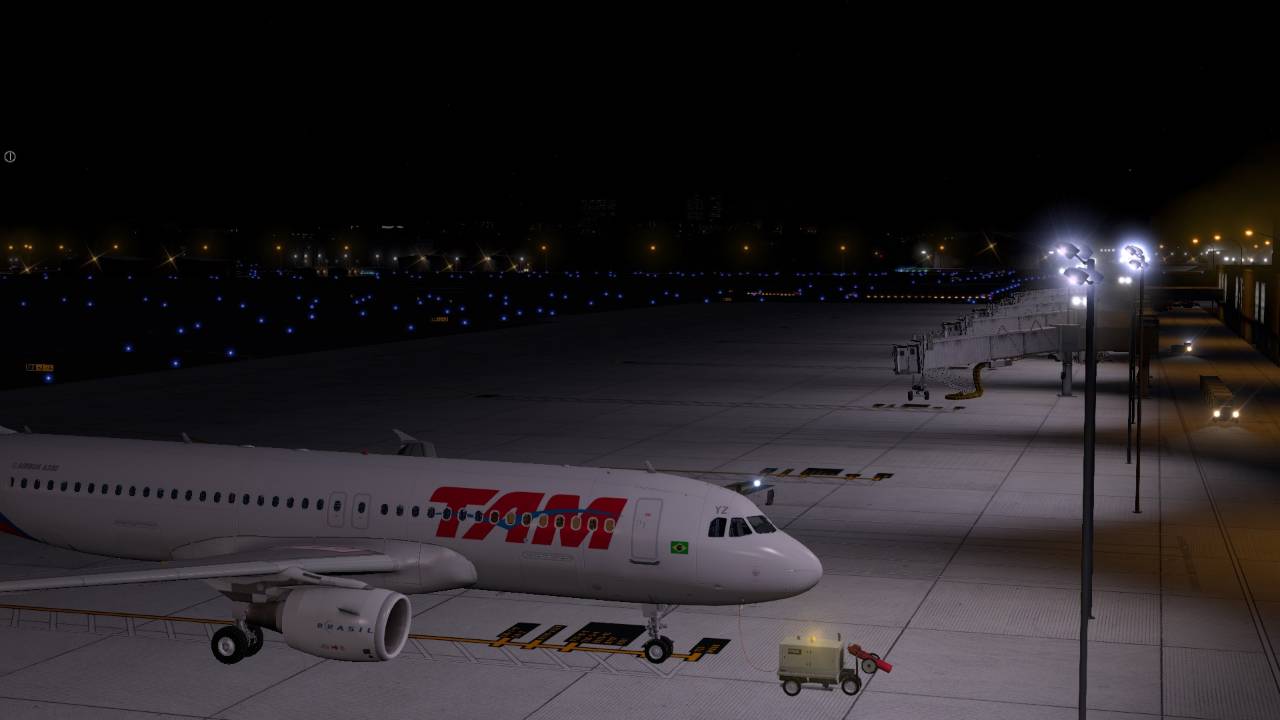

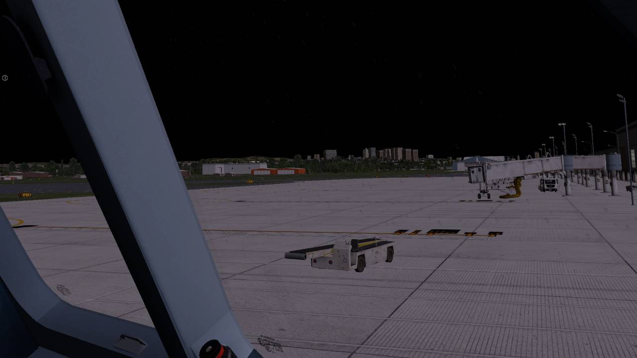

I found a bug regarding glass transparency + HDR:
Here is what it should look:
http://jardesign.org/forum/img/m/4387/t/p1bdd6puuq22vp87fene5k1g6ke.jpg
And here is what is rendered behind the cockpit glass, everything is lit, no light FX (note there is raining, maybe the raindrop is causing that?)
http://jardesign.org/forum/img/m/4387/t/p1bdd6r7p912h4lrg1rao1h8vhv5g.jpg
EDIT: Yeap, I cleared the weather and everything is ok now. The raindrop effect in the windows is causing that problem. How can I turn it of while not fixed?

To solve this issue i just build new pack. This version posted as release 4 and include only 1 additional function - for this pack, you can use MCDU MENU to turn Off rain from windows (look at Page 3, please)
