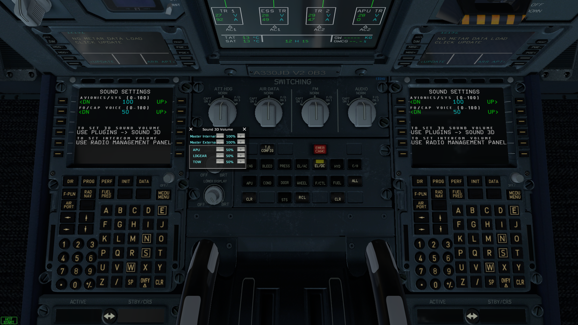

166 (edited by Fregatidae 2017-01-17 12:47:45)
BSS Soundpack not working
X-Plane 11 pb6, A330 v2.0b3, BSS A330 RR V2.01
Symptoms:
No engine sounds, no air pack sounds, no button/lever clicking sounds.
APU, FO voice and aircraft alarm & alert sounds still work (audible when changing sound levels in MCDU menu)
Please help, thanks.
Symptoms:
The problem is BSS use some datarefs in their config files wich not exist yet in XP11.
So...
Open folder: BSS/custom/cockpit
edit the sound.cfg with a text editor
On first line,
you have: mastervolume_dataref=sim/custom/xap/snd/coc_vol_01
Replace with: mastervolume_name=COCKPIT
BSS/custom/engines
Replace with: mastervolume_name=ENGINE
BSS/custom/flctrl
Replace with: mastervolume_name=FLCTRL
BSS/custom/gpu
Replace with: mastervolume_name=GPU
Others folders are good.
Now you can copy custom folder in: 330_JARDesign v2.0b3\plugins\sound3d\
You will have all the faders in sound menu for set the a330
Adjust volume like you want
