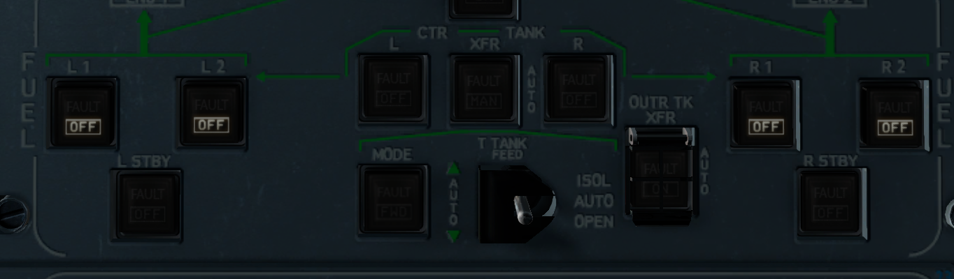

Hello
another bug
I can start both engines with fuel pumps OFF
OSX Sierra
XP11 b5
A330 b2

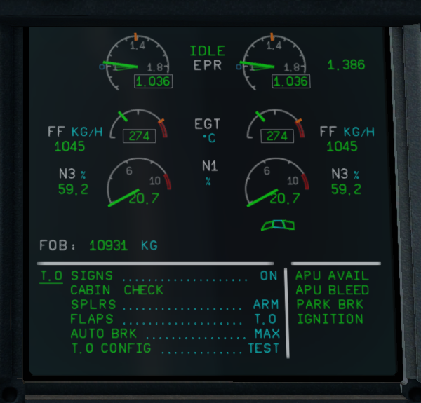

I find 2 bugs,
1- The fuel does not reduce from 10931 kg
2- Both Engines does not off.
X-plane 11B6
A330 B2

Hi, I have done 3 full IFR flights now in the B2 version.
1. I think this is a known bug - the FOB countdown stops at 10,931 KG and doesn't reduce further.
2. After is stops counting down the engines can "Oscillate"with blue needles and the FF figures are erratic (up and down)
3. The aircraft has a tendency to go over-speed during descent even when I start descent early.
Otherwise great - please keep up the bug fixes!
142
May be you just have StandBy pumps left and right On.

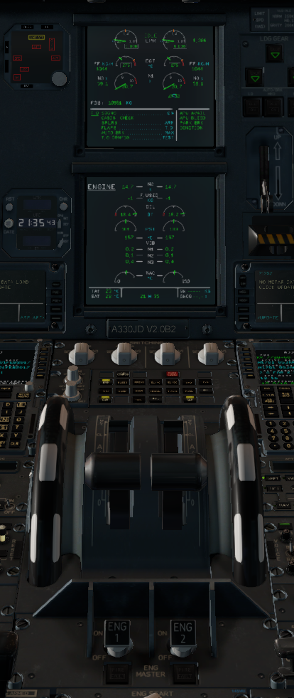

143 (edited by kebs 2017-01-15 21:42:38)
I should  prefer a simple mistake like that, but not, alas.
Also impossible to shutdown engines
no more problems of reverse since last X11 update.
Attachment icon Capture d’écran 2017-01-15 à 22.30.22.png 449.87 kb, 124 downloads since 2017-01-15
Attachment icon Capture d’écran 2017-01-15 à 22.32.25.png 241.8 kb, 133 downloads since 2017-01-15
Attachment icon Capture d’écran 2017-01-15 à 22.35.32.png 500.48 kb, 169 downloads since 2017-01-15
