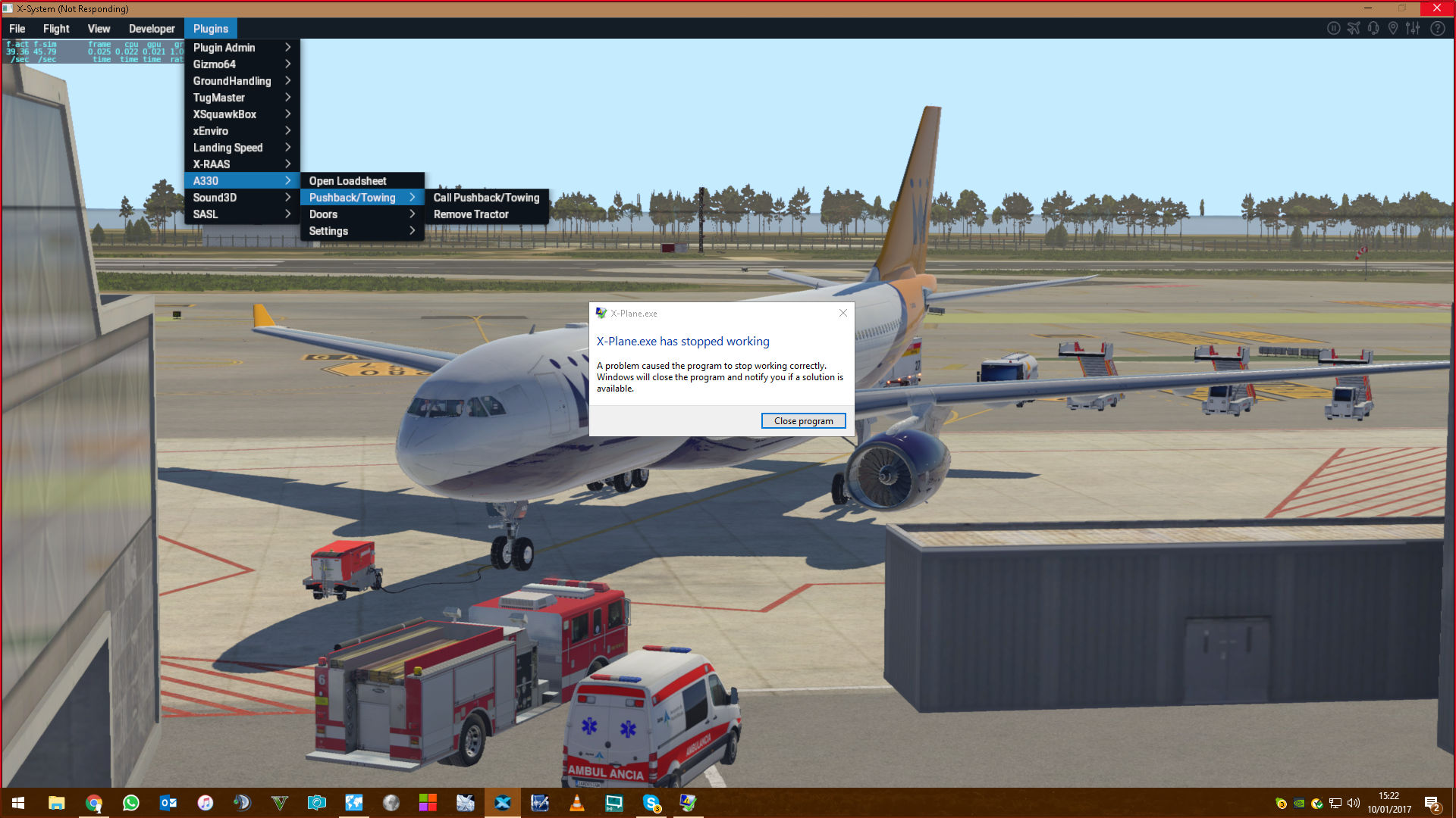

A330-200Beta 2 , when selecting pushback truck , we had a Crash to Desktop , Image and Log included.
X-Plane musn't crash, but... You can't call pushback if the GPU is connected.
