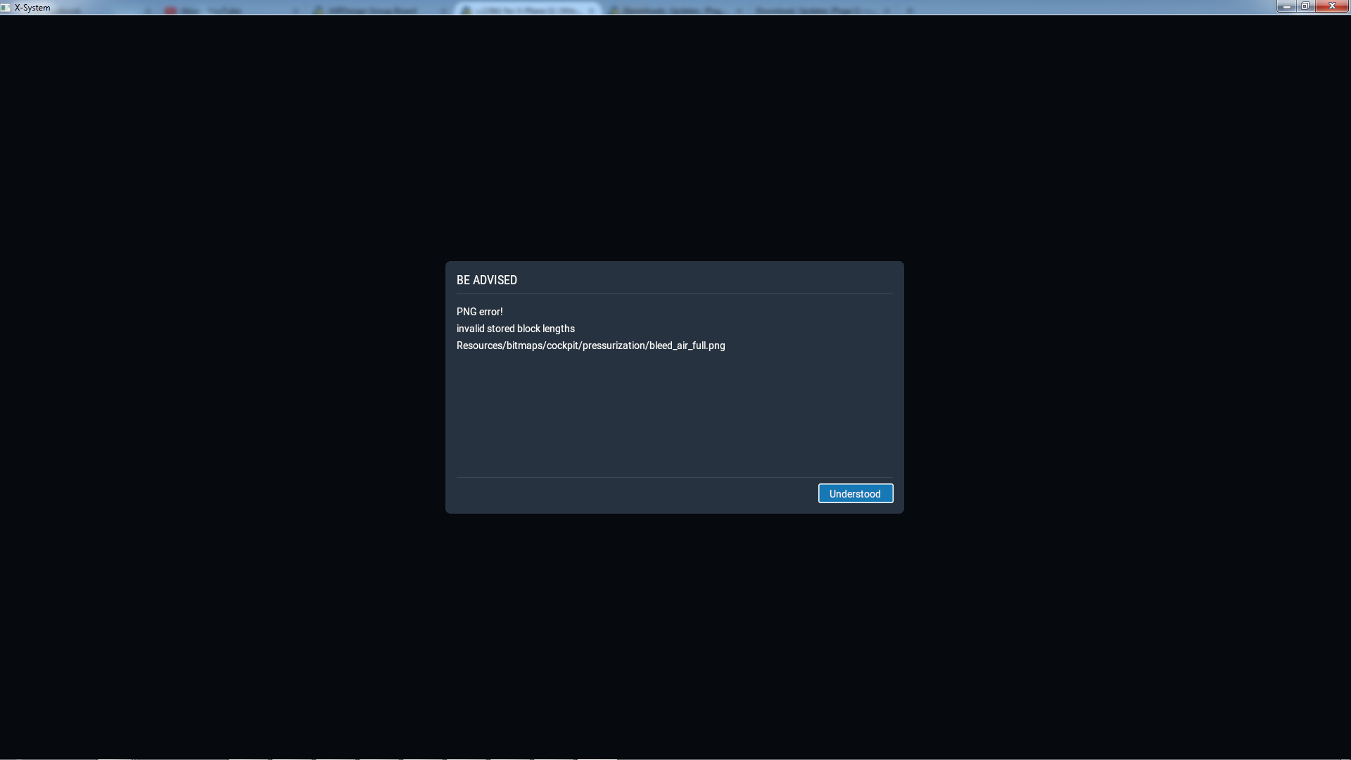

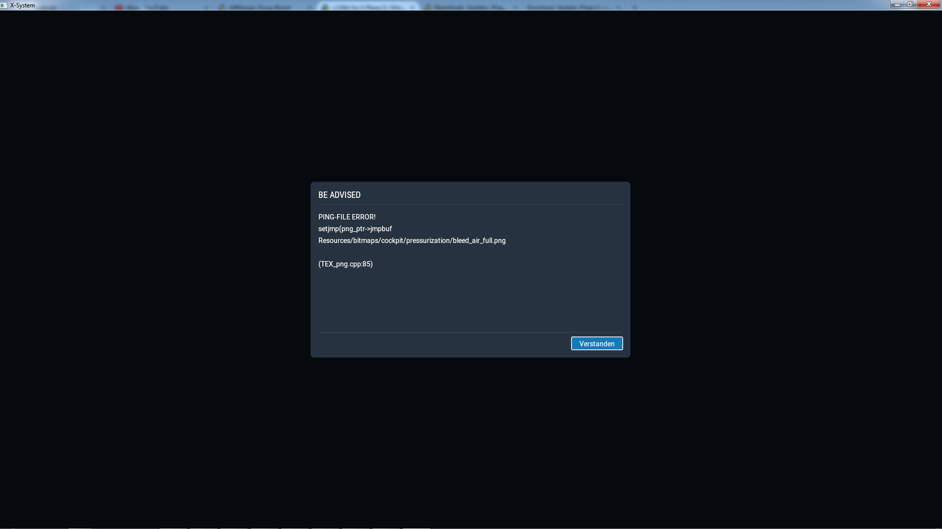

83 (edited by lukascaptain 2017-01-09 10:19:19)
Hey smile
I downloaded this beta for using it in XP11.
When loading first time the 330, these two messages occured. Has anyone an idea how to fix?
Thank you smile

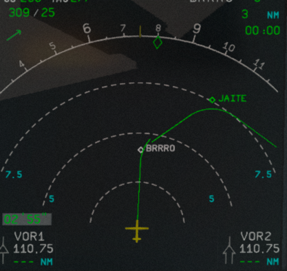

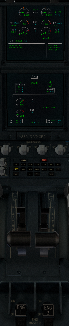

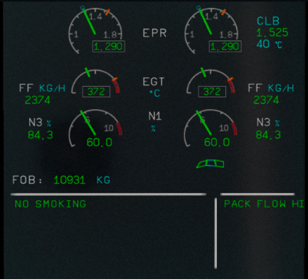

91 (edited by laohu314 2017-01-09 18:59:05)
Test flight with latest beta, X-Life, SMP4, RWC1.1, X-RAAS
1.) Still issue with PATSS DCT NELIE (no idea why). used it anyways, works in A330 not in XL
2.) No TOC, no TOD on FMC nor ND
3.) FOB doesn't count down (see screenshot)
4.) Flight path discontinuities (on turns) on ND (screen shot)
5.) Engines still do not shut down (screenshot)
6.) Liveries not showing - just get "House" Livery EDIT: on reload, liveries show!
Disregard sound errors, I installed BSS in flight (I know, not a good idea...)
