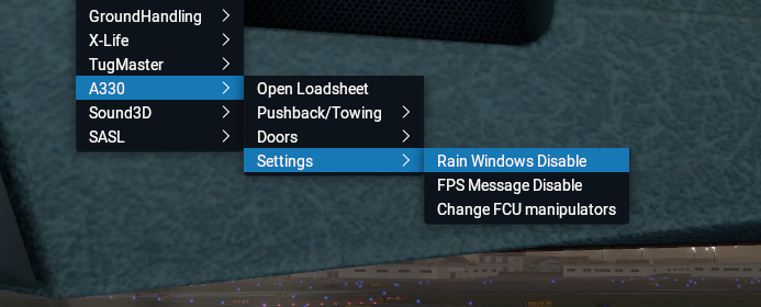

I have the same issue as Havena
this is what im getting https://gyazo.com/afa6862f48e382685197b37d8b6eefd3
I may be mistaken but there is not a beta out for the A330 on XP B12 - only for the A320
I got the same strange colors ... but I restarted X-Plane and reloaded the A330 and everything went nicely ...
when you have this issue, just choose rain windows disable un A330 settings
staffguy1 wrote:
this is what im getting https://gyazo.com/afa6862f48e382685197b37d8b6eefd3when you have this issue, just choose rain windows disable un A330 settings
ok will try that
ok will try that
The advice will help but you won't get rain effect. This occurrence is related to the screen resolution.....
